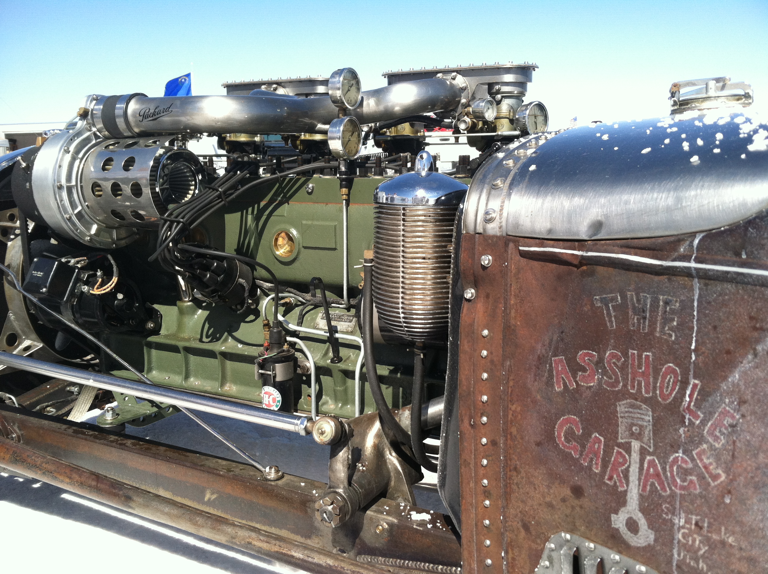

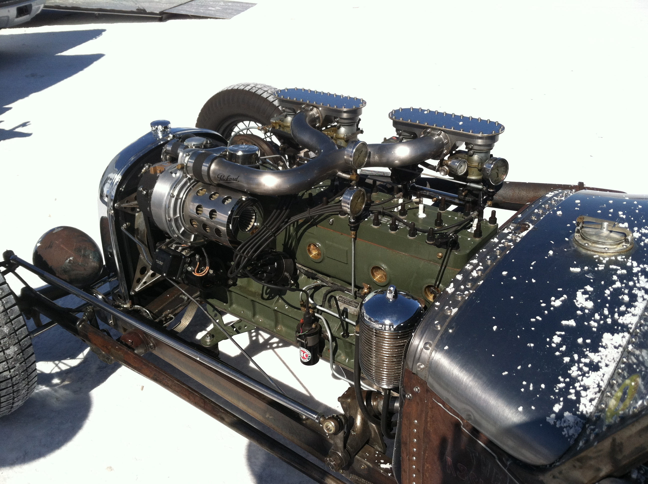

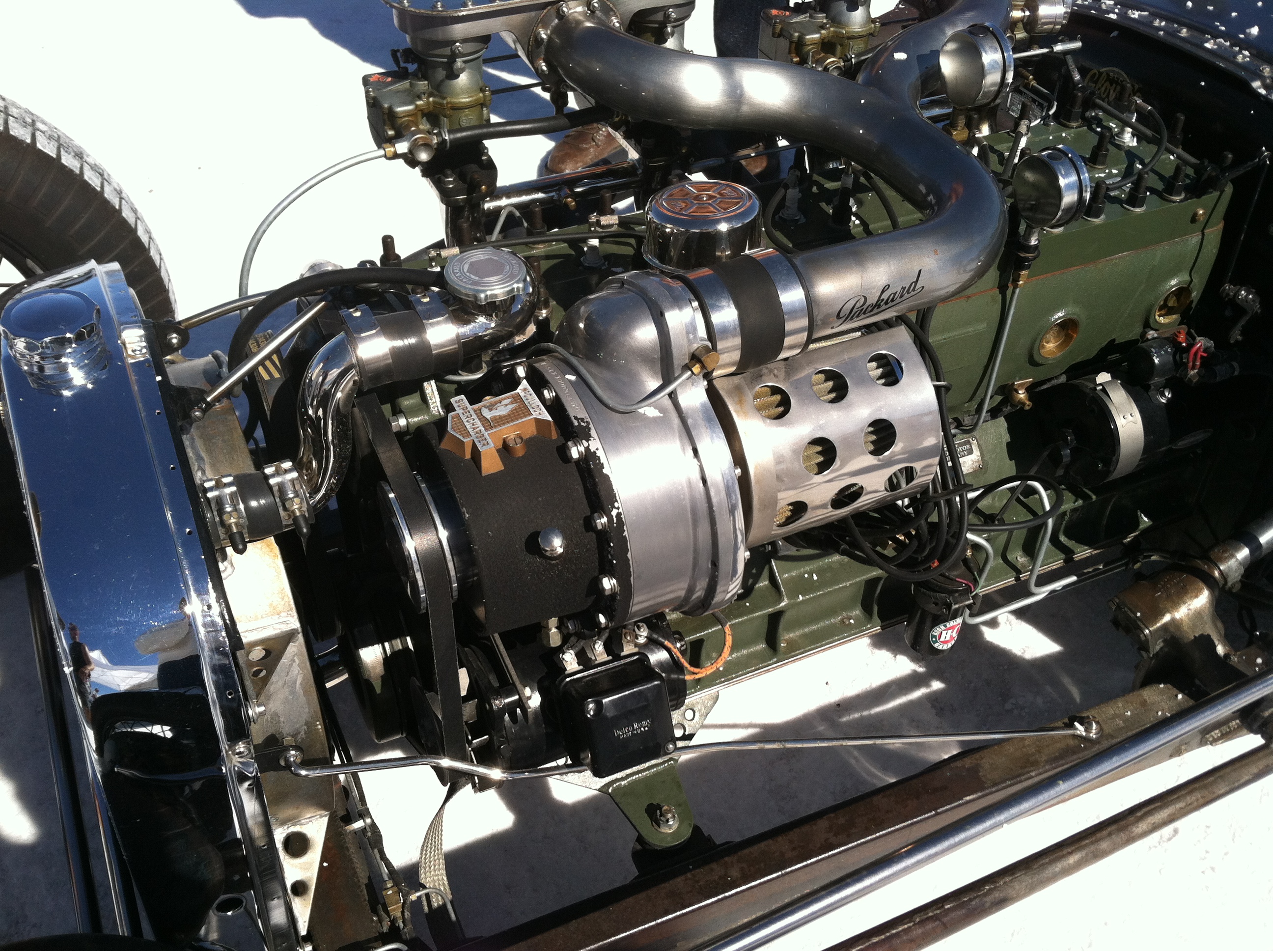

Don't know if this we'll help, saw this at Speed Week a couple of years ago. Sitting on a Packard 80
McCulloch/Paxton superchargers were put on just about everything. If you have not checked you should look up info on these, there is a lot out there. A California outfit called "paradise Wheels" offers rebuilding kits and other information. I have never heard of a Hudson bracket produced by McCulloch but I have a friend who built a ground-up system on a 331 Cadillac. There are things you need, like a correct 7" "fat" pulley to both accommodate the special belt and attain the correct rpm ratio. It would seem to me the best way to go is to find a complete '54 Kaiser unit. Kaiser put these blowers on their flat six's in 1954 (only). I think the Kaiser Carter WCD and it's chamber would bolt directly to a single carb. Hudson intake. The Hudson WGD and the WCD have the same four bolt base. Probably would also work on a twin-H setup but you would need to find another WCD. I've seen these carbs and rebuilding kits on Ebay. Packard put these blowers on the Panther, but only 3(?) were built and I've never seen an engine bay of a Panther (e.g. did they use a four barrel or a two barrel).
