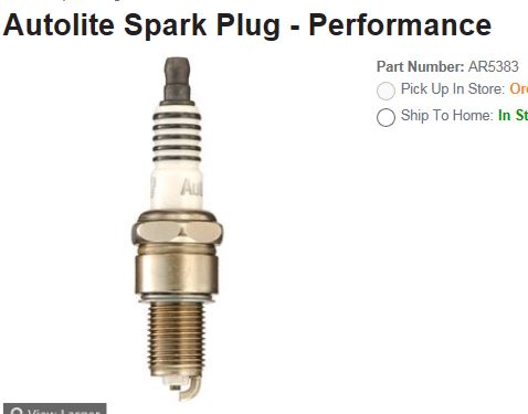

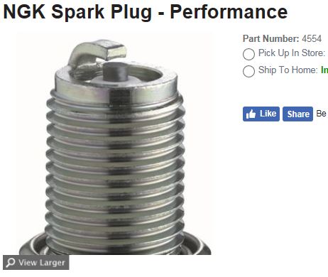

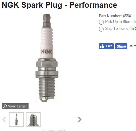

It may be the style of plug selected.
There are standard tips and projected/pwr tips.
Here's a couple of the listed performance plugs for my 49.
You can see how much difference there is at the tip.
