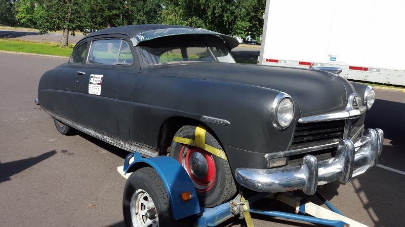

So you are considering towing a car of that weight a long distance without any sort of supplementary brakes on the trailered car? I know when I tow my 1910-1953 cars I am really happy I have them on a trailer that has brakes. These things (late 20s - 50s) are heavy and at 60 MPH if you have to stop or slow down it can be a real challenge. Just from a safety perspective I would not even consider any distance at all without a trailer equipped with brakes. To many crazy people out there that do stupid things in front of you. Then there is going down steep hills....... especially if it waggles a little.....

No need to disassemble the driveshaft and still have the rear gears spinning. Instead, tow it backwards with the rear wheels on a car dolly rented from U-Haul. Tie the steering wheel real tight to the door post. I have towed a full-size car completely across the US that way with no problem.0
As you have I made multiple moves with the military. I did not own a trailer and usually towed my Stepdown with a tow bar. I learned early on to pull the rear driveshaft connection at the rear. I also determined that bolt on chain pull towing did not remain tight. This lead to unstable towing. A friend shared his flat tow bar design that eliminated these problems. It incorporated two used bumper guards to locate and fasten the tow bar to to the Hudson. I had a tow bar made in this design and towing my cars became trouble free. Most of my tows were 1000 miles plus.
On the use of tow dollies: do not use them. The dolly fenders will hit the fenders on a Stepdown. I learned the hard way towing a convertible!

I use the HD 80" dolly. You can get them with or without brakes. Due to the crawl space, I just leave the drive shaft connected. Manual in neutral, OD in free.0
Enough cautionary tales that I think I'll just use my car trailer- have done it before, it works fine. If I had to rent something, I might go with the tow dolly instead. Thanks for all the comments.0
