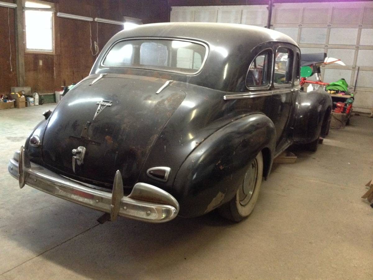

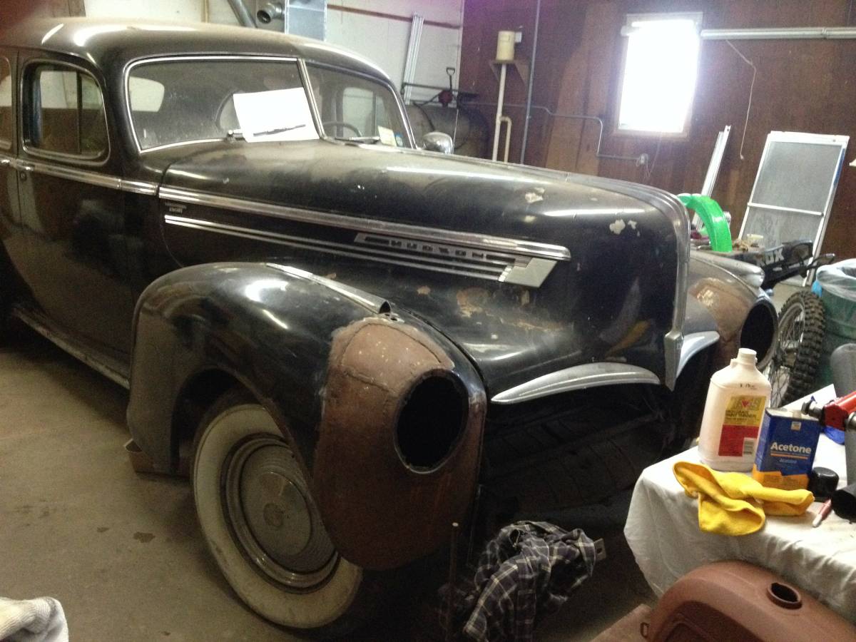

Had a good deal drop in my lap, a 41 Commodore 8. She's been off the road since 2003, upon the passing of her former owner. (Ronald Kishpaugh of Skaneatales/Auburn NY). Anyone familiar with this specific car, or Mr Kishpaugh? I bought it from a local Va guy, customer of mine. He bought it along with a Packard as a package deal, and I guess always meant to get the Hudson in order and never did.
So, the plan so far is this: drop the oil pans, clean sludge. Pull valve doors and fill the splash trays that way. Pull and inspect plugs wires etc, probably do a major tune. Inspect and probably overhaul the brake system, basically run an IRAN on it. Anything I am missing? Also, in looking at the Club Store, I see a 40 shop manual, and a 42-46 shop manual....but no 41. Alex Burr?

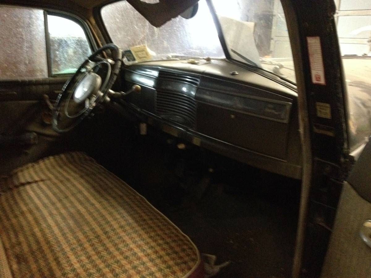

Lastly, she has the big vacuum canister that I always thought was Drive Master, but no switches on dash for HDM. Is this just the auto clutch? Any "gurus" on that system?

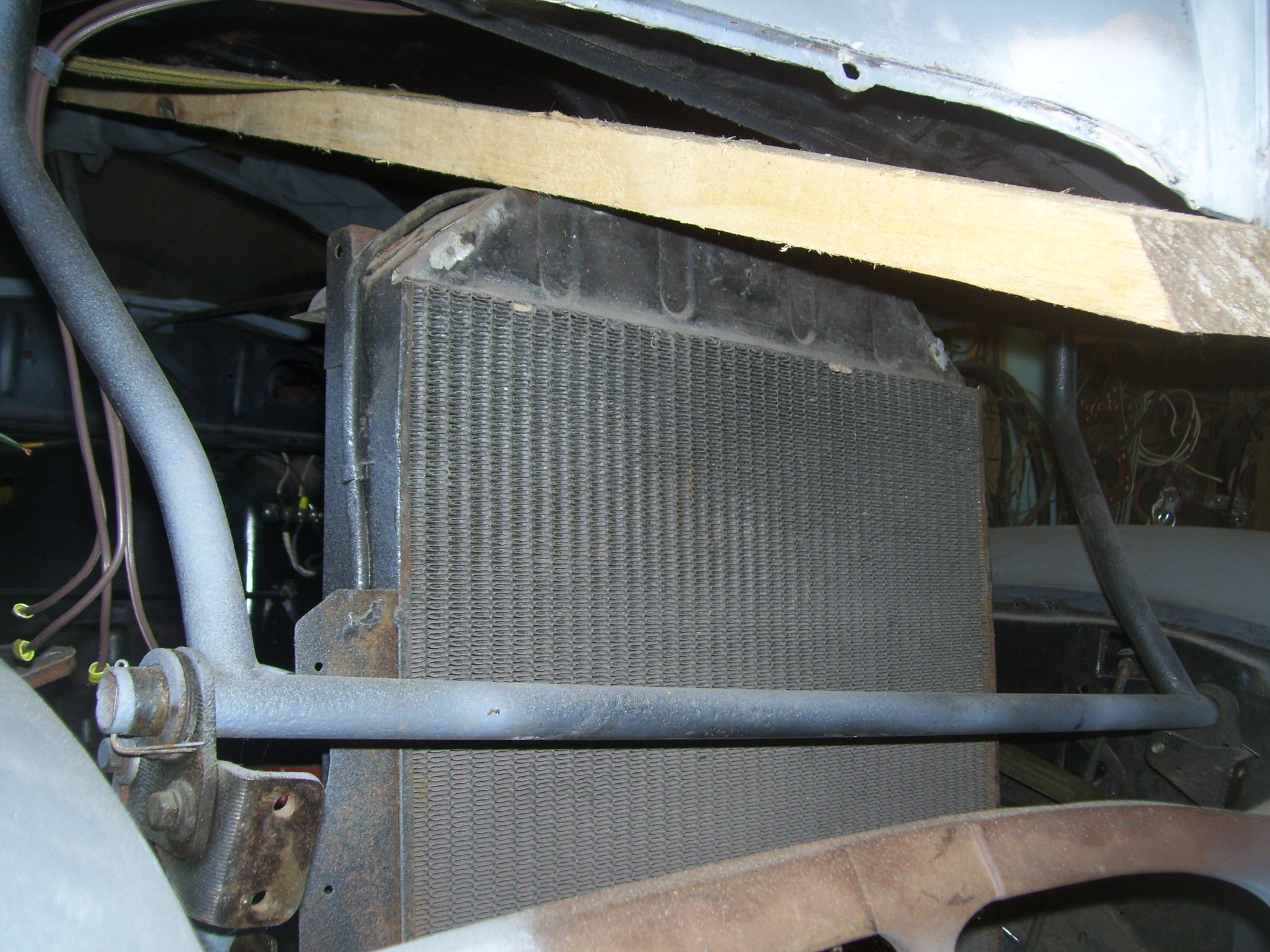

Lastly, I think I am missing whatever the front of the hood attaches to. Anyone have any pics of the front with the grille off that would show what's supposed to be there? I'm pretty stoked about this, especially having made good progress on the 50.

The front of the hood should have a u-shaped tube attached at the edge both sides with arms reaching down to frame mounts bolted to 2 holes in the top of the frame both sides just ahead of the fenders. The hood pivots forward on this by the way.
Just happen to have mine apart here ready to do a valve job on the 40. 40, 41 and 42 is the same animal. You probably don't need that vacuum can stuff. There were 2 cans etc for automatic clutch and shift.
