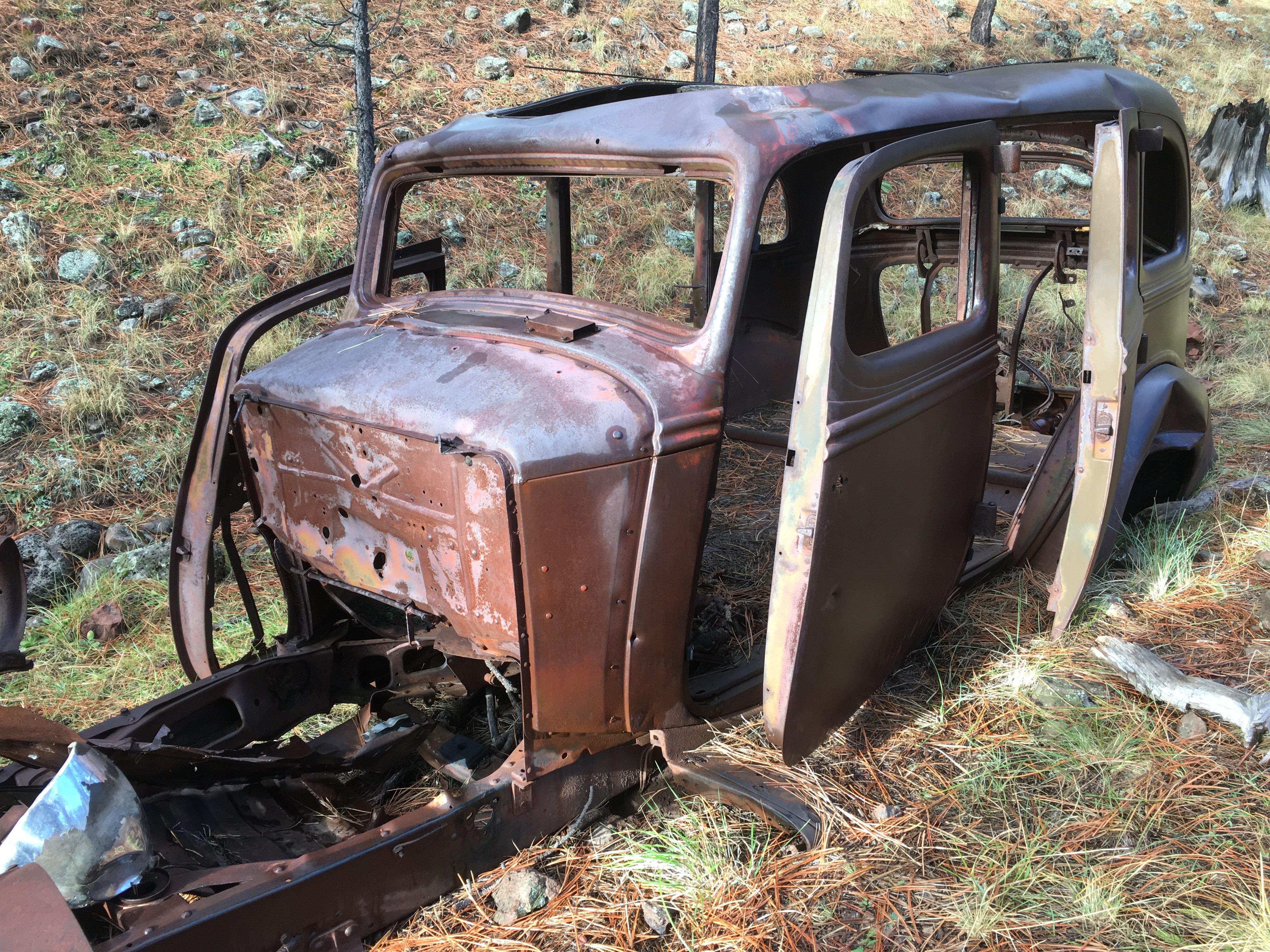

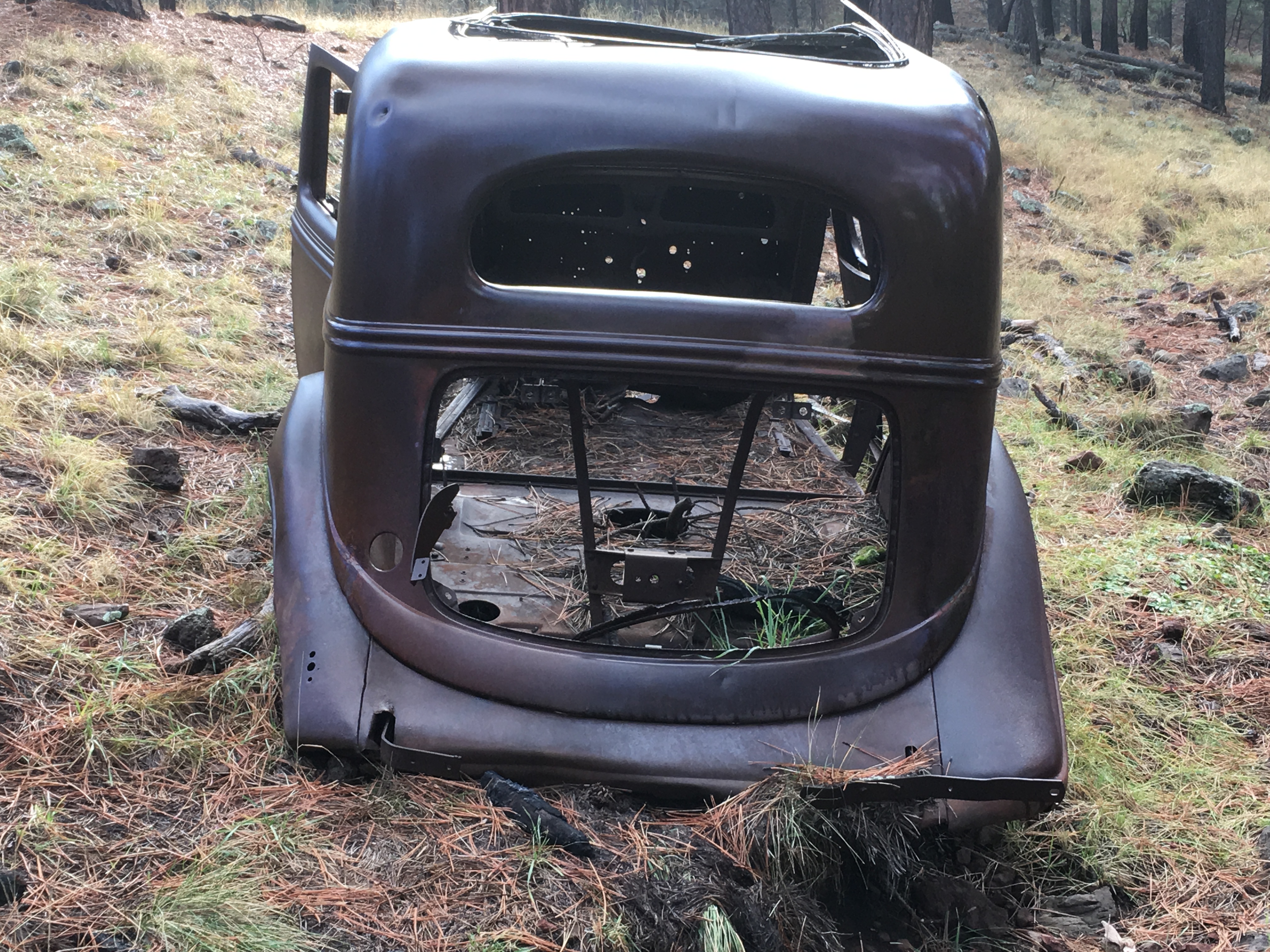

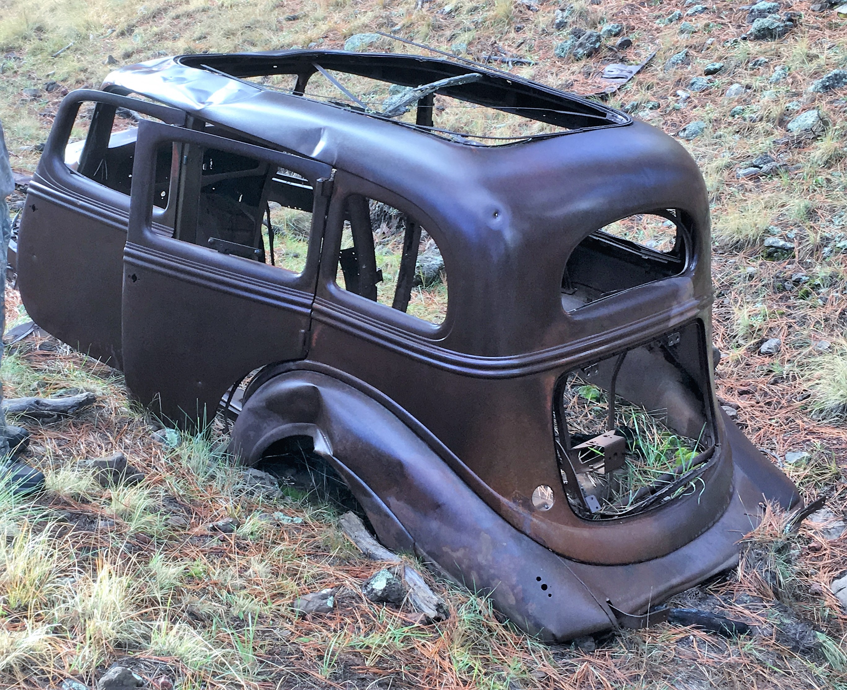

Any help would be greatly appreciated. Where do I look for a frame serial number?

If it's a 35 there was originally a tag on the upper driver's side of the cowl on the engine side.0

Thanks. I saw the spot on the cowl where a tag was at one time. Did the '34s have the tag there also?Uncle Josh said:If it's a 35 there was originally a tag on the upper driver's side of the cowl on the engine side.0 -
Pops, try looking for a stamped-in number somewhere on the frame rail, on the passenger side, between where the cowl is bolted down, and where the front axle would be. Look on the top of the rail, and on the outside surface. This was Hudson's practice later in the 1930's, and it may have been the practice in 1934 as well.
Thanks when i get it drug home I'll see what I can find.Some one told me the body is welded to the frame from the factory. I find that hard to believe.Any truth to it?0
Nope. Bolted to the frame.
