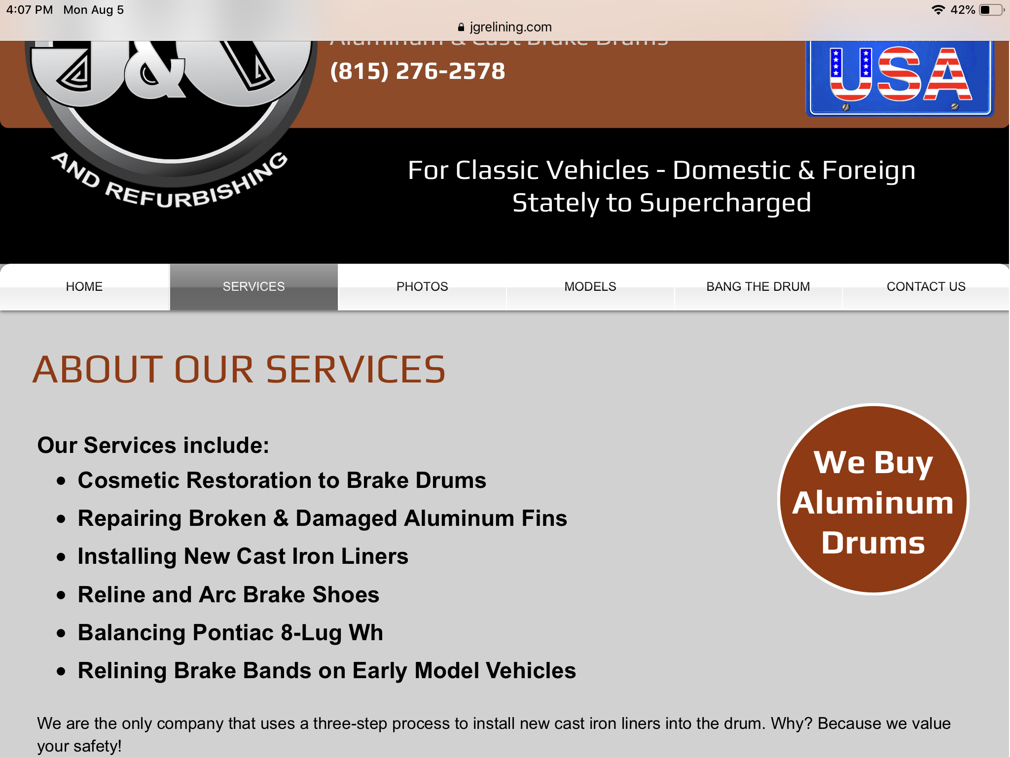

There is a place in , Los Angles I believe that will put a new drum into your outer drum / hub . I’ll try to fine them but google a little and maybe you can find them. Get new stock drums .....mmmmm0
I found my notes... 350 each for the fronts, and 300 for the rears on a 54 Hornet. Plus shipping each way.54coupe said:
I called and spoke to this company a couple of months ago. They told me they can recondition Hudson drums. The cost was something like $300.00 each. I figured that for $1200 plus shipping , I could just go with four wheel disc brakes, and get it over with.supersix said:Here ya go0 -

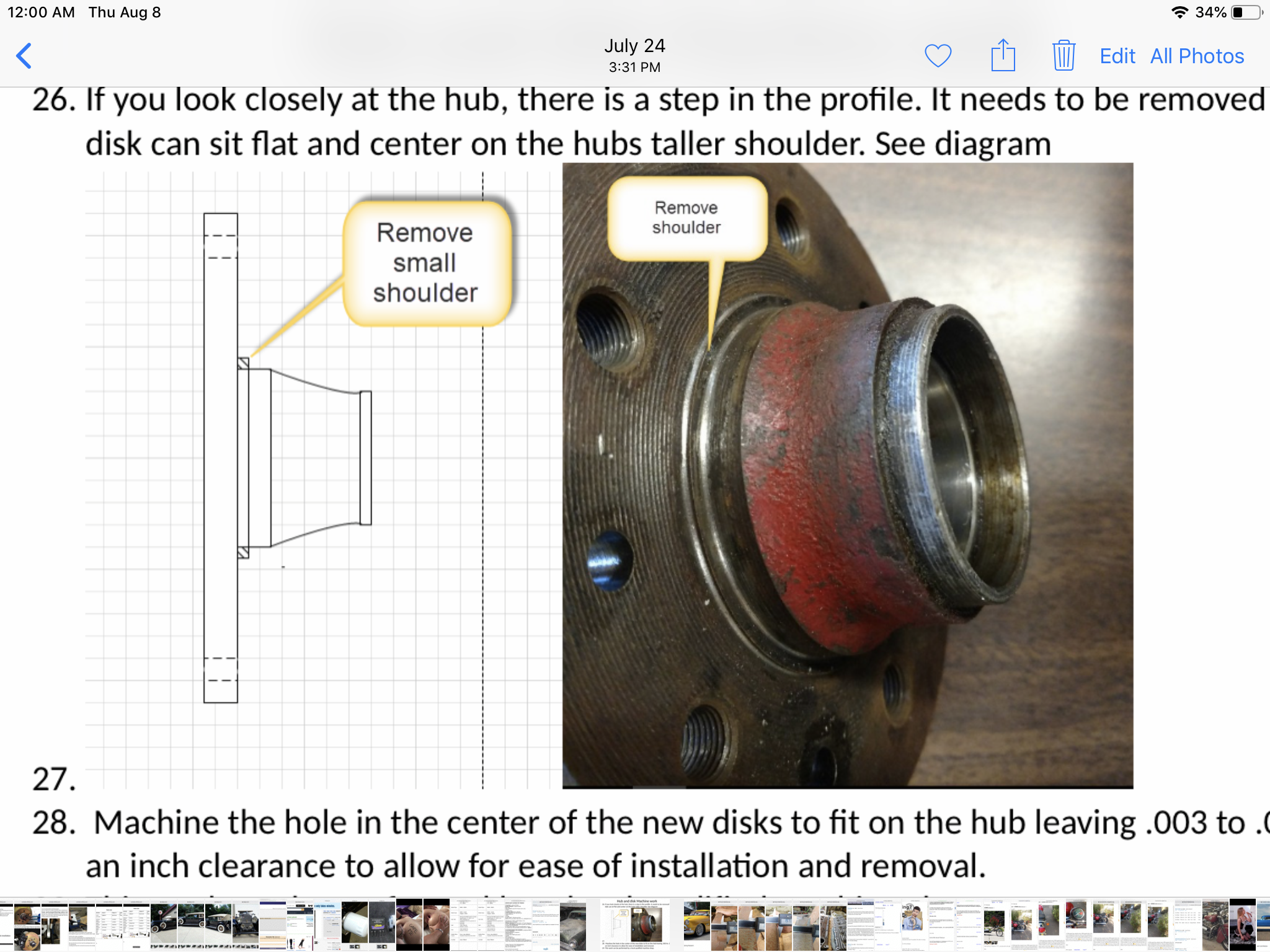

I’m installing a disc brake set up from Scarebird. You might want to check them out. 125 for the brackets. Rotors, loaded calipers, hoses , were slightly less than 200.00 you have to remove the hubs from the drums and machine a small shoulder off of the hub and enlarge the hole in the rotor about 5 thousandth. New bearings and seals were 180. This set up allows a stock master cylinder to be used although a proportioning valve may be necessary for the rears.0
Here is a pic of what needs to be done to the hub. Took longer to chuck ‘em up than to turn ‘em down.0
