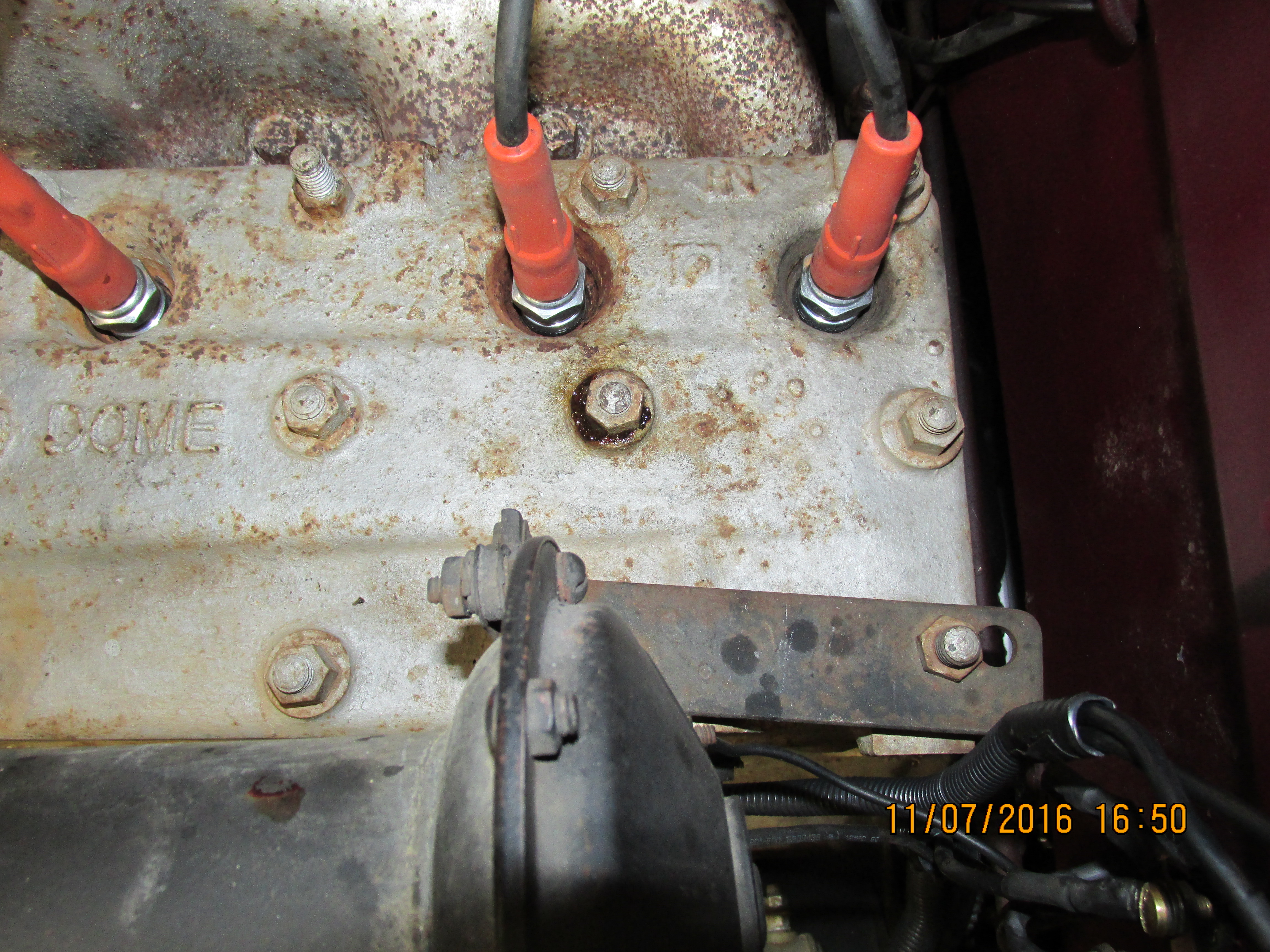

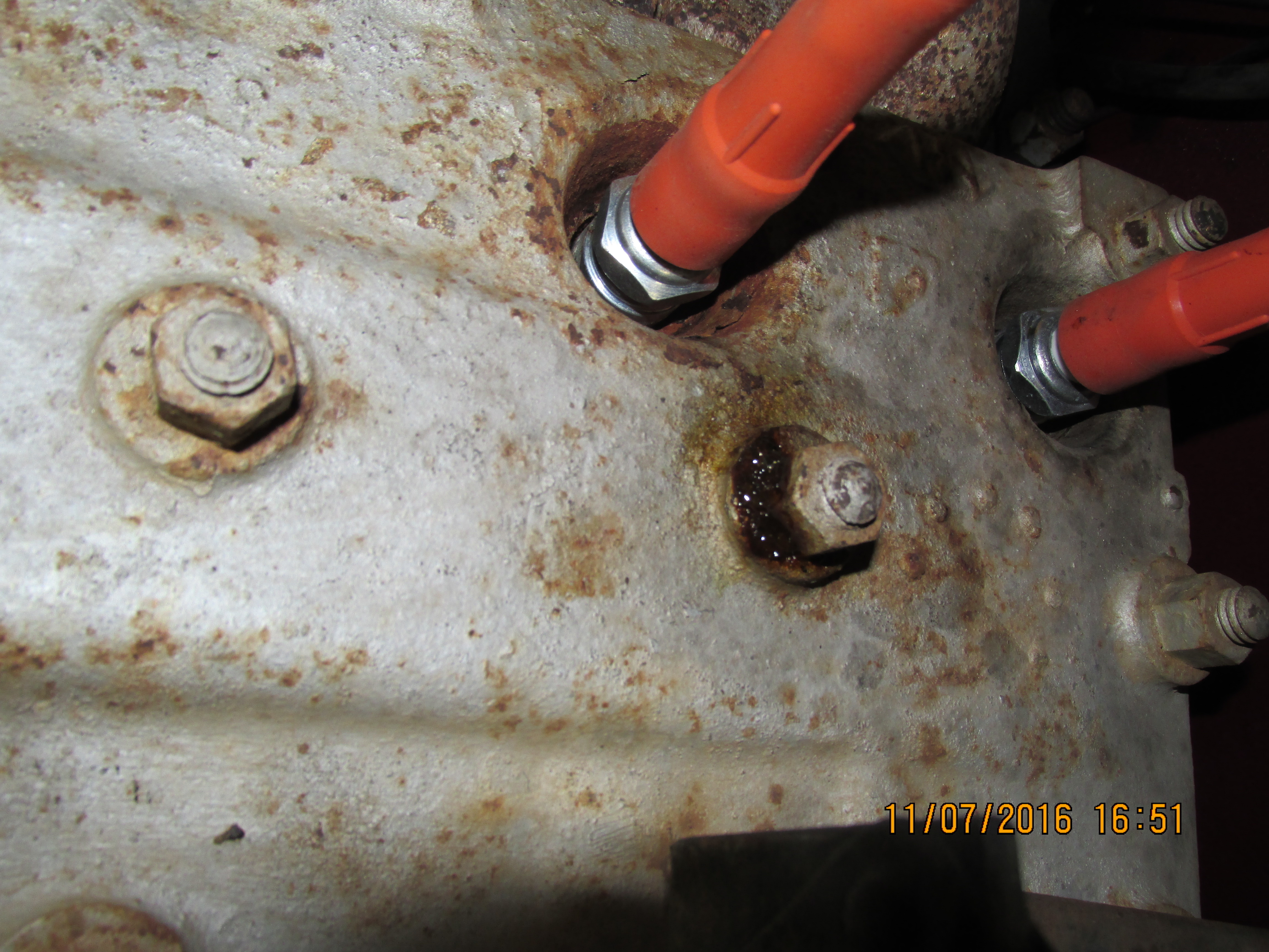

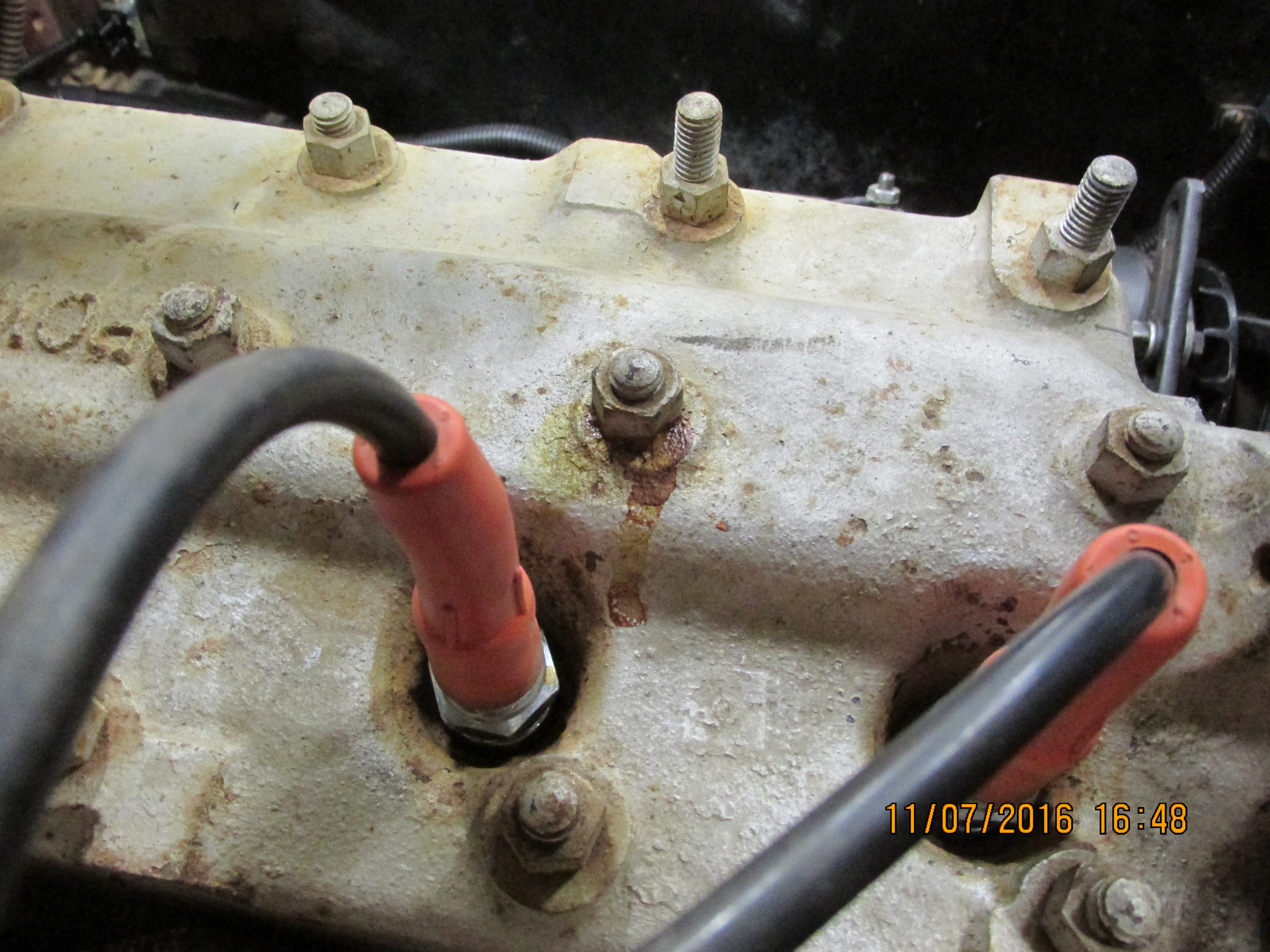

212 head leaking water
Have you checked the head nut torque? They should all be evenly torqued down to no more than 40 lbs, and the nuts should be the special wide nuts as originally used. I would recommend using a proprietary stop-leak compound such as Irontite or Chemi-weld before I went to the trouble of tearing it apart.Geoff0
The coolant is likely leaking at the stud-to-block thread interface, coming up around the stud and appearing at the nut. If this is so, it's probably not indicative of a serious issue and not (yet) a head-gasket problem.
Geoffrey's suggested solution is right on the mark.
