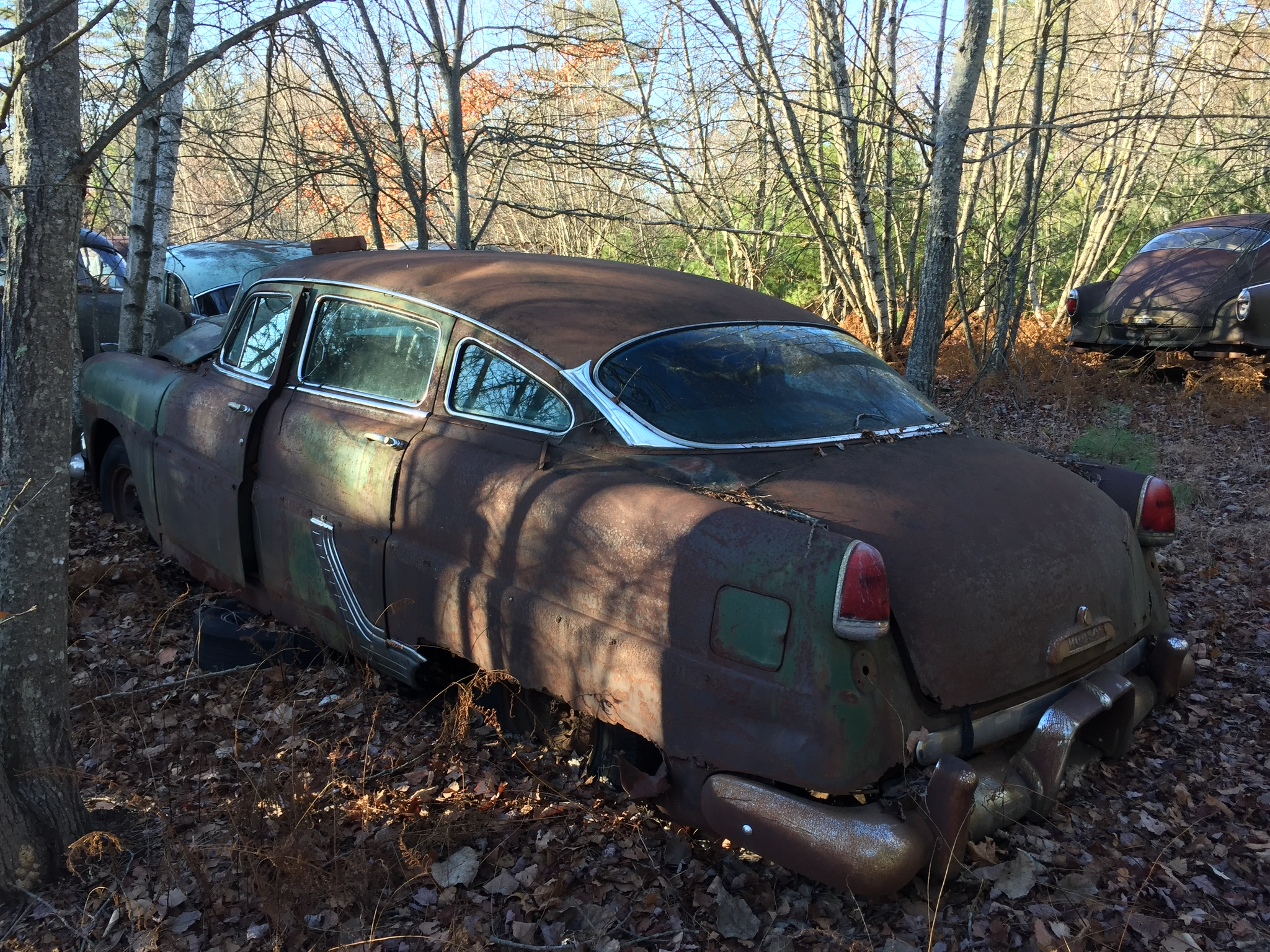

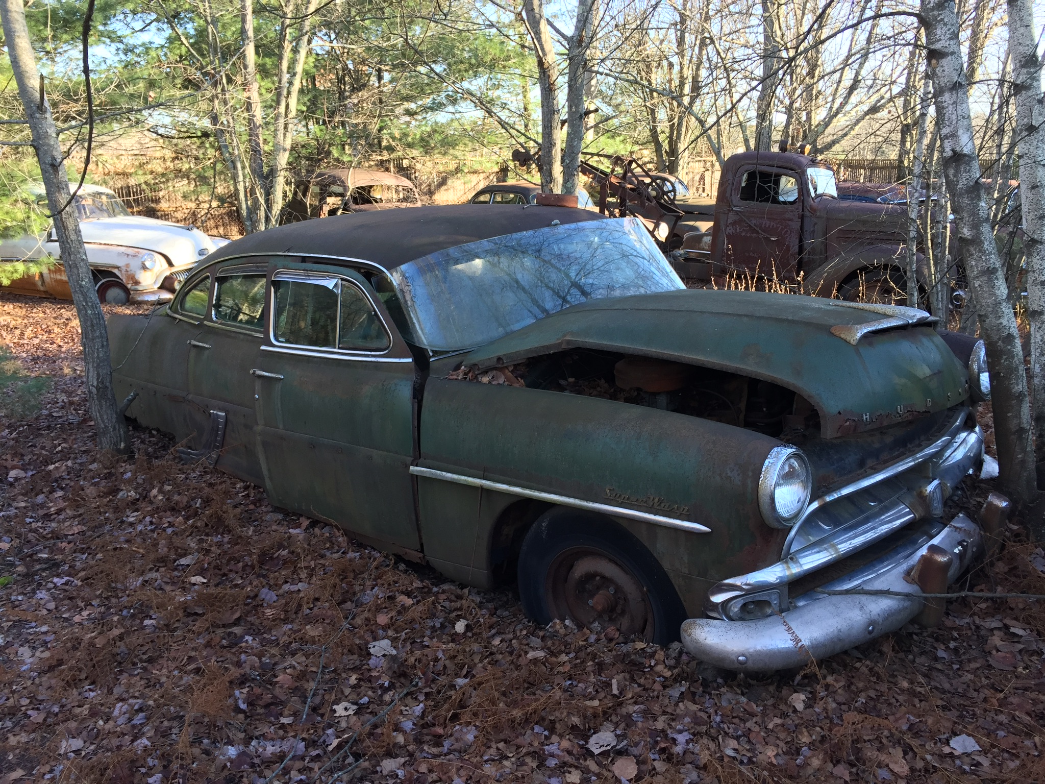

I have a 54 Super Wasp with power steering and tinted windows parts car listed on the HET forum for sale.0
Note that the Wasp and Hornet PS units are not the same and do not interchange.0
The steering sector is different, but I think the pump and servo are the same ?? It may take a little ingenuity to get a system together.0
I would hazard to guess that PS on Wasps were rarer than on Hornets?0
Super Dave,50C8DAN you are right! The 1954 Wasp Hollywood I sold last year had PS. The pump is the same with big car.0
