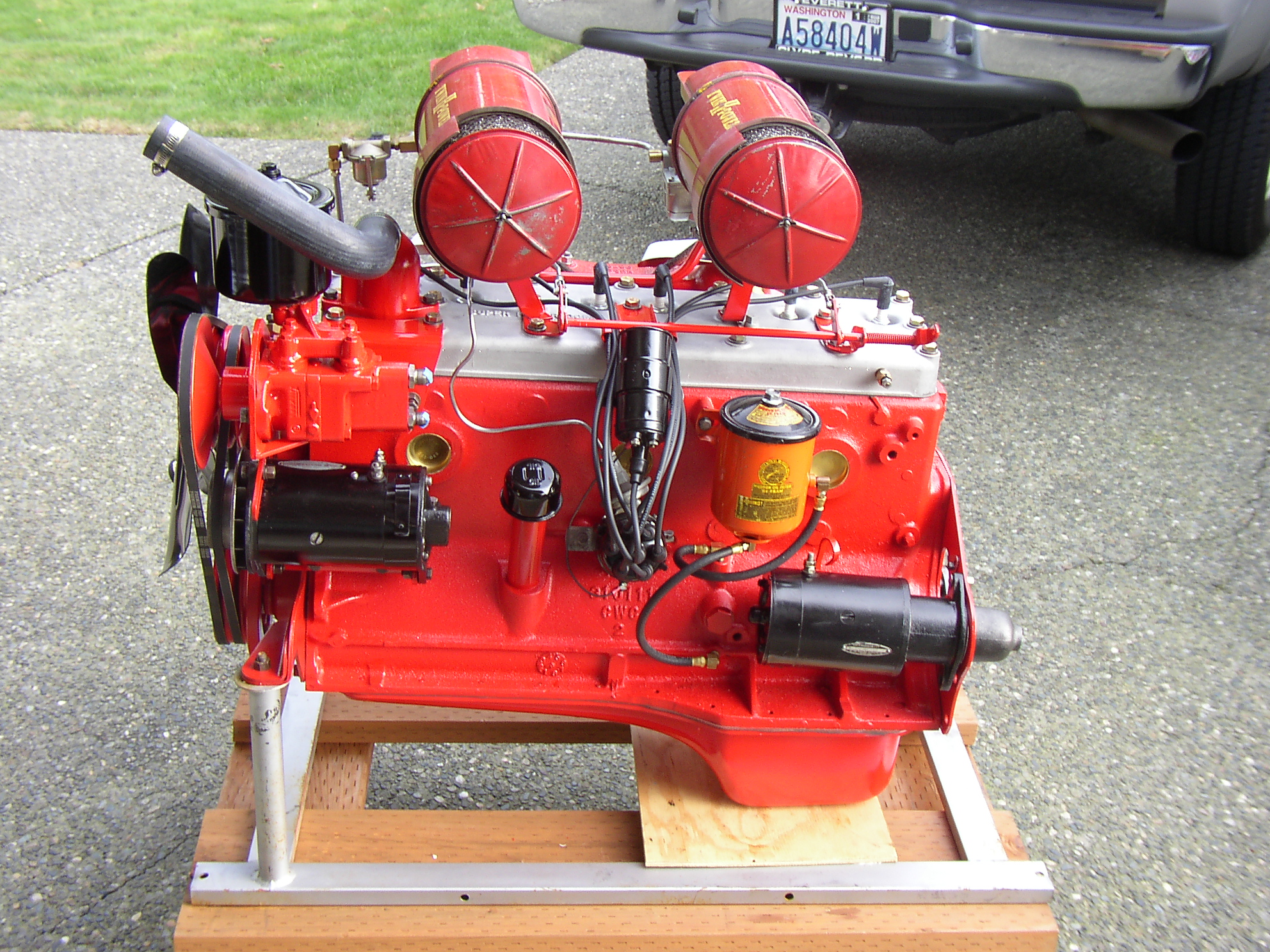

Thank you, RL. I just saw that Wildrick's sells a nice restored kit with all the decals and stuff already on it. My birthday is just 2 days away... maybe I should treat myself! Very tempting! http://www.wrphet.com/pn24.html0

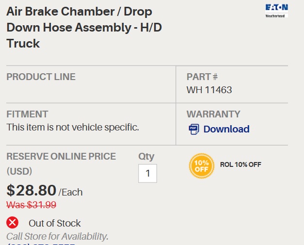

Do these lines have to be custom made based on existing? Haven't seen any part numbers promulgated.0
Richard,You can order them from NAPA, Weatherhead #11463.John0
Thanks John. Guess I'd better go to my hose place.

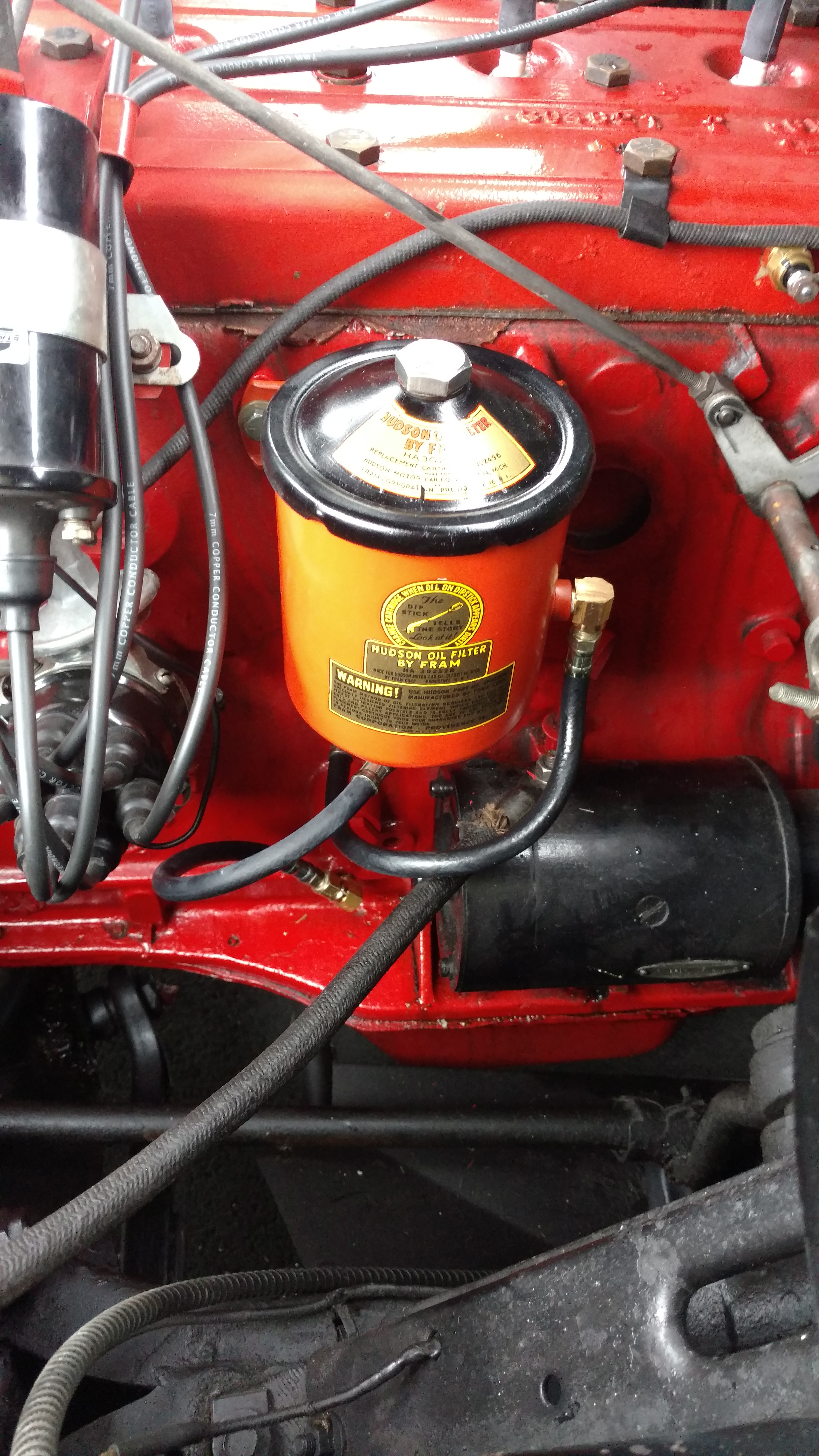

So, I was finally able to install the filter setup yesterday. Continuing with my theme of over-complicating things, the custom-made hoses I ordered did not fit right, so I had to go to Plan B. I ordered hoses for an old Willys vehicle. However, they required an adapter fitting to convert the one end to 1/8 NPT, so I had to order that online too. This looks like a good setup going forward, though, because the hoses seem plentiful - I ordered them on Amazon for $12 each with free 2-day shipping.The sockets on the block that the canister bolts to had all kinds of dirt, paint, rust, and who-knows-what-else in them, so I had to clean them out with a tap. Easy enough.Overall, the installation went very smoothly, which is saying something, considering I have the mechanical aptitude of a well-trained ape...No leaks as it was running in my driveway. I will take it on a long drive for the real test...0
