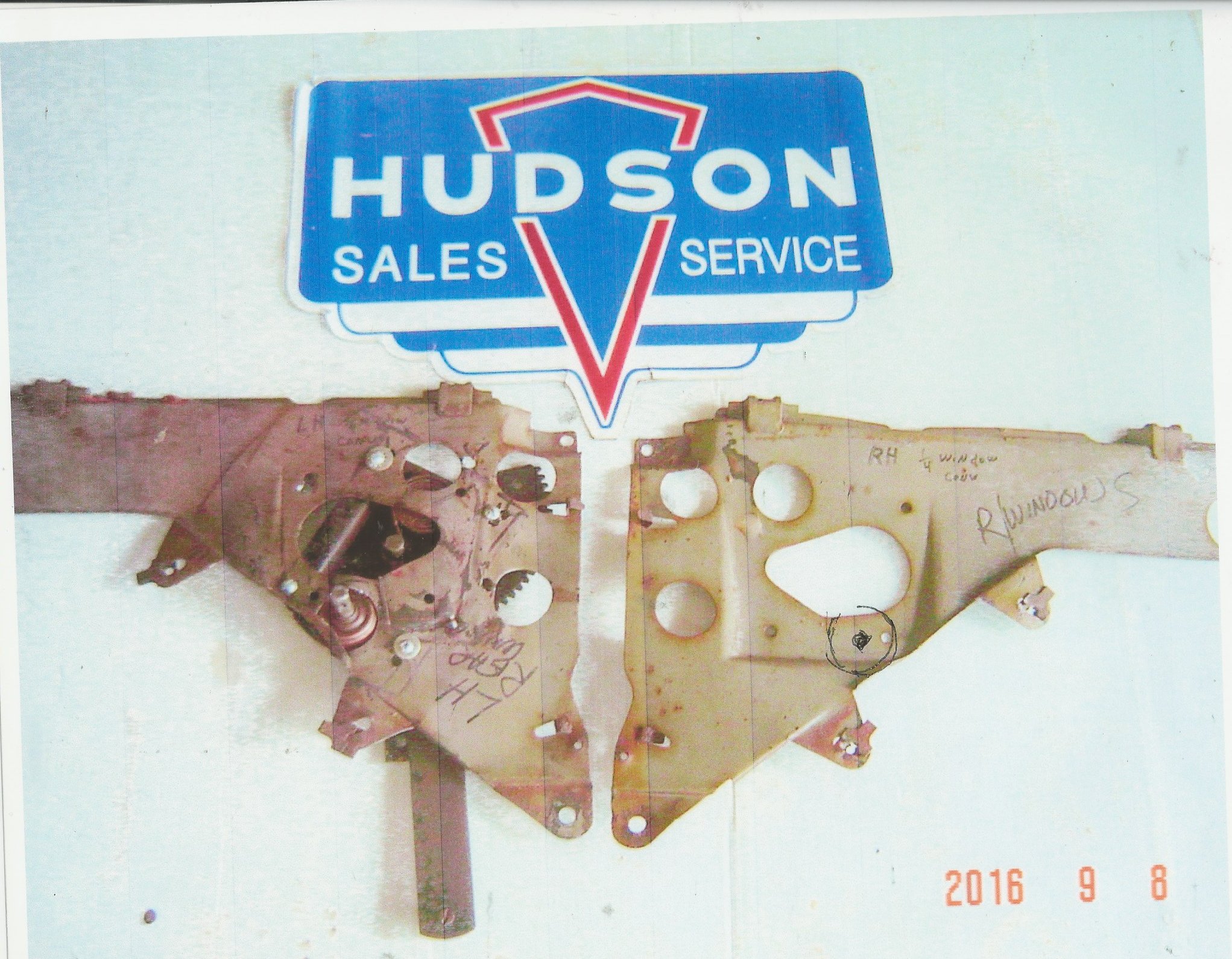

Doubtful if anyone would ever encounter this dilema, but just in case, if had a convertible or hollywood Project then discover missing rear quarter window regulators, which practically impossible to obtain, dont dispair since Stepdown Coupe quarter regulators will work perfectly by simply Indexing.
Need to flatten the original depressed area in middle of panel, rotate regulator to 5:00 position, drill 4 new mounting holes, then hole saw for handle to protrude.
