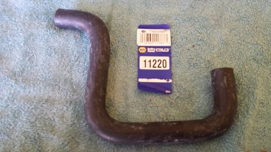

Where is the best place to get parts, like oem heater hose from control valve to heater core?0
I'm at work till 16th and will look at my dist.to make sure it's right,which it probably is and get back to you. Thanks Bryon0
Byron,Napa number 11220, cut off what you don't need.John0
