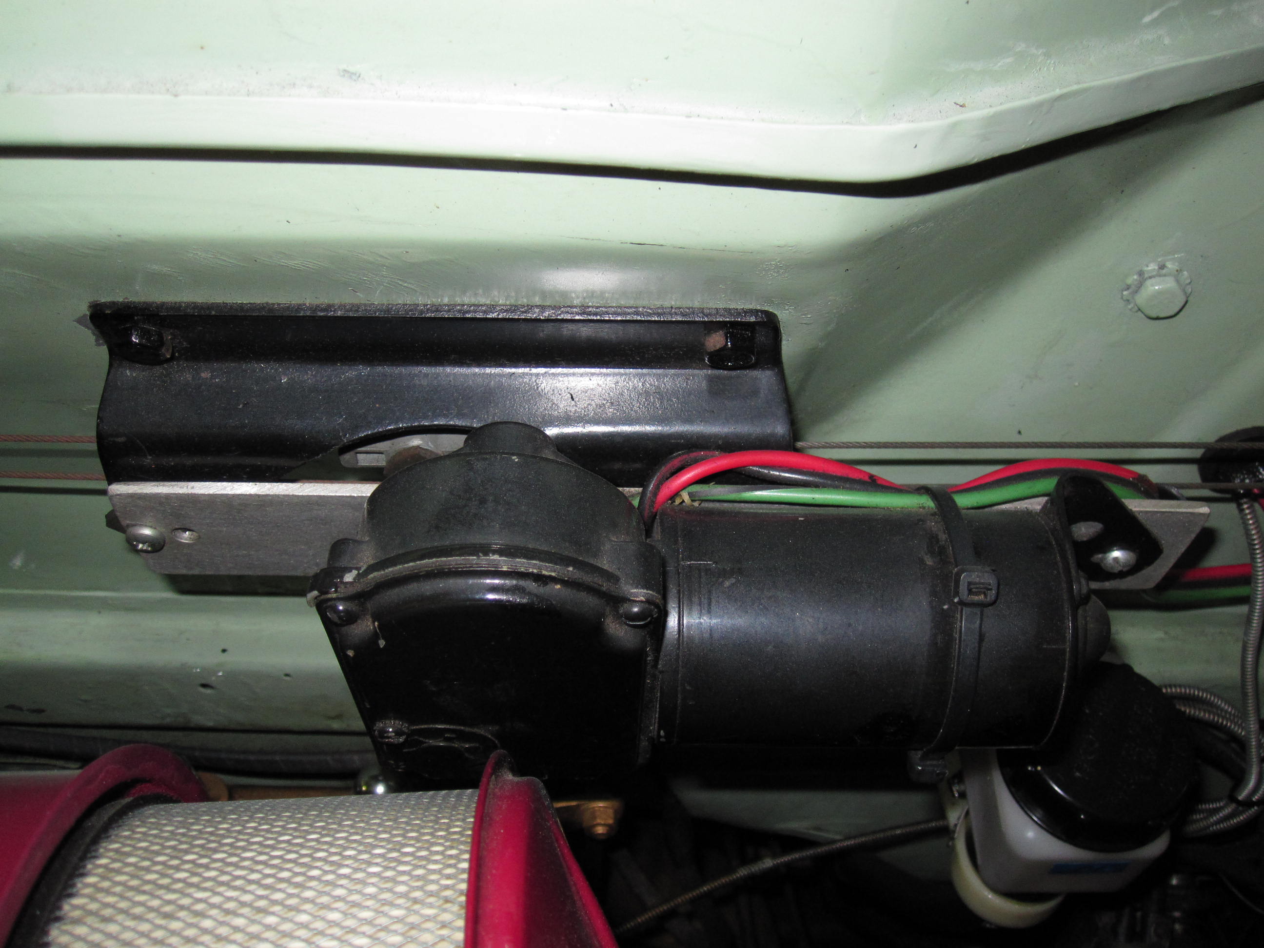

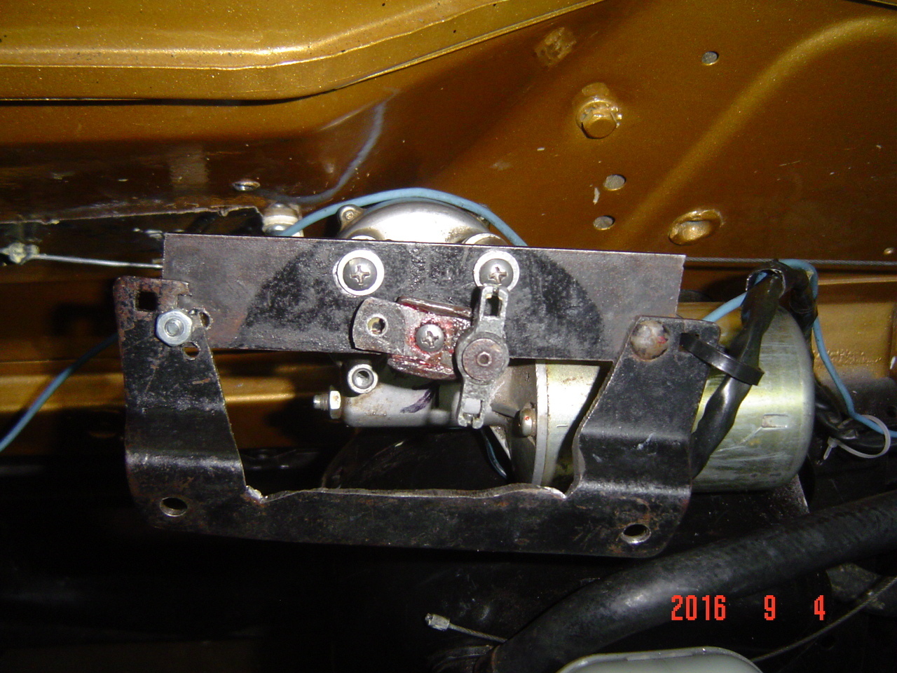

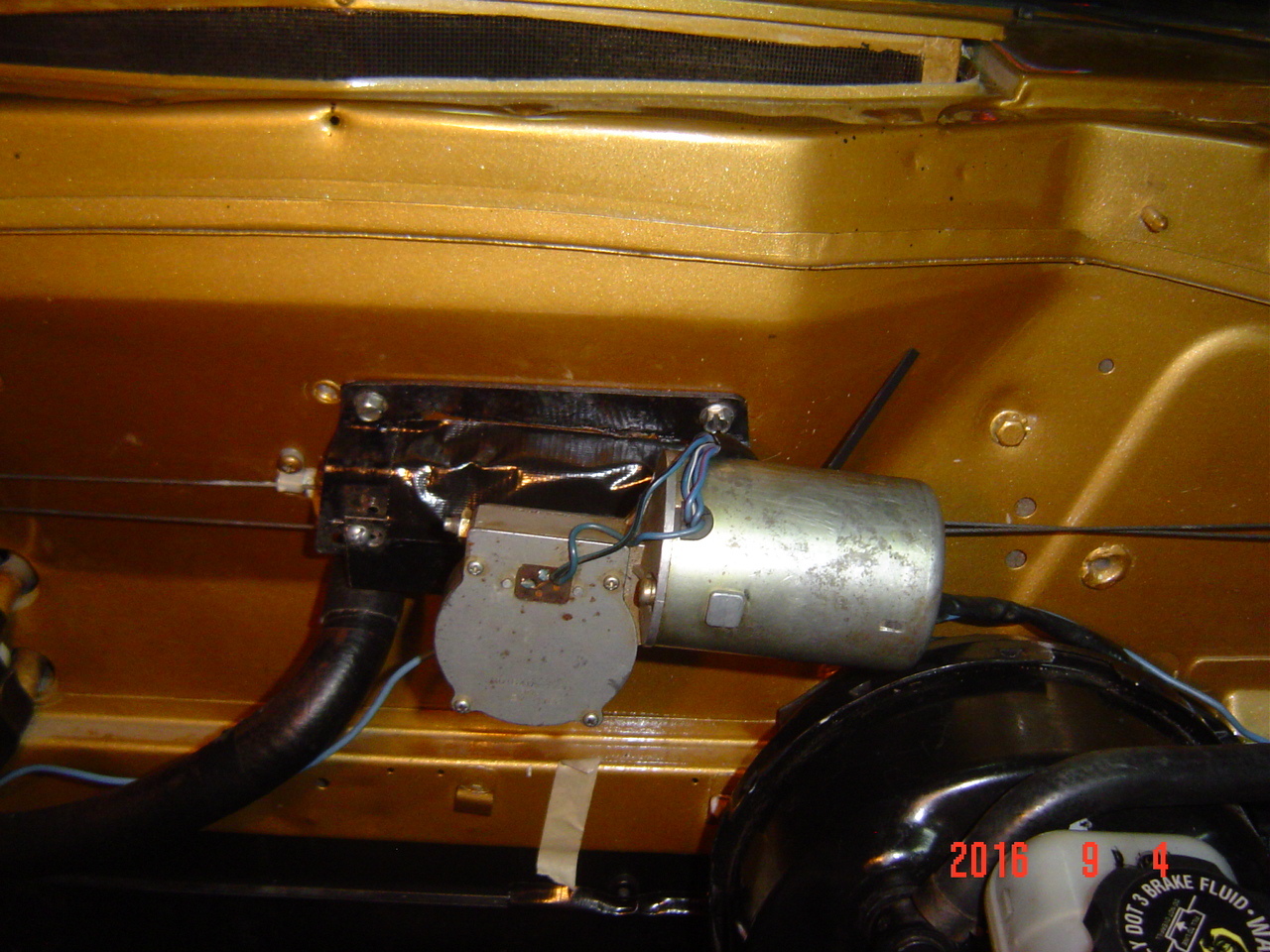

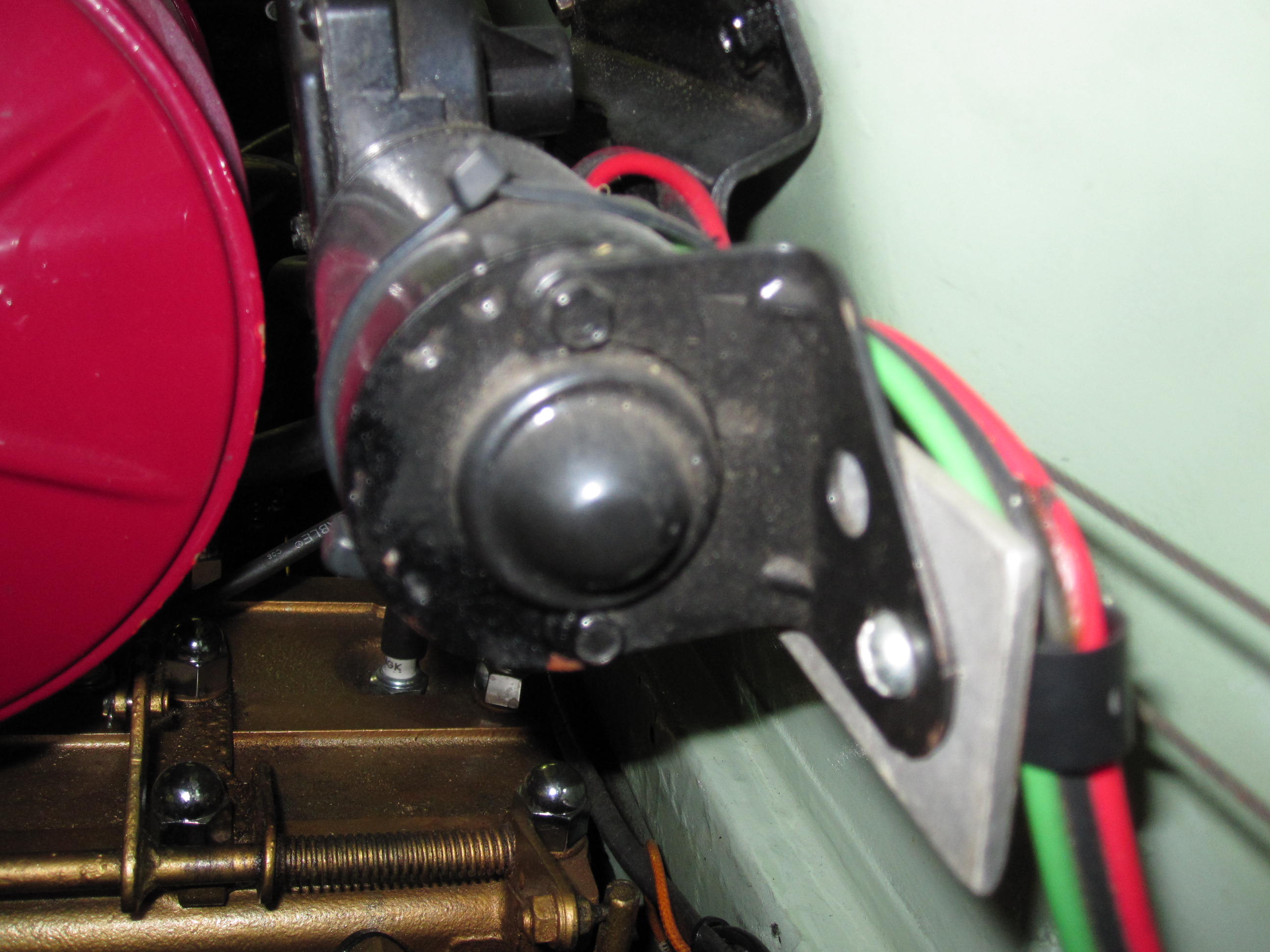

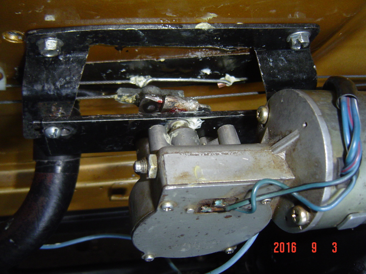

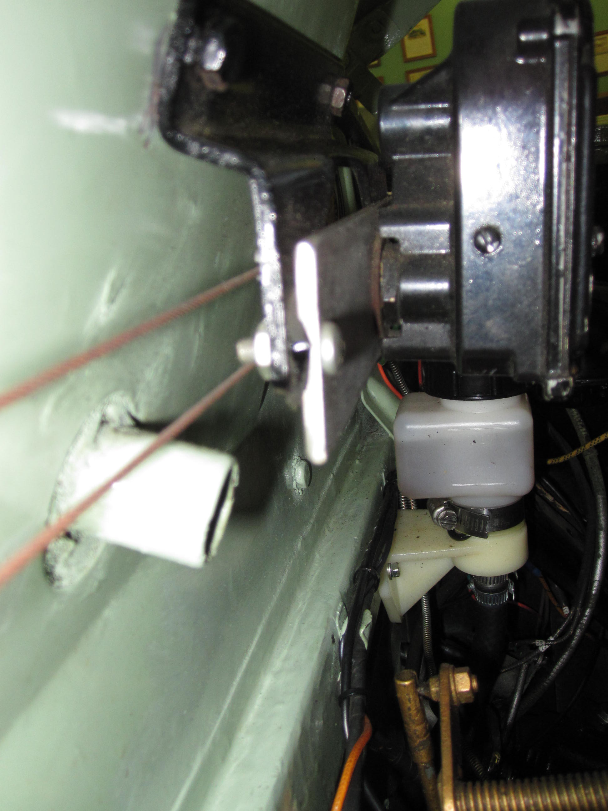

Last Spring I posted how to easily install Electric Wipers on a Stepdown with Cables by placing a strap across the wiper bracket opening, fasten the Hudson Link to shaft, drill new mounting holes, then wire a Switch, utilizing an 'Oscillating' Motor..
However, a less expensive 360 degree rotating shaft Motor can be utilized by connecting the lower cable onto the upper cable using the 'stock connector' (or piece of .094 wire or cable clamps), then remove the other Hudson 'connector' so they dont clash when shaft rotates Arm 360. It has a full Sweep
Note: Need not notch Bracket. (I only notched to figure geometry that ended up using stock Link)
Universal 12V Wiper Motors are available Online anywhere from $60 up. (6V Motors are also available) I dont have a Part Number on mine but many Motors look similar. (Motor & Linkage Pictured)
I realize Wiper Conversion Kits are available for $225 & up but pieces of Hudson linkage must be adapted to the Kit anyway, while this conversion seemed pretty easy if your at all mechanically inclined.. Ive converted many Pre- Stepdown Wipers and wanted to take the mystery out of Cable operated wipers...
