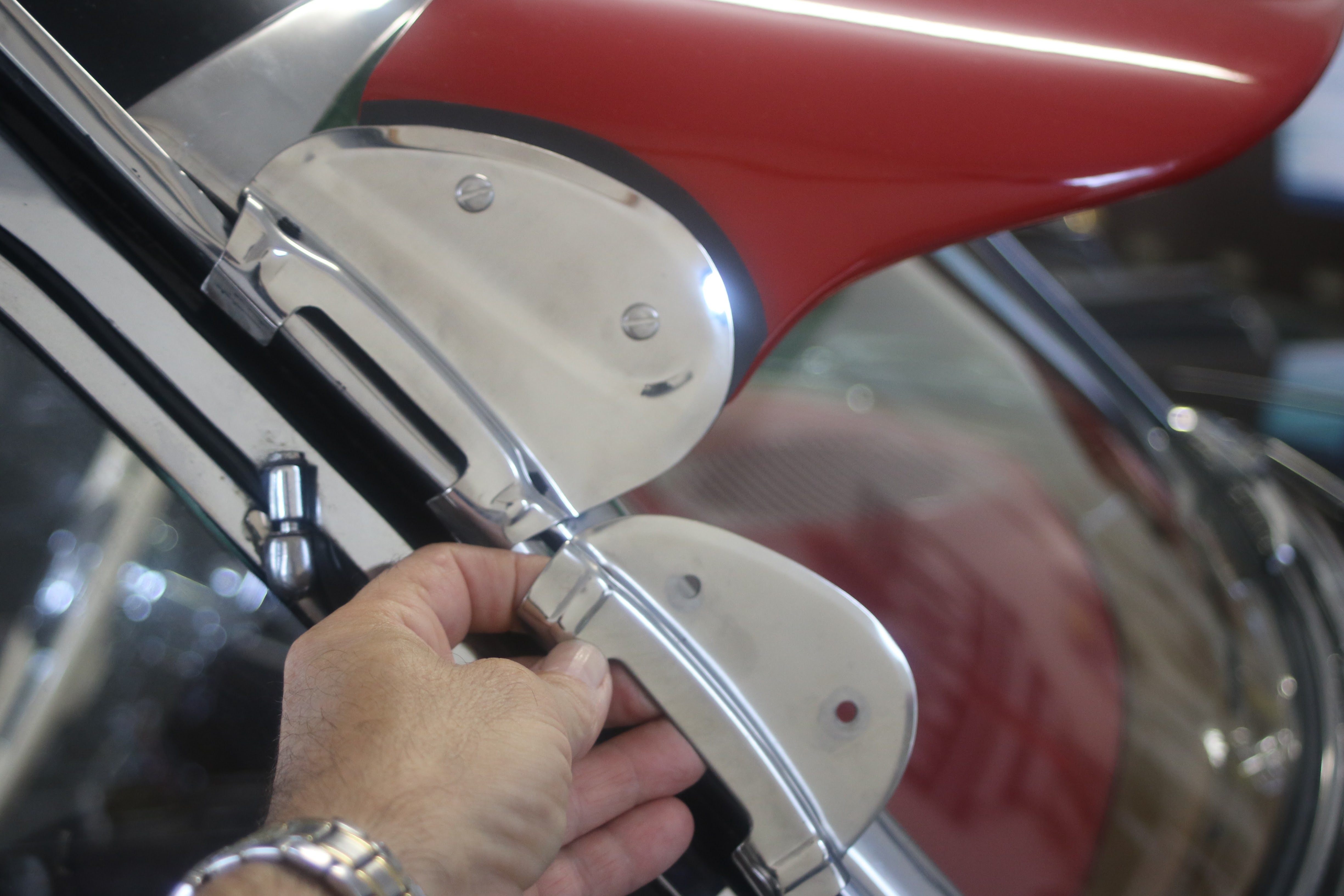

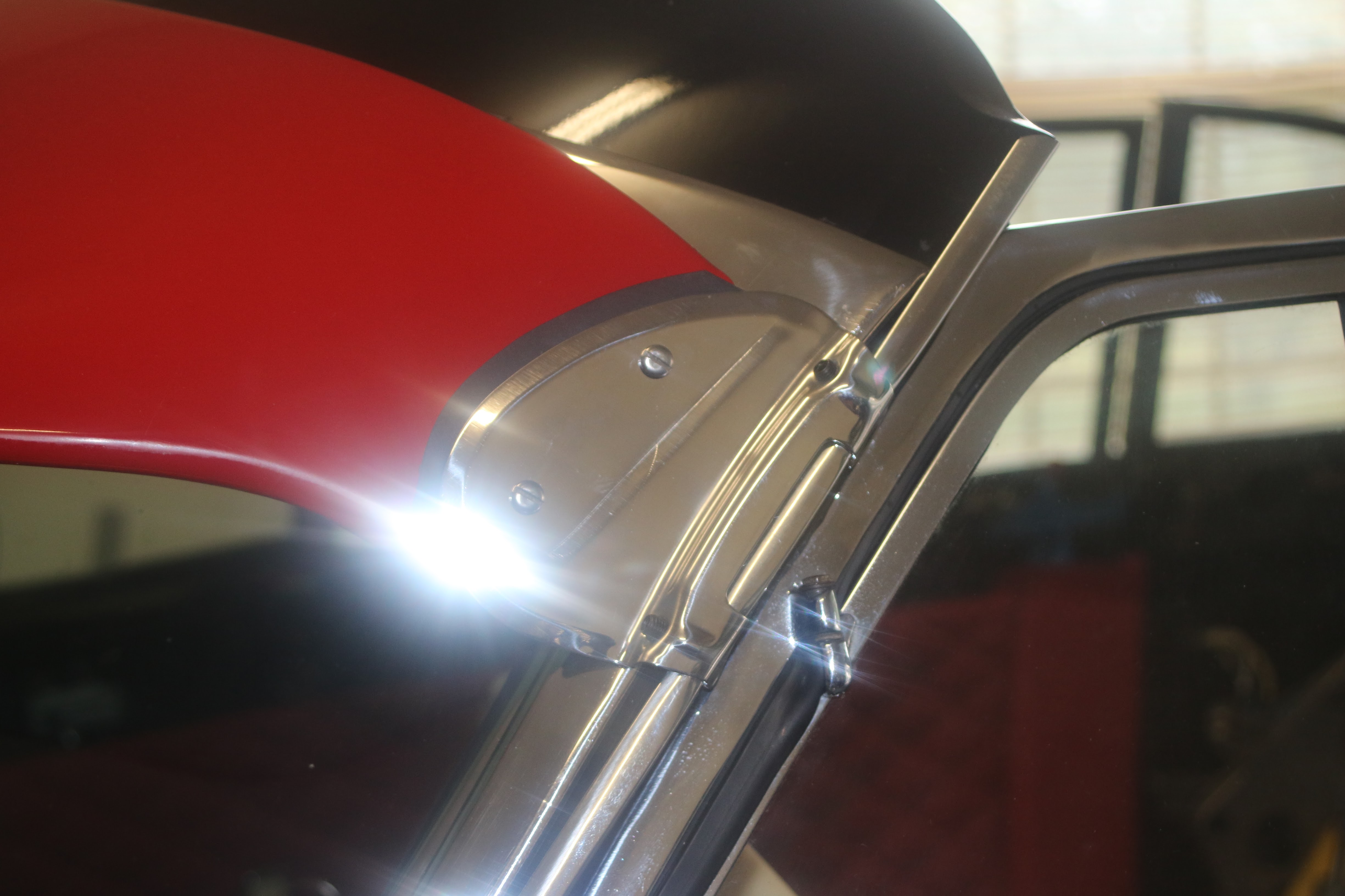

Not positive , but I think the brackets on the sides are different to clear the molding around windshield.The visors should interchange. I had a 49 with the later side brackets , worked just fine.0
lostmind has it right. The later brackets are deeper to clear the molding around windshield. Bentmetal makes the larger brackets. We had a post on the forum (not sure which one) about this very thing.0
Here it is:I have since put on the brackets and showed pics, I'll see if I still have those handy.0

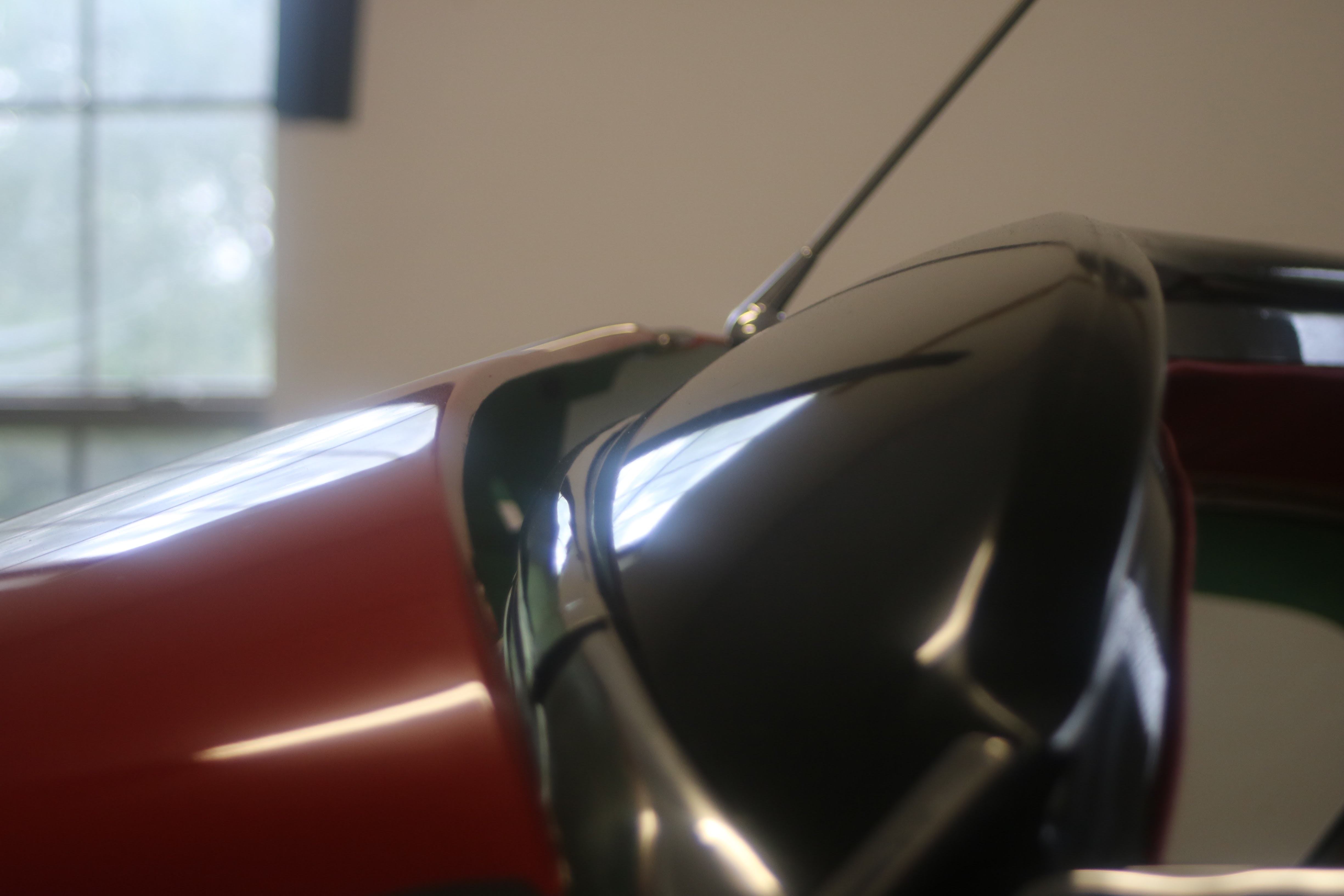

Here's some pics to show visor installed with larger brackets. Bentmetal made the brackets for me.

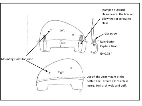

What are the size differences...in inches? The brackets on mine barely clear the windshield trim but it looks as though I mount mine higher on the gutter than Russ's. My visor is going on a '51 Hollywood with the stainless gutter bling.0
From my hudson restoration website
Mod instructions for no trim and full trim gutter. Hudson visors had one or other
Brackets depending on car it was ordered for. 0 -

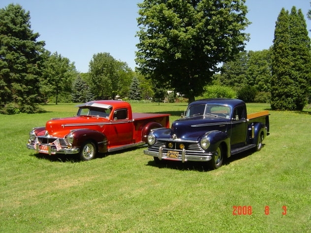

Bryon,
I installed a Visor on my '47 Trk by making the brackets using cardboard templates curving slightly onto the roof. I used a pc of polished stainless with stainless screws. I was reluctant to drill the Rood but no other way.
I dont think the brackets look bad since their not very large. I did buy the center 'clamp' bracket available from an E Bay supplier. Attached picture if want to see appearance with a Visor. I dont believe my visor is as as large as a Fulton though.
If serious, I can take a close up of my bracket in a few days when I get Trk out of storage
Without the center bracket, me thinks these things will become a drone. And then I thought of '54s?0

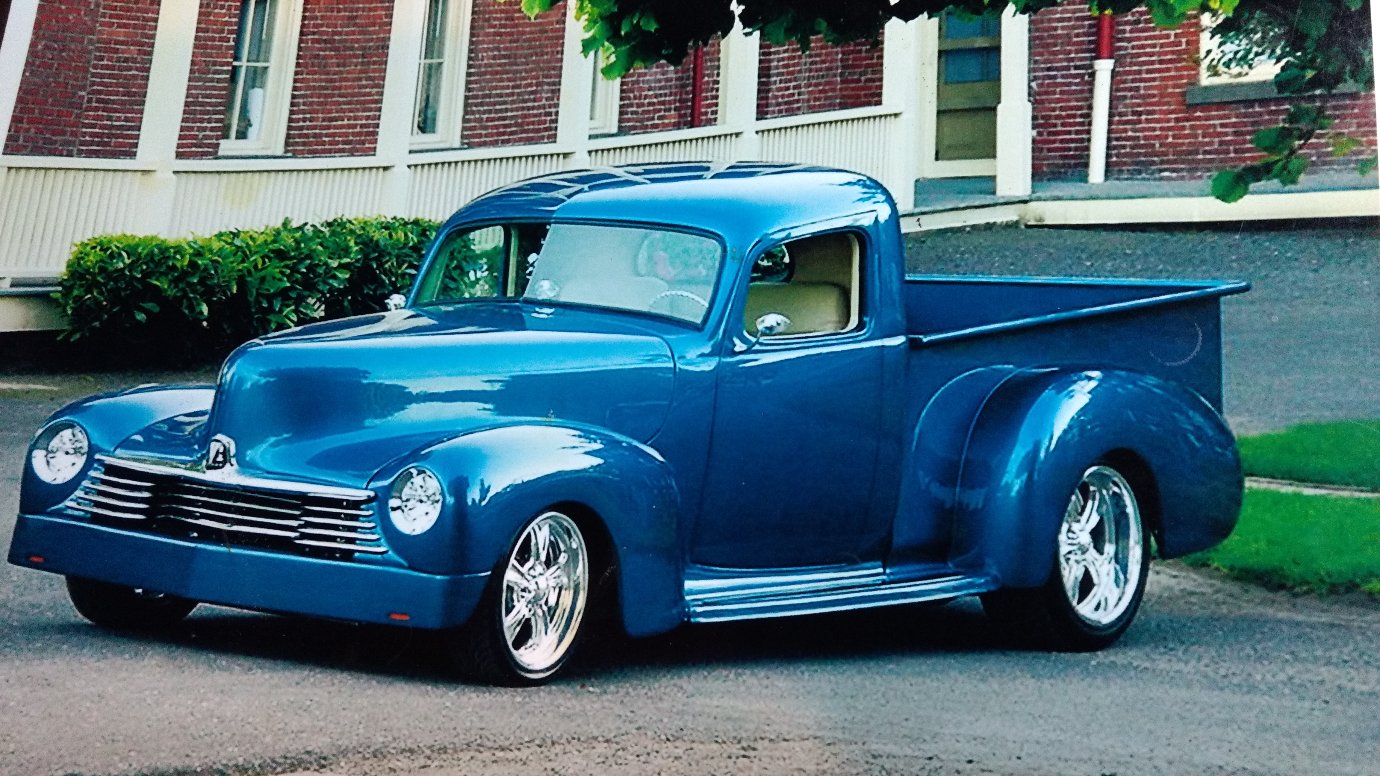

Hey Guys, many thjanks for the responce. I think that I'm going to give this a lot of thought before I go drilling holes in anything. I did notice an A/C pump in one of the pics. Thats my next project. Is there a pump mount available, or maybe drawings etc. I have the entire a/c & 2 shev pully installed all except for the pume. The included pic. is my target, all except for the frenched headlights.....Byron0
