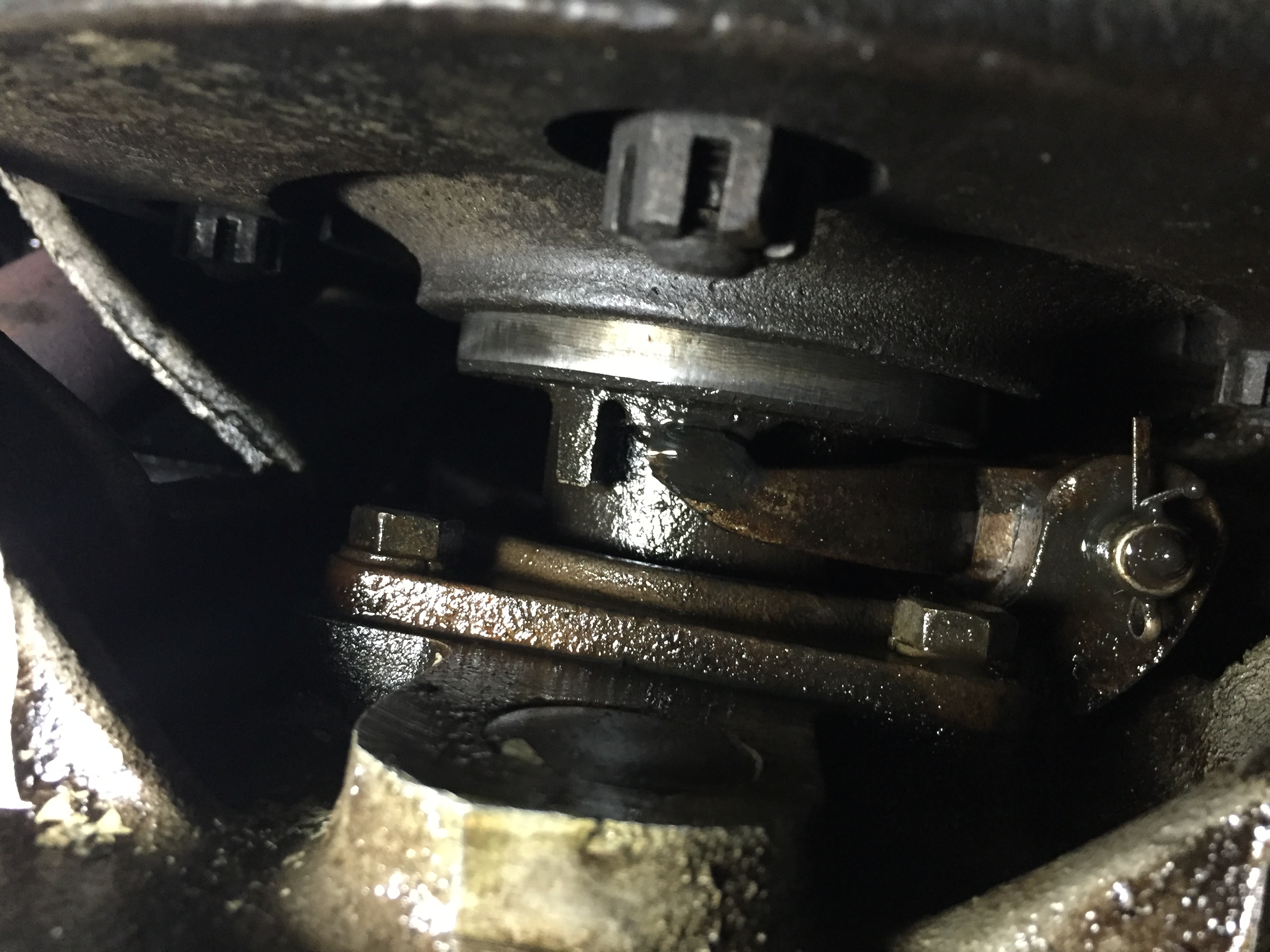

I drove my car a couple times since I bought it last year. It had very little power, which I assumed was expected. However, when the clutch is fully disengaged and I give it gas the car revs disproportionately as if the clutch is partially engaged. Again, I assumed this was how the car drives. On my way home the transmission wasn't responding as I applied the gas. I was unable to get up the last hill. On a flat surface the car will move slightly, but it doesn't have enough power to get up to speed or to go up a hill. It is acting like the clutch is almost fully engaged. I know there is an adjustment on the clutch, but before I tamper with it I wanted to see if anyone else had a similar issue. I've attached a picture of the shifter finger and plate with the clutch disengaged. Not sure if it is currently in the proper position (I.e., fully disengaged).
How much free play do you have ( distance between pedal and floor)? If you have free play and the clutch is still slipping your clutch disc needs re-corking.Geoff0

When you're driving up a hill will the engine start to run faster, even though the car is still plodding along? That would say "slipping clutch" to me.

It's possible that you have put too much ATF in the clutch, which would make it slip. You must fill only to the level when the filler plug is at the bottom. By free play, I mean the distance from when the pedal is resting against the floor board, and it starts to disengage the clutch. The first inch or so there should be no resistance at all until the fingers contact the thrust bearing. You must use only GM Dexron 3 ATF.0

There does not seem to be any free play at all. The petal moves about a foot from the floor board up. From the time the clutch petal is initially pushed to the time it reaches the floor board there is always tension and movement of the thrust yoke.0

Without a bit of freeplay (when you first step on the clutch pedal), you can't be sure that the clutch disc itself is fully engaged with the plate. If you adjust the clutch so there is some initial freeplay, that means that the clutch disc is "fully engaged, for sure".
Without the assurance of freeplay before the yoke starts to move, the yoke could already be pushing the clutch disc away from the pressure plate -- even without your even touching the pedal. Thus, there would be a bit of slippage between the two.
Which could explain why the engine revs when going up a hill but you aren't moving as fast as you could.
I agree with your logic. Unfortunately there doesn't appear to be much room left to adjust it in the direction necessary. Regardless, I am going to try. The only problem is that I have a steep driveway and small garage. I will have to get the car towed up the driveway if it doesn't work. I am really hoping I don't have to re-cork the clutch. That sounds like a huge pain.0

I made some adjustments to the clutch until there was free play and the car still behaves as if the clutch is stuck partially on. I guess its time to take it apart. At least I was able to drive it once.0
