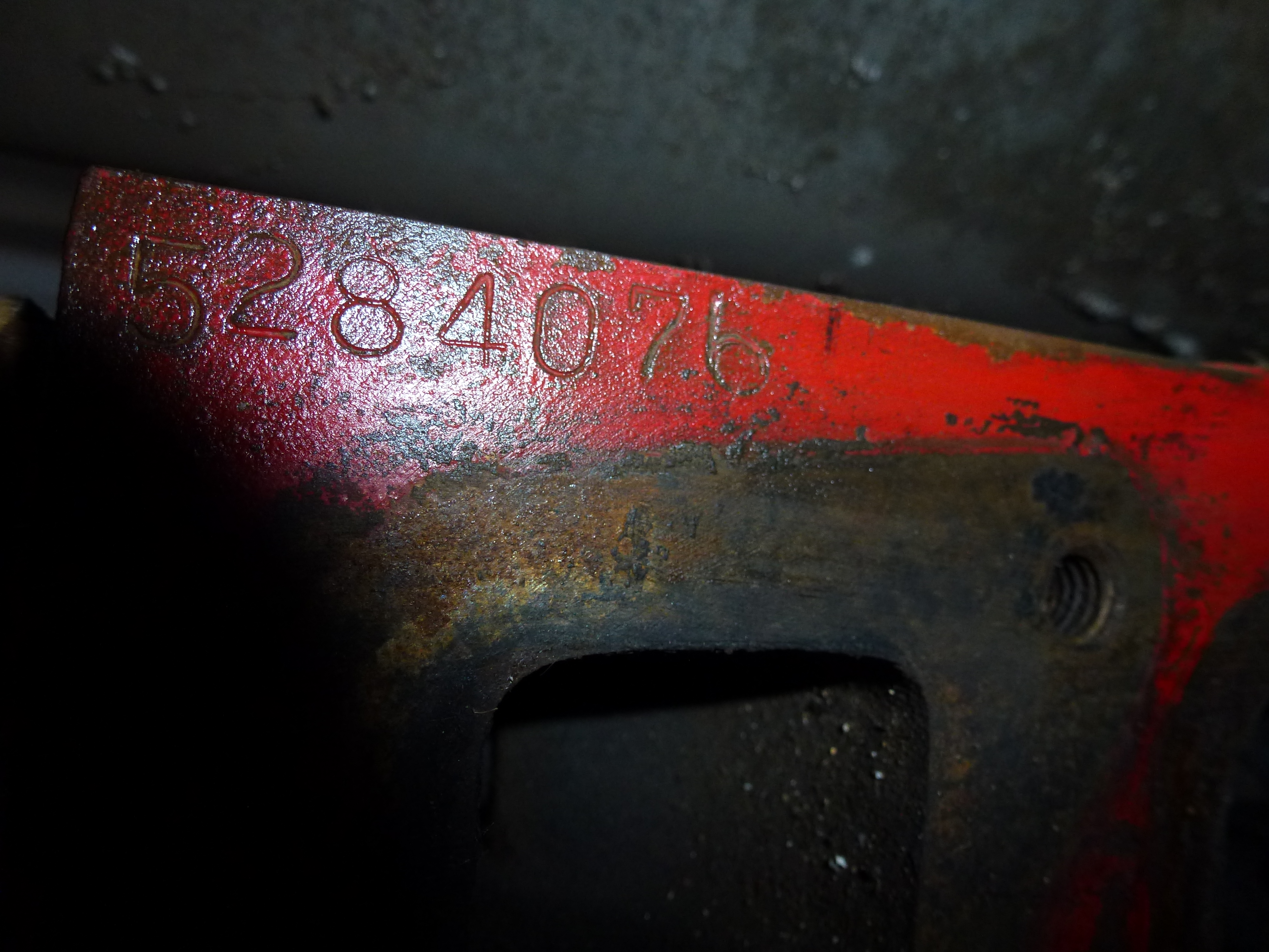

Thank you much. Mine has 310111 so it is a 1954.. Is the engine serial number the same as the body number?
That is not a serial number but a casting number from the foundry. Serial number is stamped on passengerside of block at front edge just ahead of the exhaust manifold.0
OOPS, Too early! Yes, serial number on the body plate should match the stamped number on the block.0

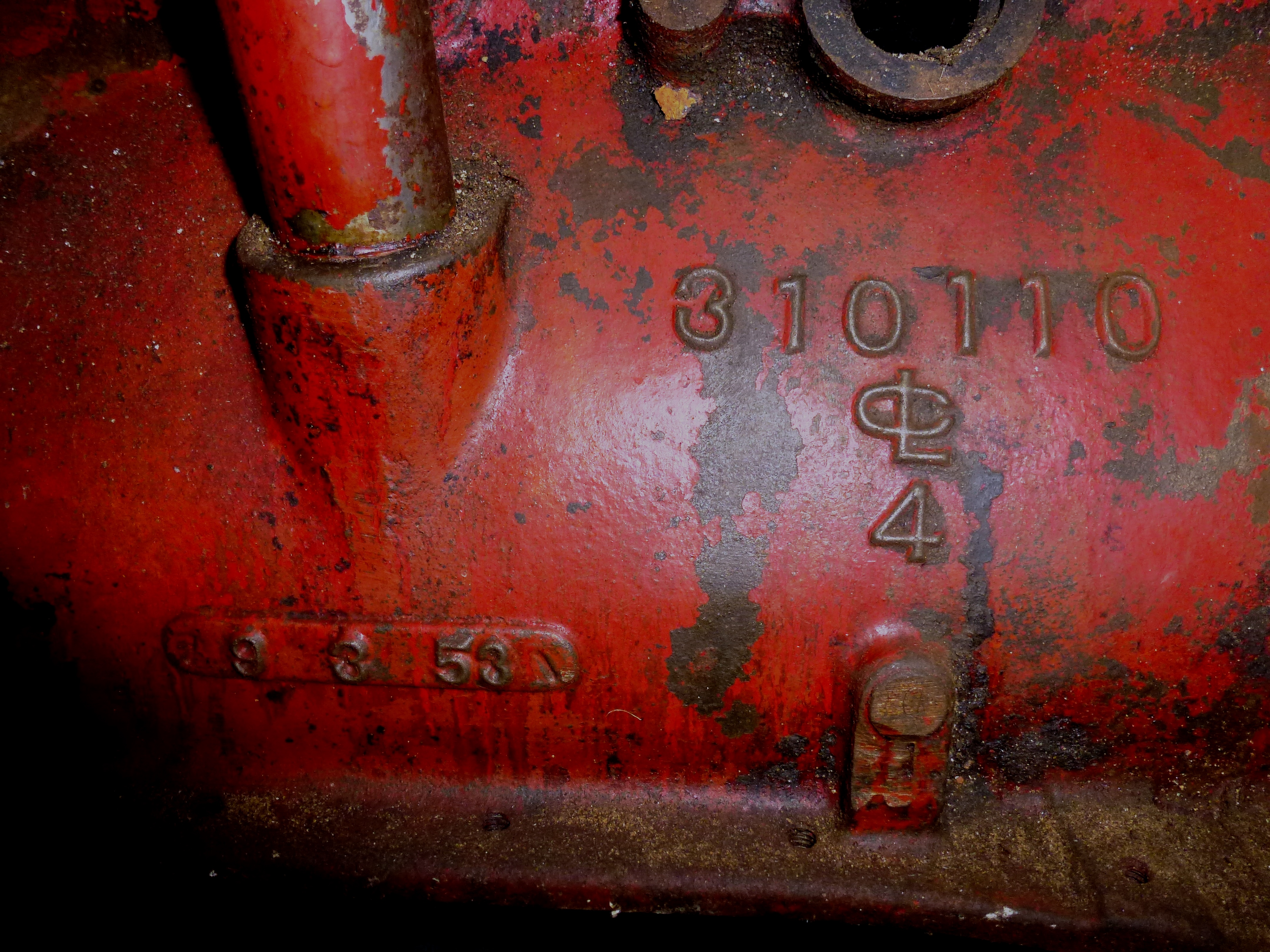

Lets try some pictures of numbers in question,0
For those who are curious, the foundry logo on this 262 Super Wasp block is for the Lakey Foundry and Machine Company, Muskegon, Michigan0
What does the number 310110 signify then if 310111 is 1954. Different foundry, same year?
Its a 262/232 block rather than the Hornet. As to foundry, Foundry logo is right below the casting number.Most were CWC / Campbell,Wyant and Cannon. Those with WF were cast by West Michigan Steel Foundry."Ric"0
