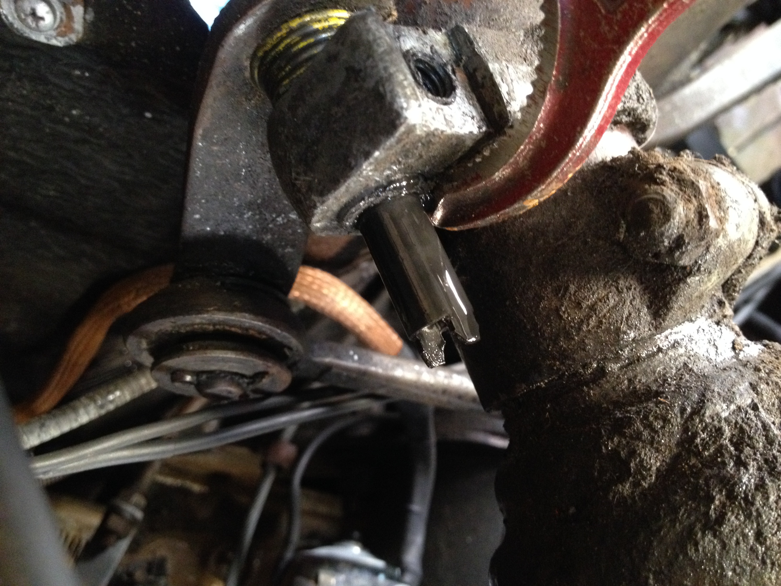

It appears that the end tube on my steering column that connects to my shift cable has broken. It is a '49 Super Six 262 and after getting advice from some experienced members on this forum, I found that the reason my car won't shift into second and third side of neutral is because this end tube is missing the part of it that pulls the cable up.
I don't know what it should look like when it's complete but here is a pic of it as it is in its broken state. Apparently there should be more below the two forked ends.

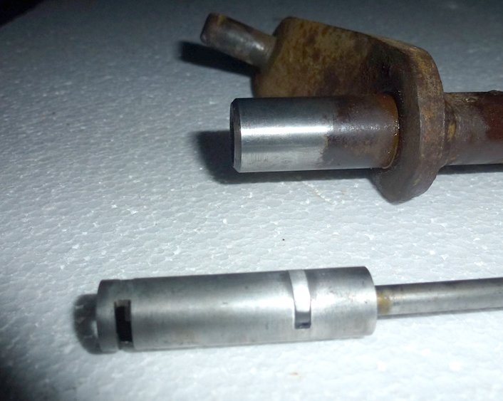

Here is what the piece should look like. If anyone has one or knows of where I can get one, please let me know!Thanks0
You need the rod also ?0
Not that I know of...do you have the piece I need?0
