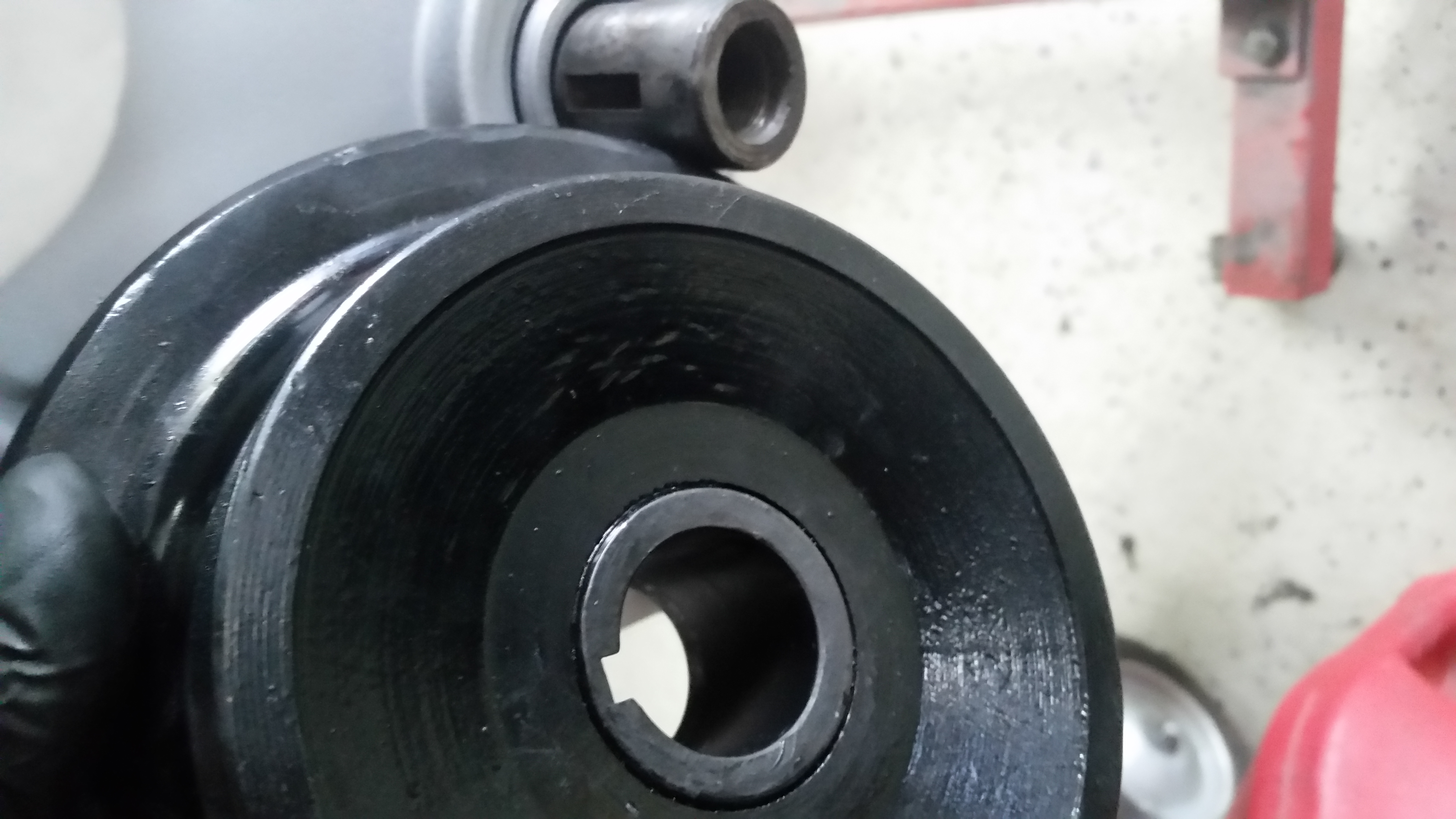

Need 212 crankshaft bolt
Which bolt? Flywheel, connecting rod, Vibration Dampener?0
Crank pulley bolt0
It's 3/4-16 UNF, but the original capscrew (most would call it a bolt) has a special head with 1-1/2 inch hex. Seems to me there were 1-7/16 hex-heads on early engines. The head is large so that it bears on the outer body of the dampener and not on the crankshaft end. Those are two separate parts that must remain independent of one another for the dampener to work correctly.
F
Thanks for the reply. I would need that bolt plus the locking washer that locks the pulley to the shaft where it is grooved as the machine shop lost the original ones it had.
Yikes!!! Senior Moment Alert!!! I just re-read my post and realized that I said the exact opposite of what I meant. It should have read ".......not on the body , but only on the hub of the dampener/damper." Note in your photo that the hub protrudes slightly beyond the body. This is by design so as to allow independent movement of those two parts.
I'm sure someone will jump in and supply you with the bolt/washer.
