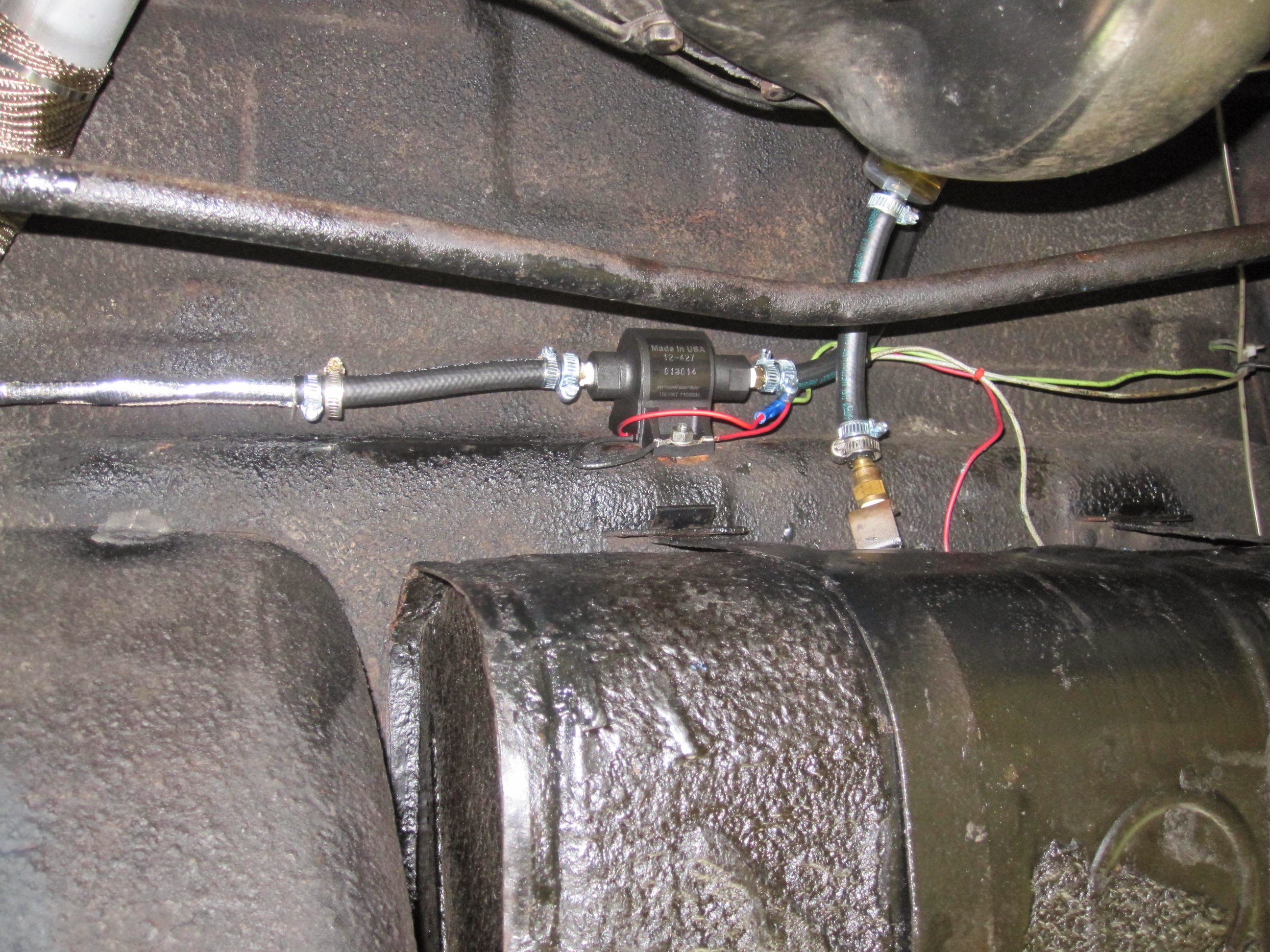

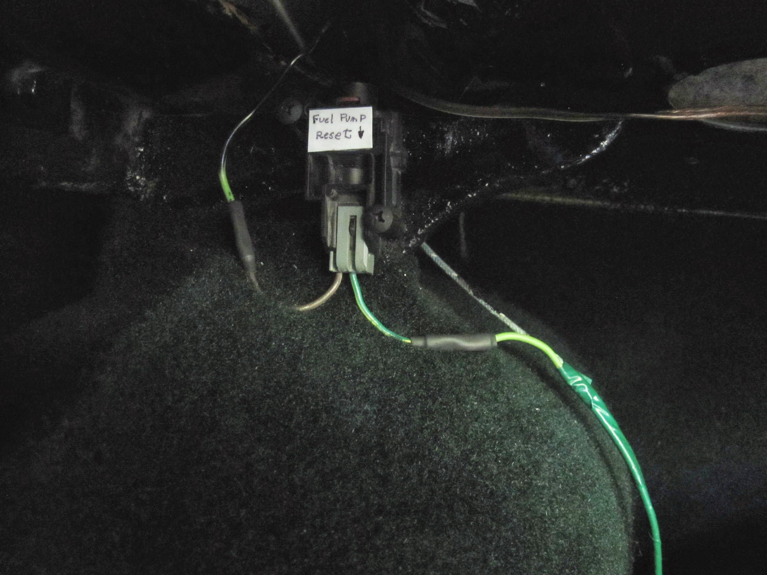

My HOLLEY elec pump { looking straight up}; also the FMco elec fuel pump safety shut off mounted in trunk. Pump for prime and backup; if mech. fails(not ruptured diaphragm) or vapor lock. Clear filter between tank and pump { I have lift so checking and changing is easy}. But I do want to drop tank, clean off undercoating, and finish in flat silver.0

I recommend an Airtex E8012 (12V). Install it in line as close to the fuel tank as possible. Watch out for the rear stabilizer bar. Run an electric line(14 Guage) from the ignition terminal on the key assembly to the pump and ground the pump as per instructions. These pumps are "free flow", that is, fuel will not be restricted when the auxiliary pump is off. That makes them perfect for priming. They are cheap,check on Ebay. BTW, place a ON/Off toggle switch between the IGN terminal and the pump.0
