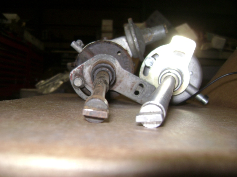

I was doing a Jeep F134 4cyl EFI conversion and picked up the distr to convert to electronic for the timing control.
When I pulled it out of the box a light bulb went off.

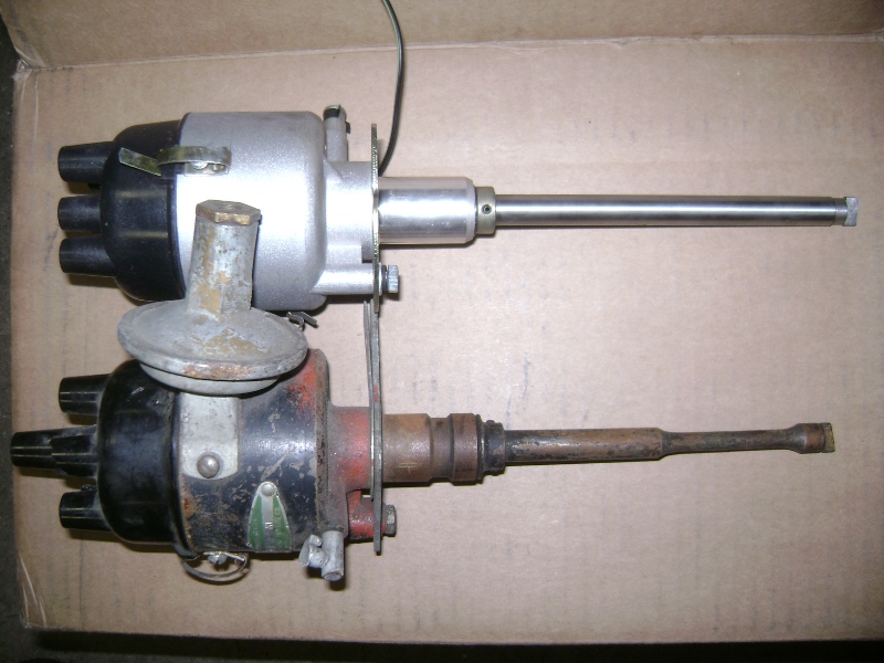

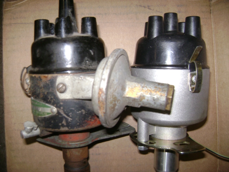

Most of the dimensions are the same except the shaft is about 1/2" longer.
So it may be an option to turn the center of the shaft down in dia to clear the cam and then just use a 1/2" spacer under the base.
Of course it's probably just as easy to weld up the slot drive tooth and then remachine it for a tighter fit.
I have several shafts with very worn drive ends on them that allow a lot of timing slop.
