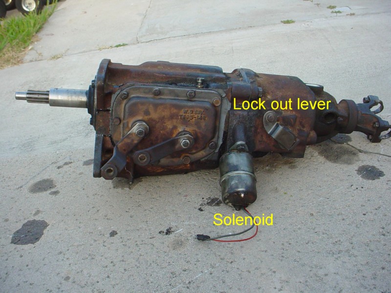

how do i tell if I have an over drive 3 speed manual transmission?
Yup 3 speed with overdrive0
If you have a 48-51 stepdown the transmission will only have one lever but will have the solenoid oldfarmer pictured0
