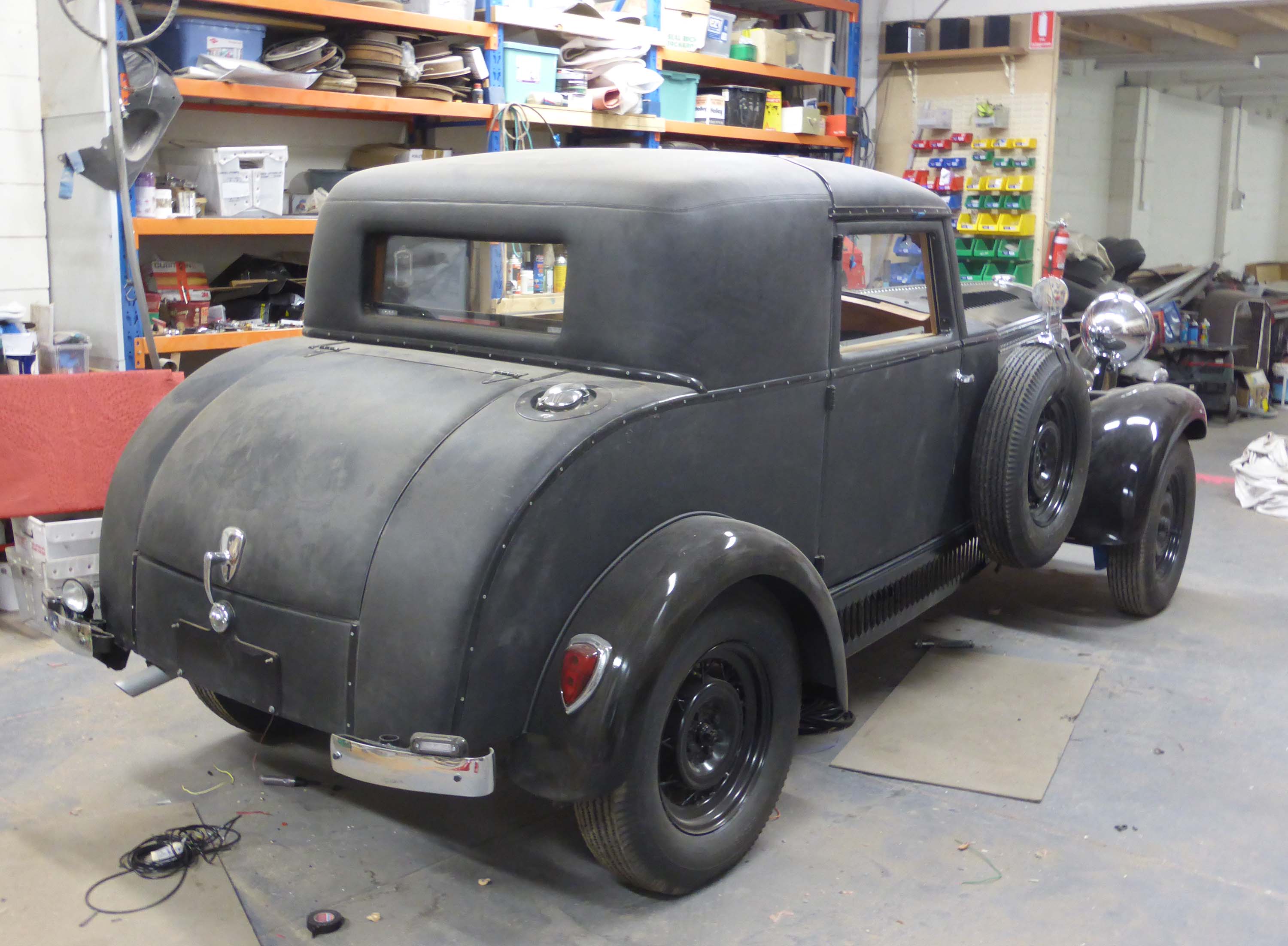

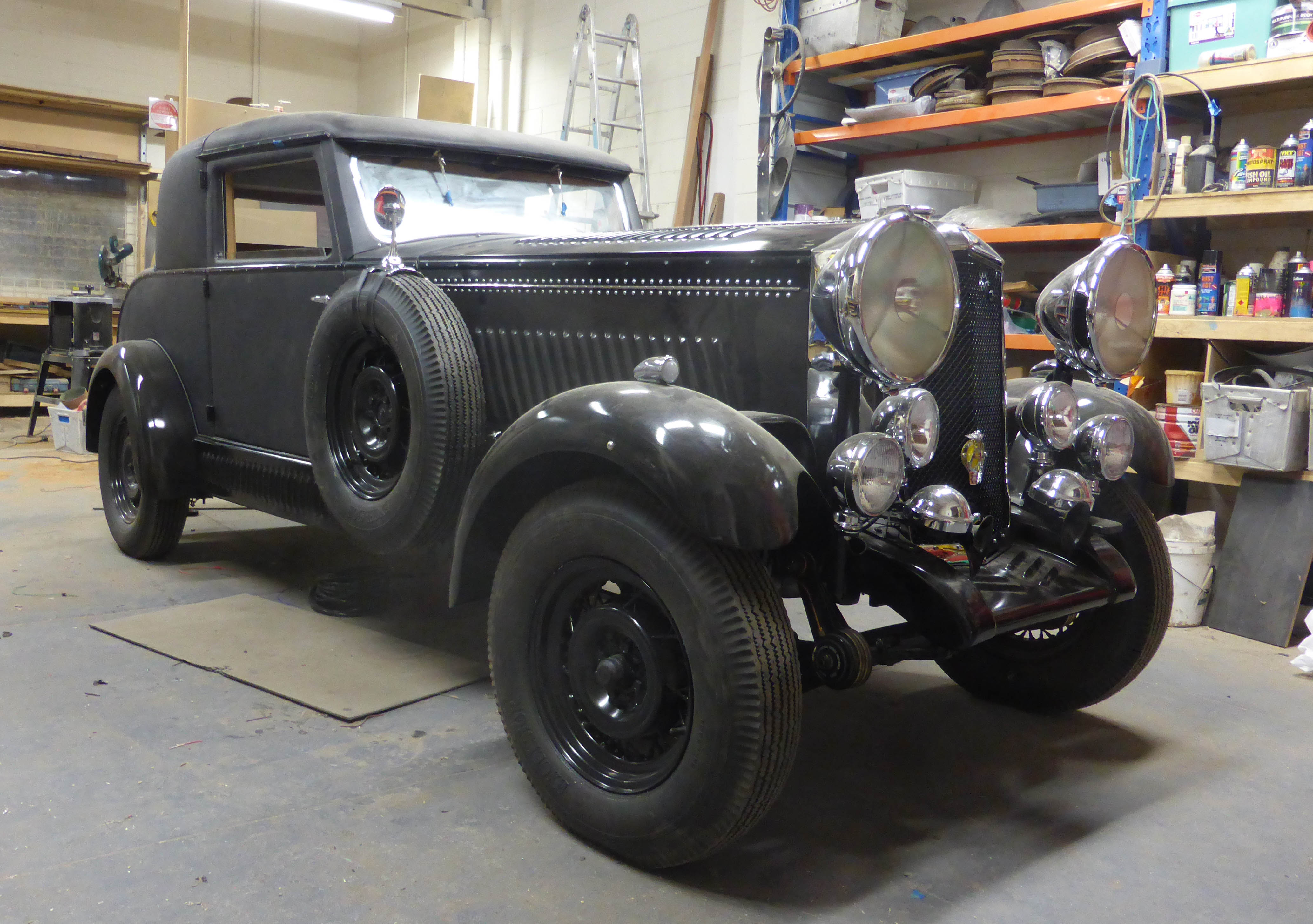

Nice looking car, Phil! My impression was that the eight cylinder engines were built for a long time ('30 through '52, right?) so one would assume the sump capacity (and the dipsticks) were unchanged during that time. Hard to think you have the wrong dipstick unless by some chance you have a Ford, Pontiac or other eight cylinder one by mistake.
