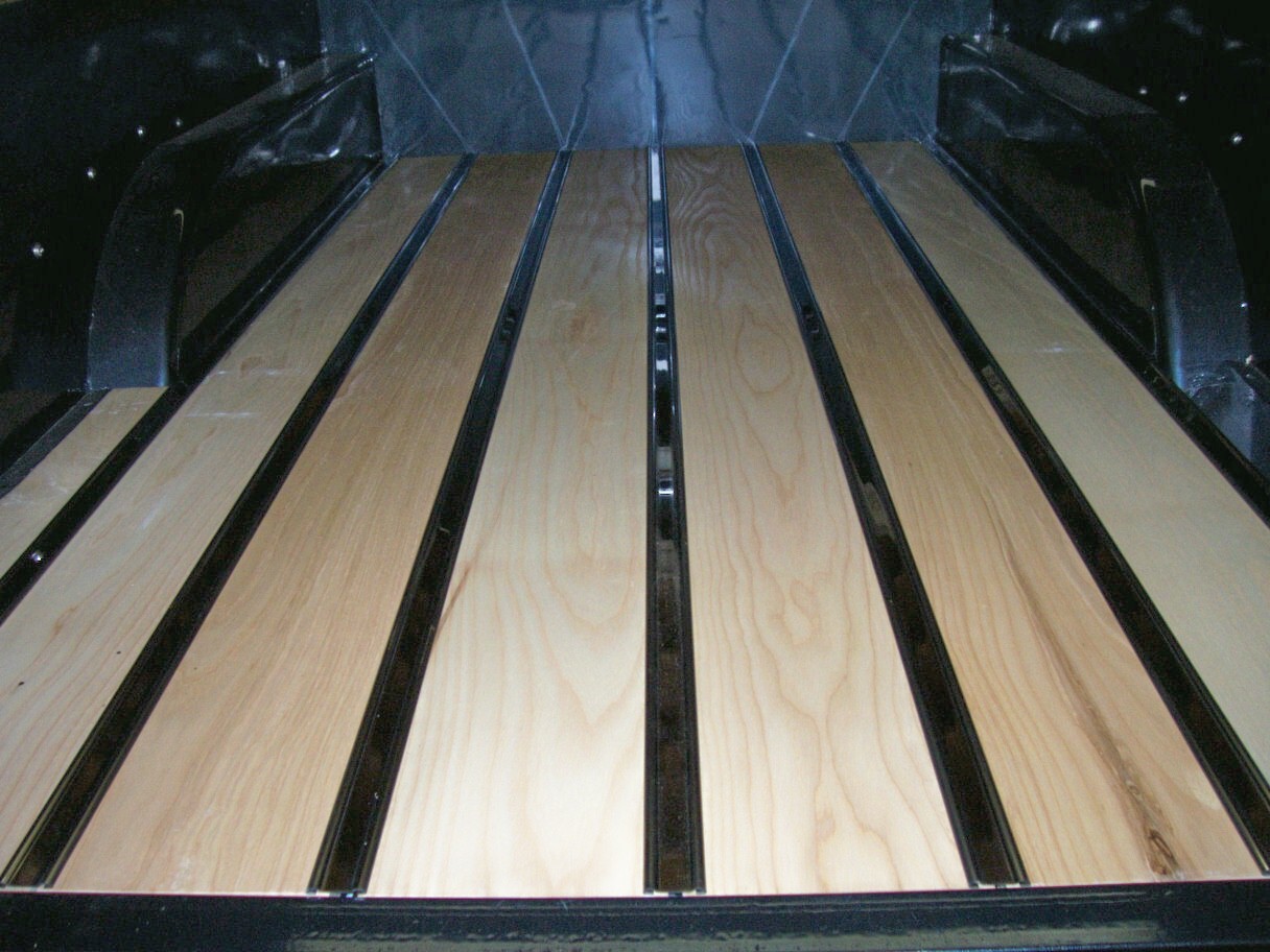

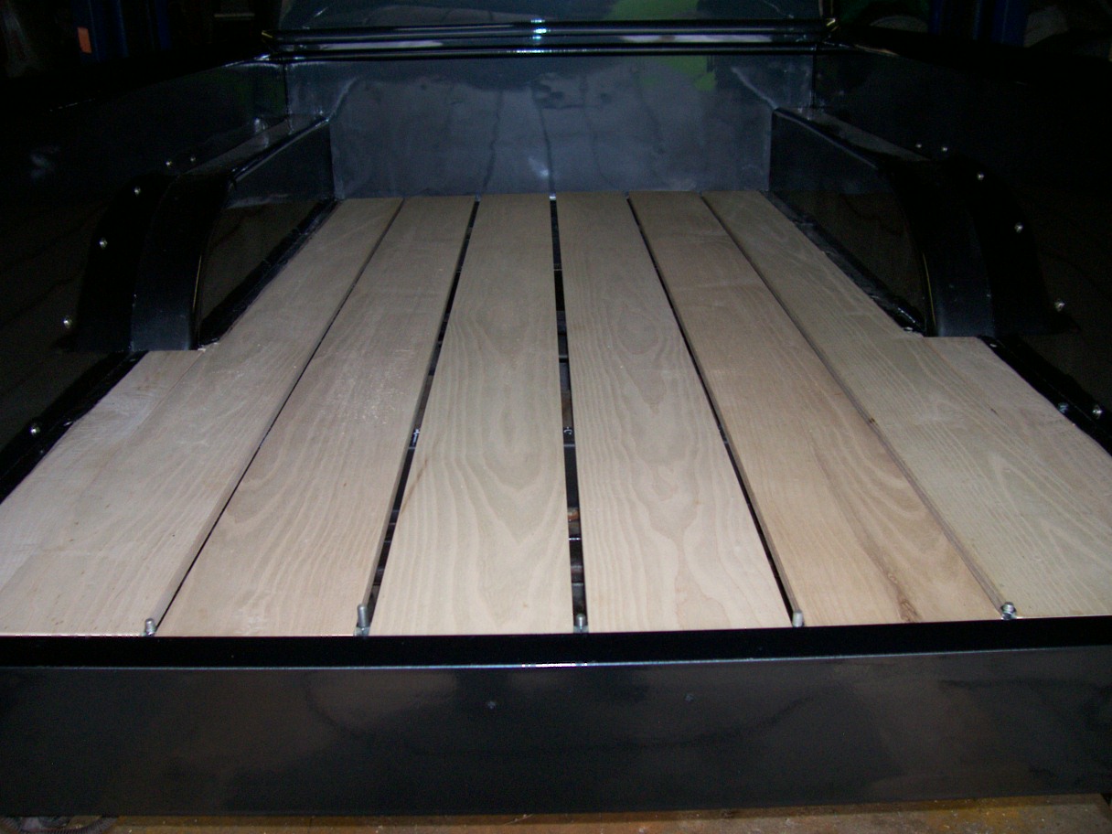

I got mine from John Pruitt @trucks usa 864-227-6220 he is great to work with. I used S/S strips with hidden fasteners.He cut to what ever length you want. Ron
