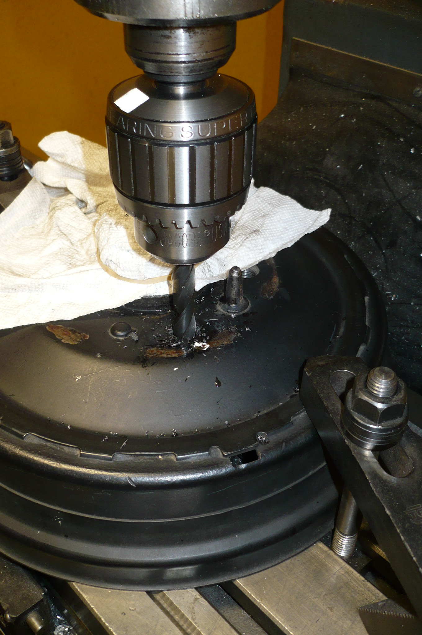

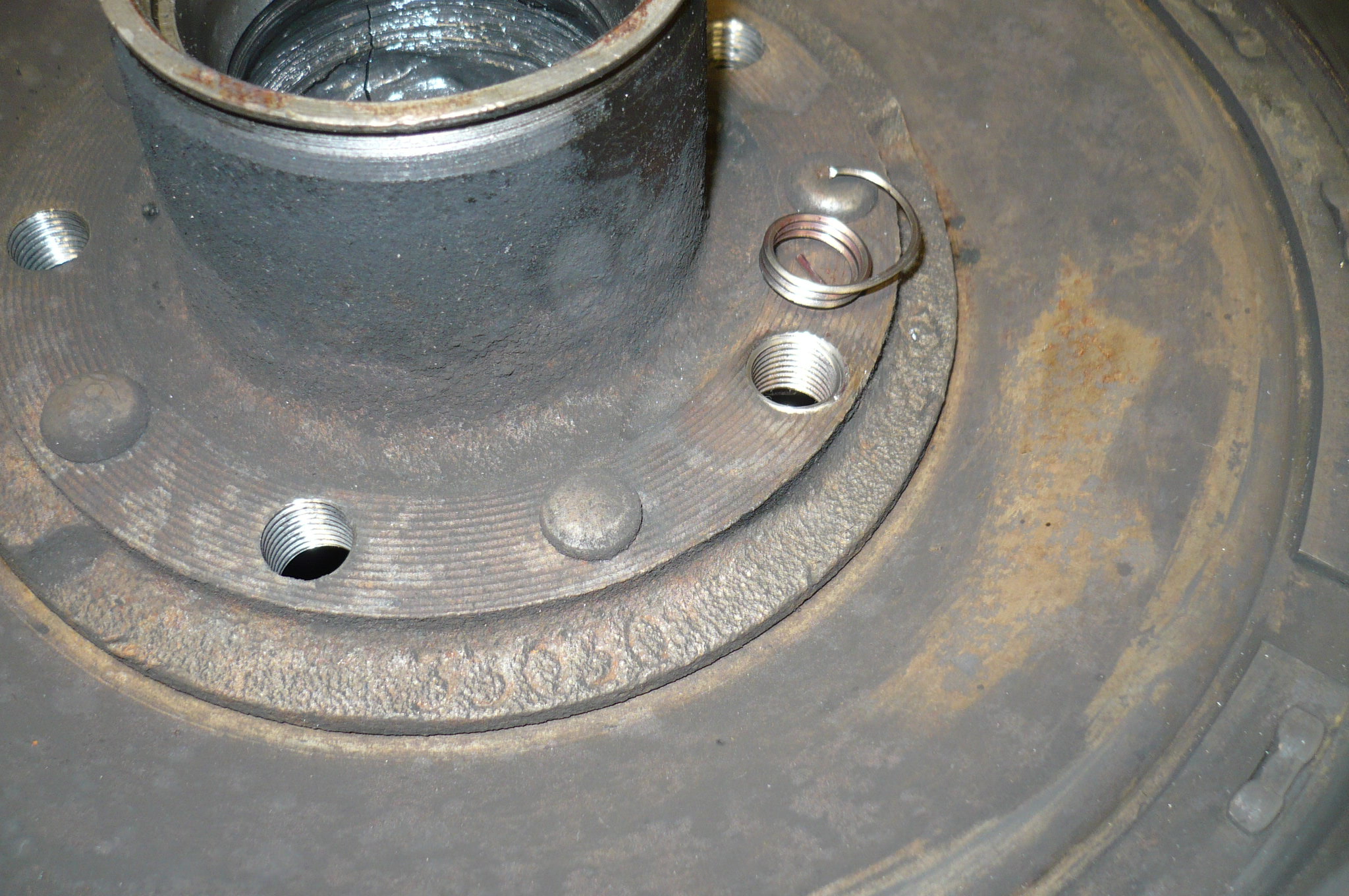

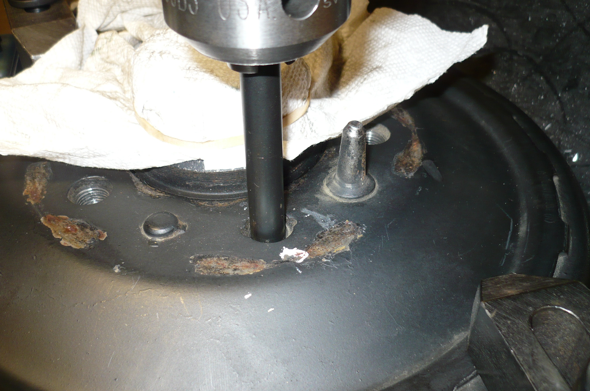

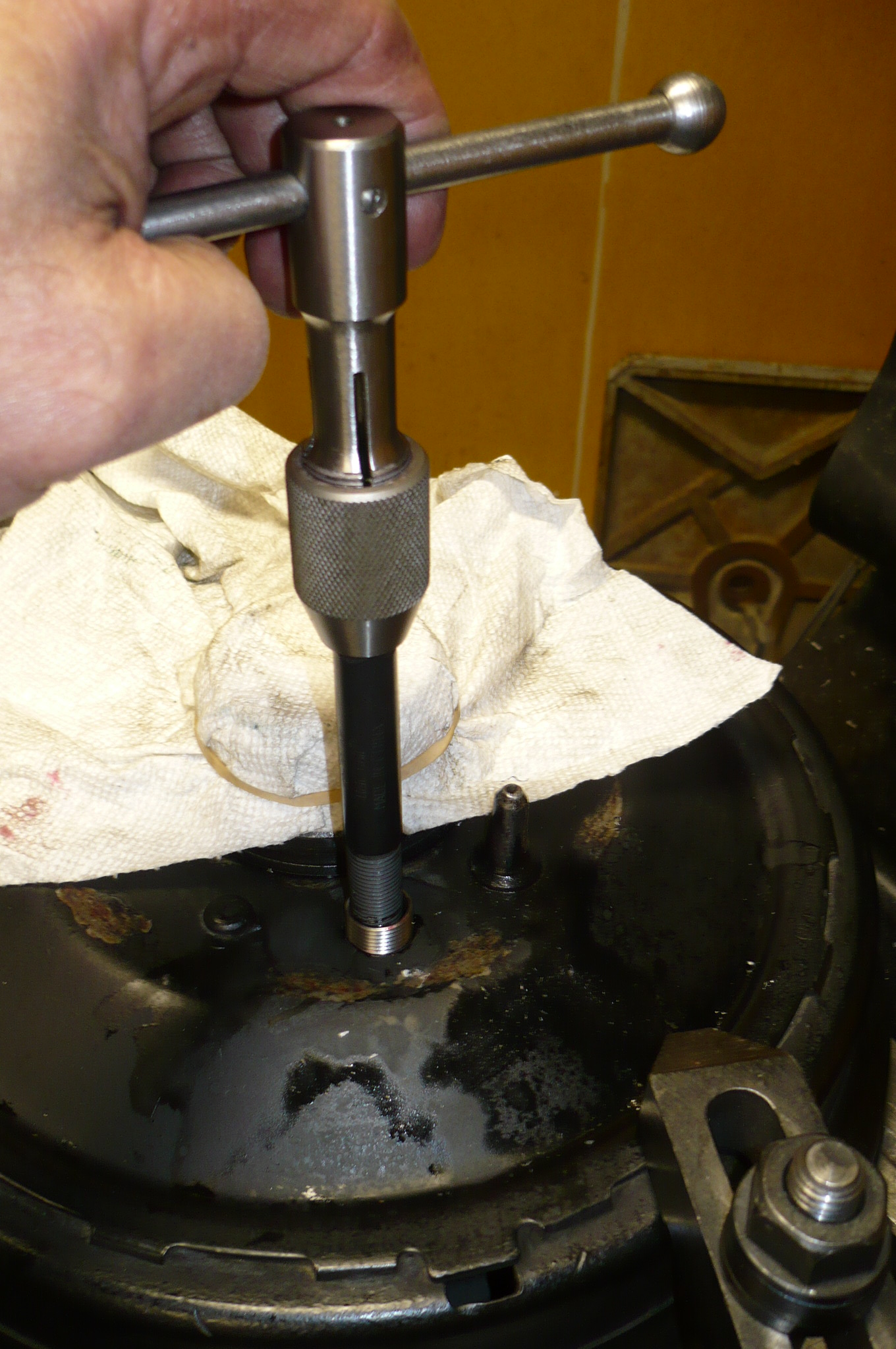

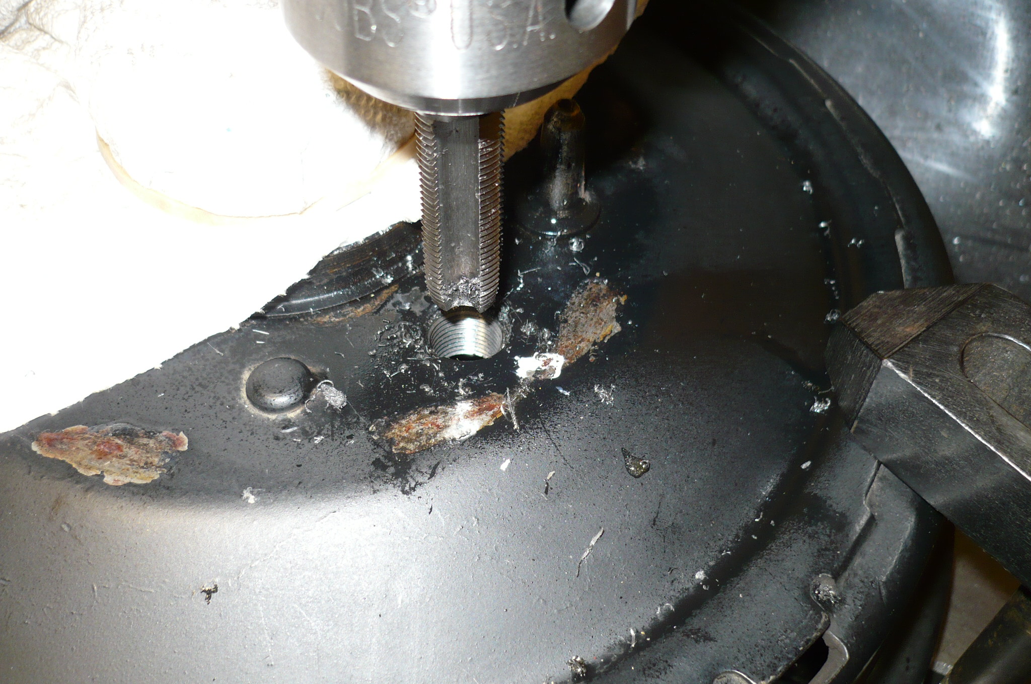

Of course, I can't speak to the availability of Heli-coil or other such thread repair products where you are, but I have done a couple of these on our Hornet recently.
When you get the hub removed (and you eventually will) The attached photos are of the latest repair job.
796) Using a transfer punch to position the drill chuck over the center of the faulty hole.
797, 98, 99,) Tap drilling for Helicoil tap, tapping and installing the Helicoil with high strength Loctite.
800) Trim off excess on the inside.
I would highly recommend NOT attempting the tap drilling operation freehand. That risks a broken wrist, or worse yet, a broken drill.
