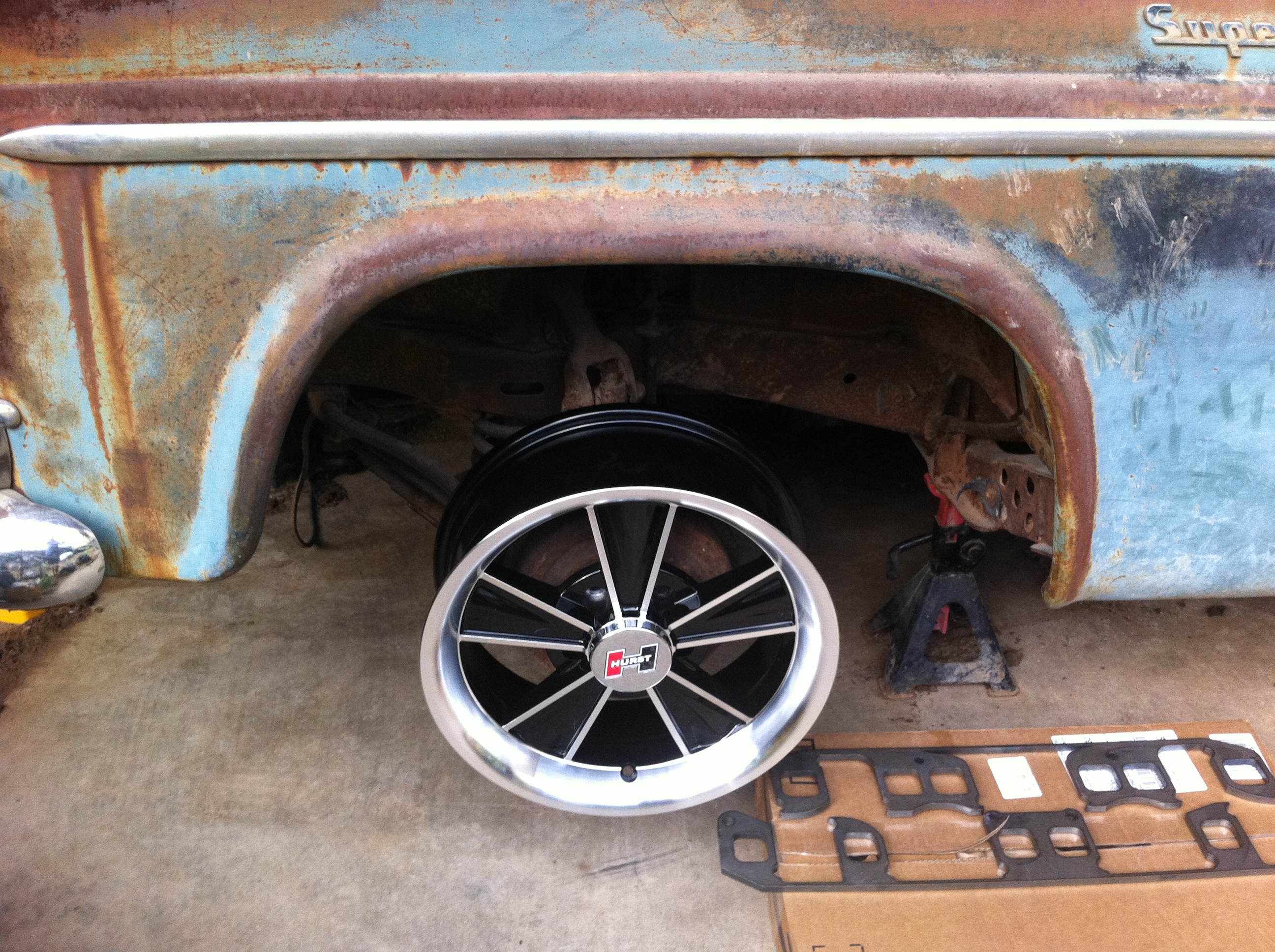

I've got some 15X6 Hurst wheels for the front of my 308 powered Jet. What would be a good size for the front tires? What's the largest size that would fit on the rear? Don't really want to do any cutting on the rear fender wells. I haven't bought the rear wheels yet, can get either 15X6 or 15X7. Getting ready to start on the front end too, rebuilding with new/N.O.S. parts but switching to disc brakes and using KYB Gas-A-Just shocks. Thanks, David

I am using the Hurst wheels because I think they look good on the car, they are similar to the ones my brother ran on his '55 Bel Air. The Hurst 15X6 wheels have 3.50 backspacing, the 15X7 have 3.98. I was hunting a good set of original Hurst wheels but they are hard to find and HIGH. I found new ones for $109 and decided to get them. It took me 5 years to find a good 2 door Jet to build. Has taken a while to find a good '55 block to build. It will end up being LOTS more expensive to build the 308 rather than swapping a newer engine in, just want to go with the 308. I am hoping to have it ready for the 2018 H.E.T. Nationals in Wisconsin. Thanks,David
I'm running 14 x 5.5" on my jet - the standard wheel from a '66-'67 Dodge Cornet w/6.50 x 14 bias ply tires. Don't have any clearance problems at the rear with factory skirts, and no rubbing of the suspension or the inner or outer fenders on the front.
