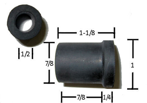

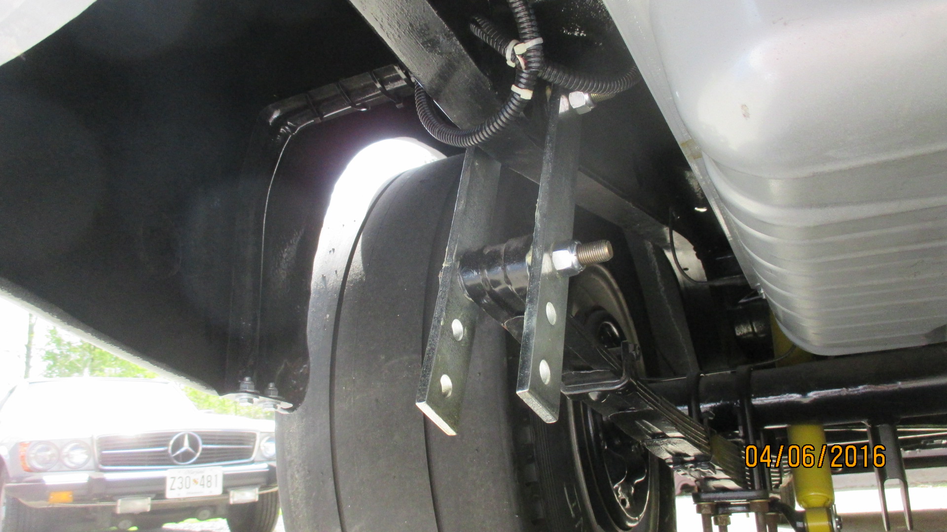

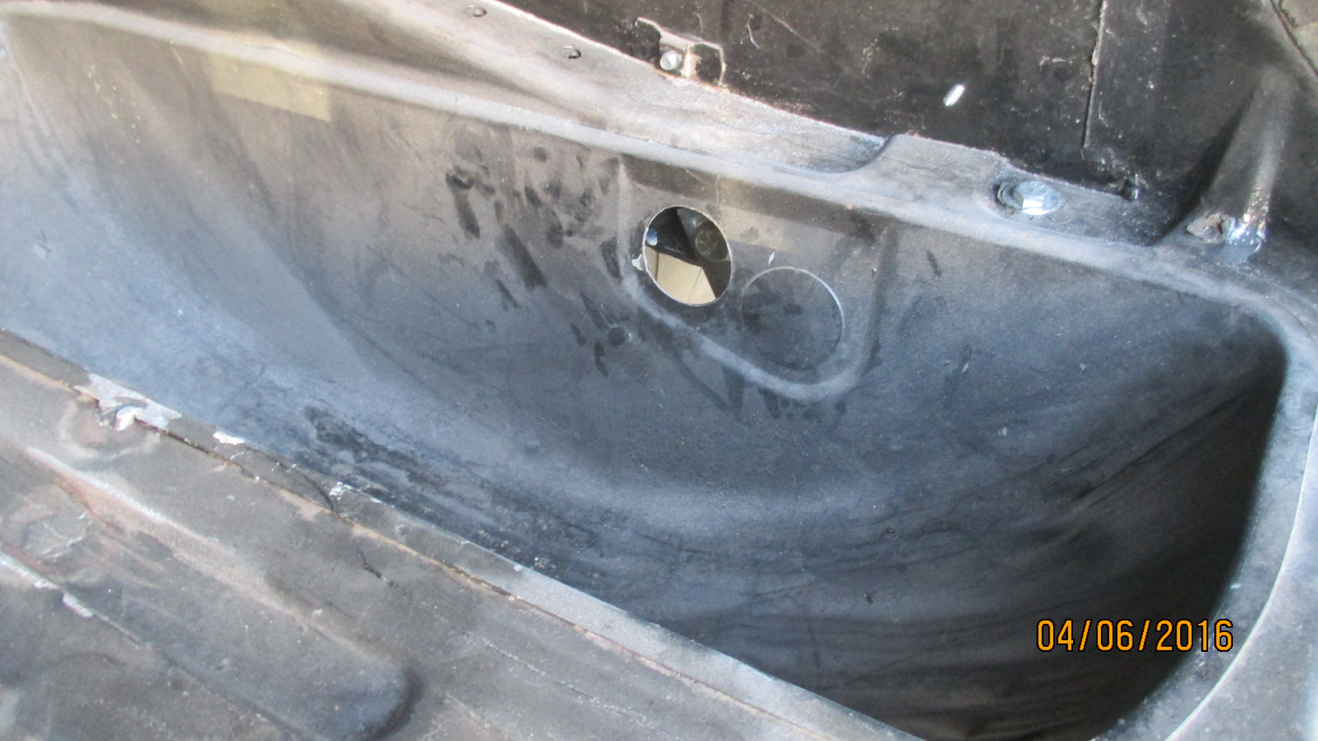

AgreeThe bushings I got from a trailer supply store 1/2 ID, 7/8 OD 1-1/8 overall length with shoulder (2 sides per 8 total).Bought a shackle kit (Superior 13-4000) due to cost and ease of install. I bought new bolts as kit bolts were long.Tricky part is passenger side top. Many may not realize that the "raised" circle on the inner spare tire well is a "punchout" similar to an electrical box. I was prepared to hole saw it but while I waited for my 90 degree drill to charge I wrenched the upper out popping it clean.0
