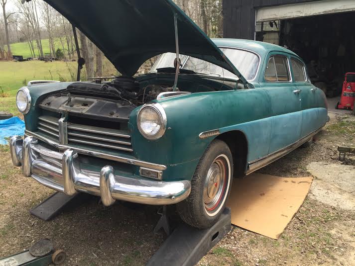

I'm a life long collector/restorer, but I've never owned a Hudson, but I have admired and been around them since the 1950s. My friend has a 48 Commodore 6 sedan, now running. Life got in his way and the car has not been driven in 6-8 yrs. It's a pretty solid car. Still has decent original interior. Appears to have vacuum shift, overdrive, and I'm guessing a stuck clutch.
To my knowledge there are no Hudson guys around Bowling Green KY to ask. Another friend has gotten it out of the barn and removed the inspection cover. I expect we need to drain and flush this clutch, maybe several times and hope it will free. He can do the work.
Can anyone help with instructions.?
Thanks for your help!
