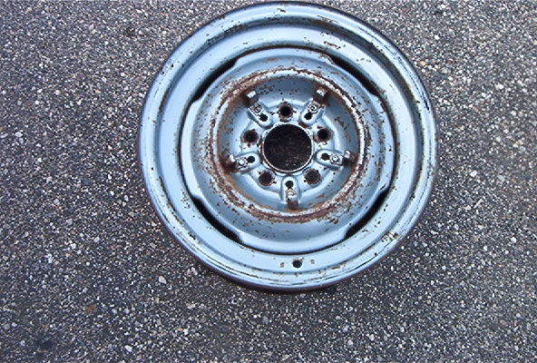

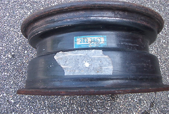

I found this wheel in the trunk of a 1970's Grand Fury at an area U-Pull parts yard. Not sure of application but it is a 15x6 and fits fine on my Hudson. Tried to find application using the MOPAR part # but no luck.The Hudson small and large caps fit fine.0
I used mid 70,s new Yorker wheels on a Hudson and they worked fine. Don,t remember the width tho. Dodge truck changed from 5x41/2 to 5x5/12 bolt pattern in 1985., but they are heavy.0
Thanks, Ken, maybe I will find some more. Will keep looking."Ric"0
Ken, thanks for the photo and information.Ric, thanks for the photo.With your help. That makes it easier to find the wheels to look for..Lee O'Dell0
