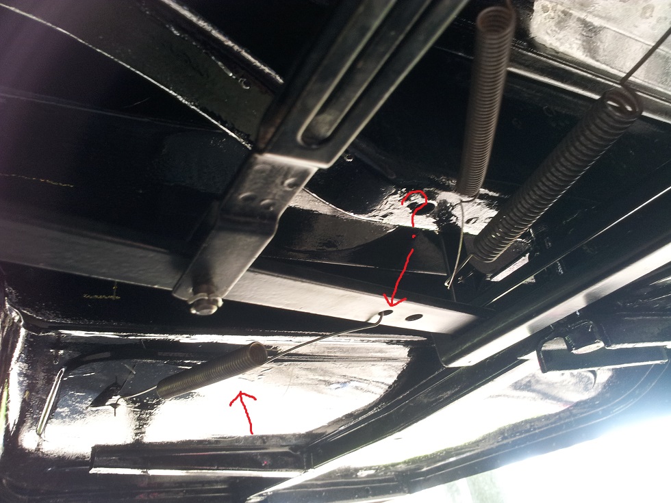

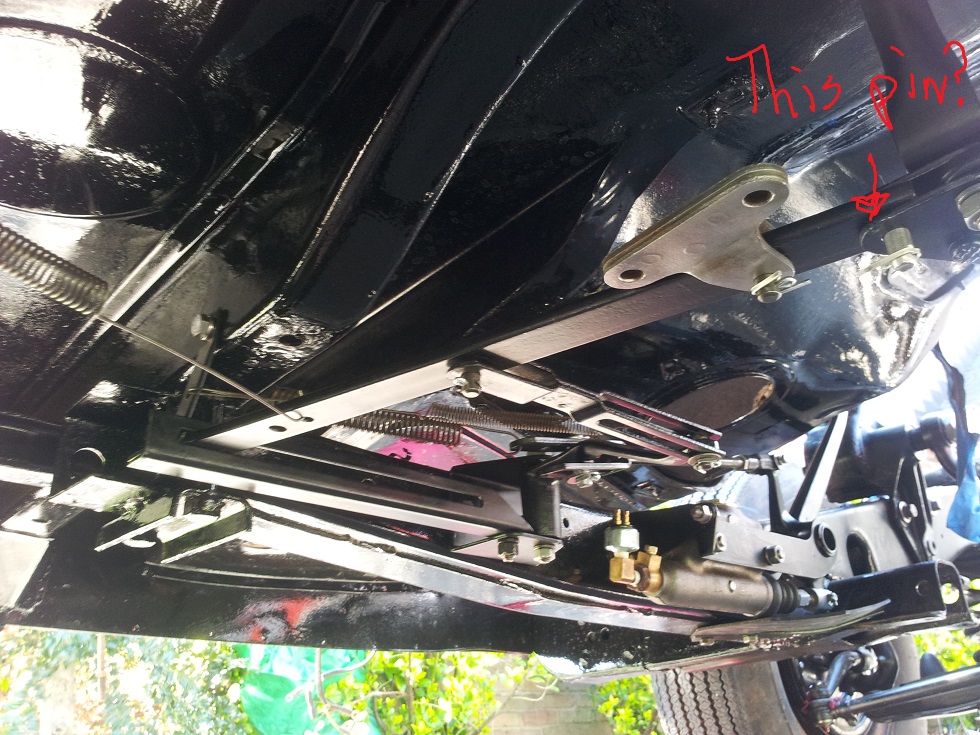

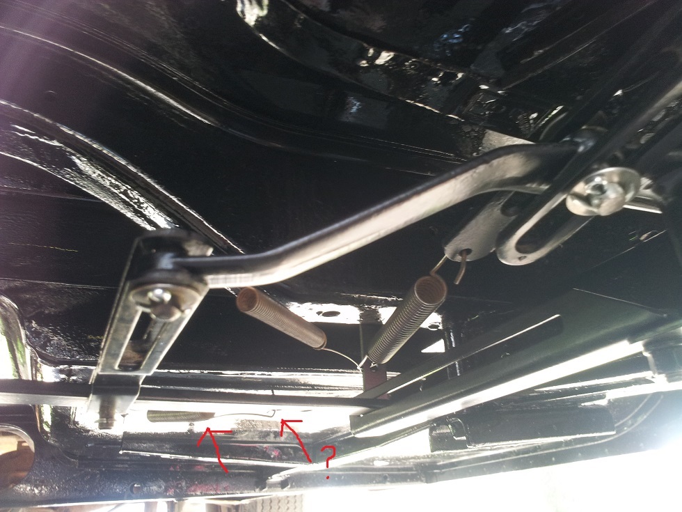

Hey all... The phone that had the pictures of everything before take down died along with all the photos. The book is not much help and can't seem to find any good photos online. The e-brake cable clevis is not attached along with the rear brake cable clevises.
1. Is the return spring in the right location?
2. The pivot point... is that supposed to be a pin or bolt?
3. Anything wrong?
Thanks all!

Thanks Doc... I do have one of those thin tabs. Hopefully will get to the bottom one way or another.John... The springs cleaned up great with just a wire wheel. Might want to try it until a replacement is found.-Ray0
Agree with Ken. It's a clevis pin with a cotter pin to hold it in. Springs look good.0
