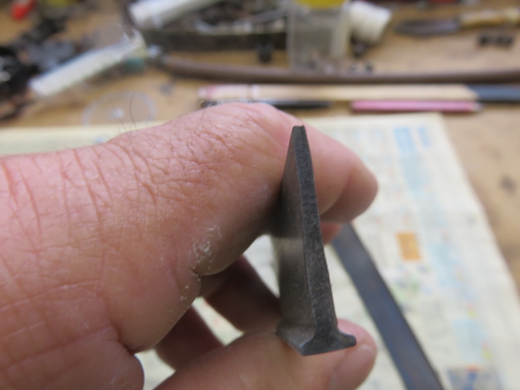

Glad you commented Ernie, may be you can help.My 1928 Australian bodied phaeton has a windscreen that opens. The rubber that is inserted in the bottom edge of the screen and rests upon the scuttle when the screen is closed needs replacement. I don't know what the shape of the rubber is where it is inside the screen frame. Also as it looks original, I don't want to start pulling at it until I know more about it's fixing. Any advice welcome.Thanks in advance.By the way, belated happy birthday to Geoff Clark if he reads this!0

I will take a photo to show the profile and post later but it is basically just a T shape - I also got that from Para Rubber

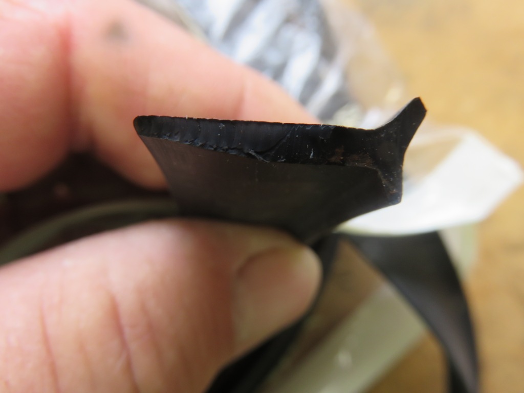

RogThis is what I got from Para Rubber and is currently installed on the cars. Works just fine.The next photo is of some (slightly different profile) I had acquired through a friend (I think Geoff Clark) which I am keeping for future use. I am not totally sure where he got it from but possibly K-Gap when they were operating.I hope this helps and sorry for the delay.Alistair
Thanks so much for the photos Alastair. They make the profile very clear. I will see if I can find a supplier a bit nearer than NZ!0
