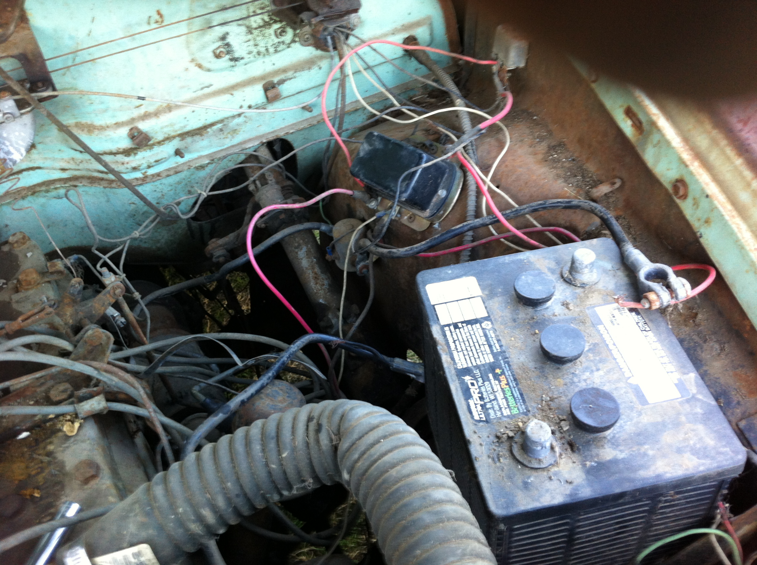

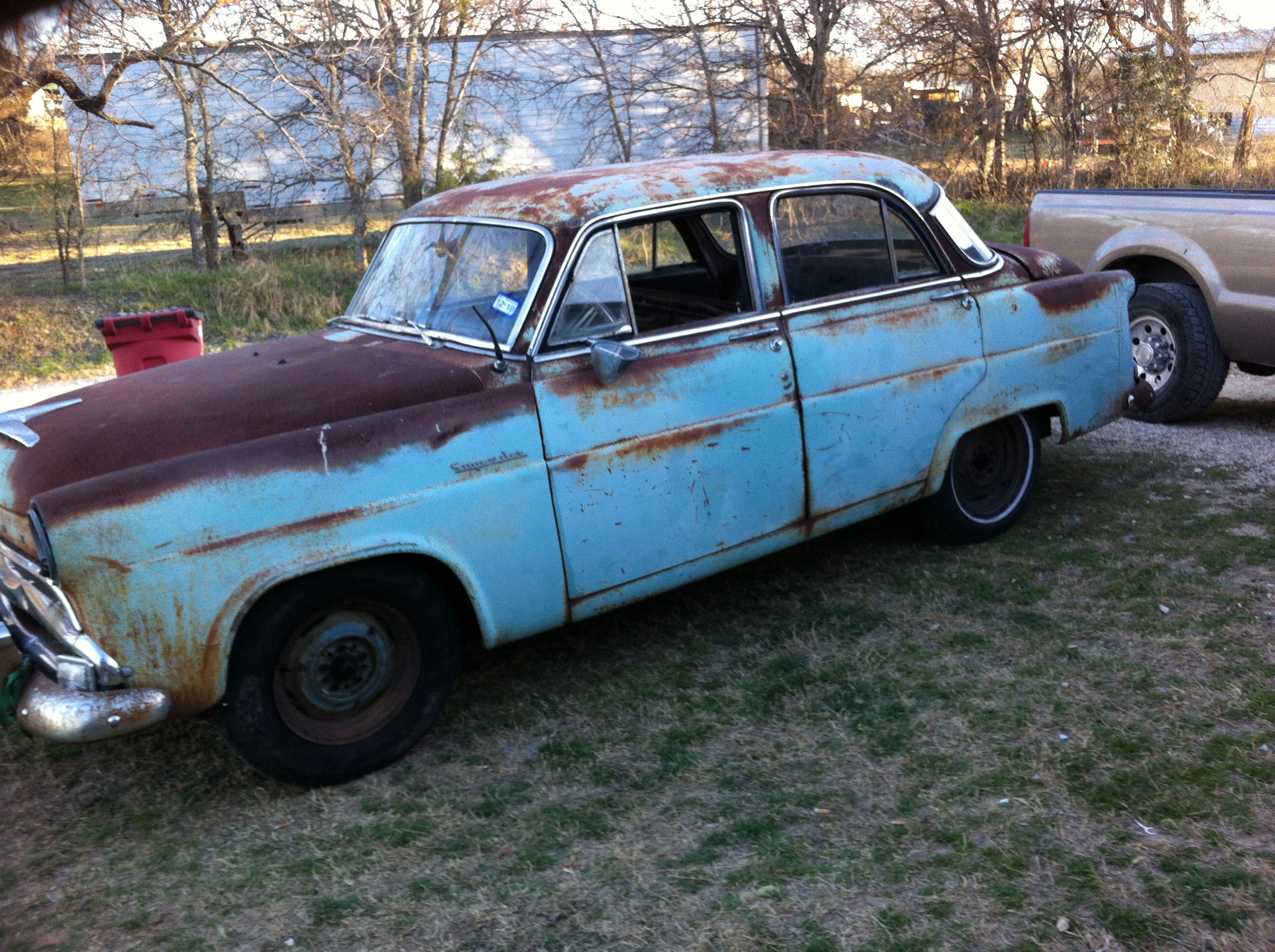

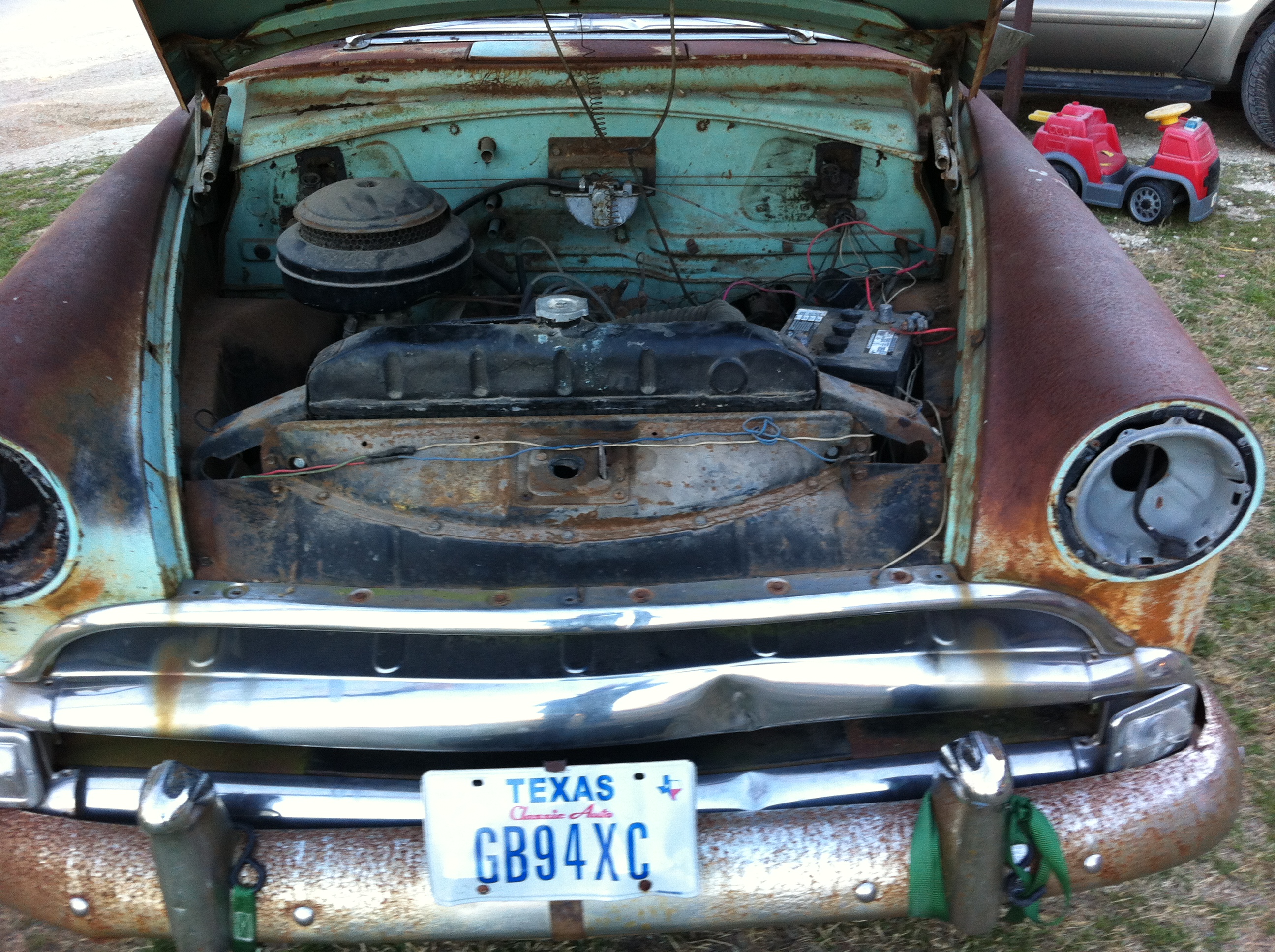

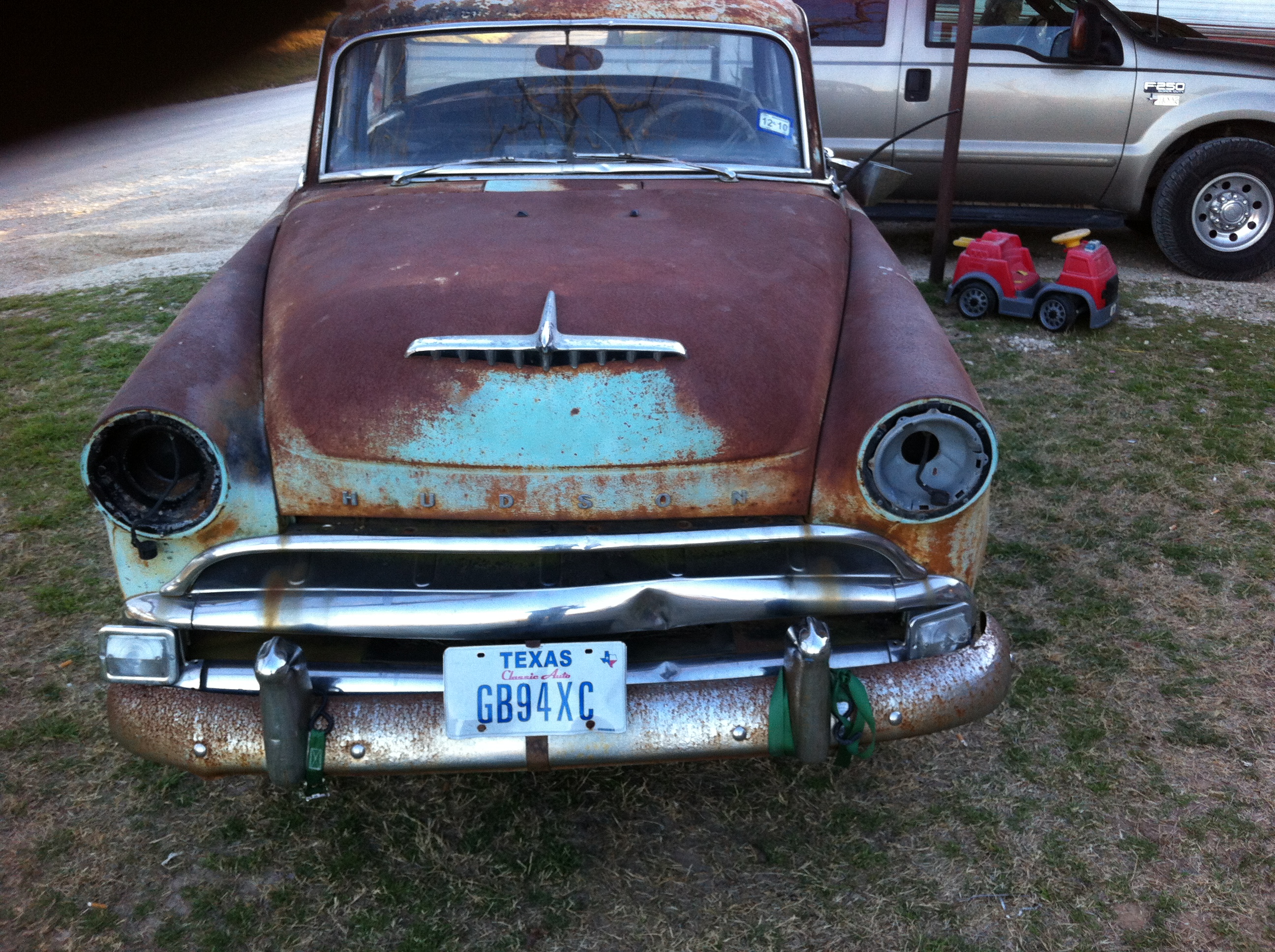

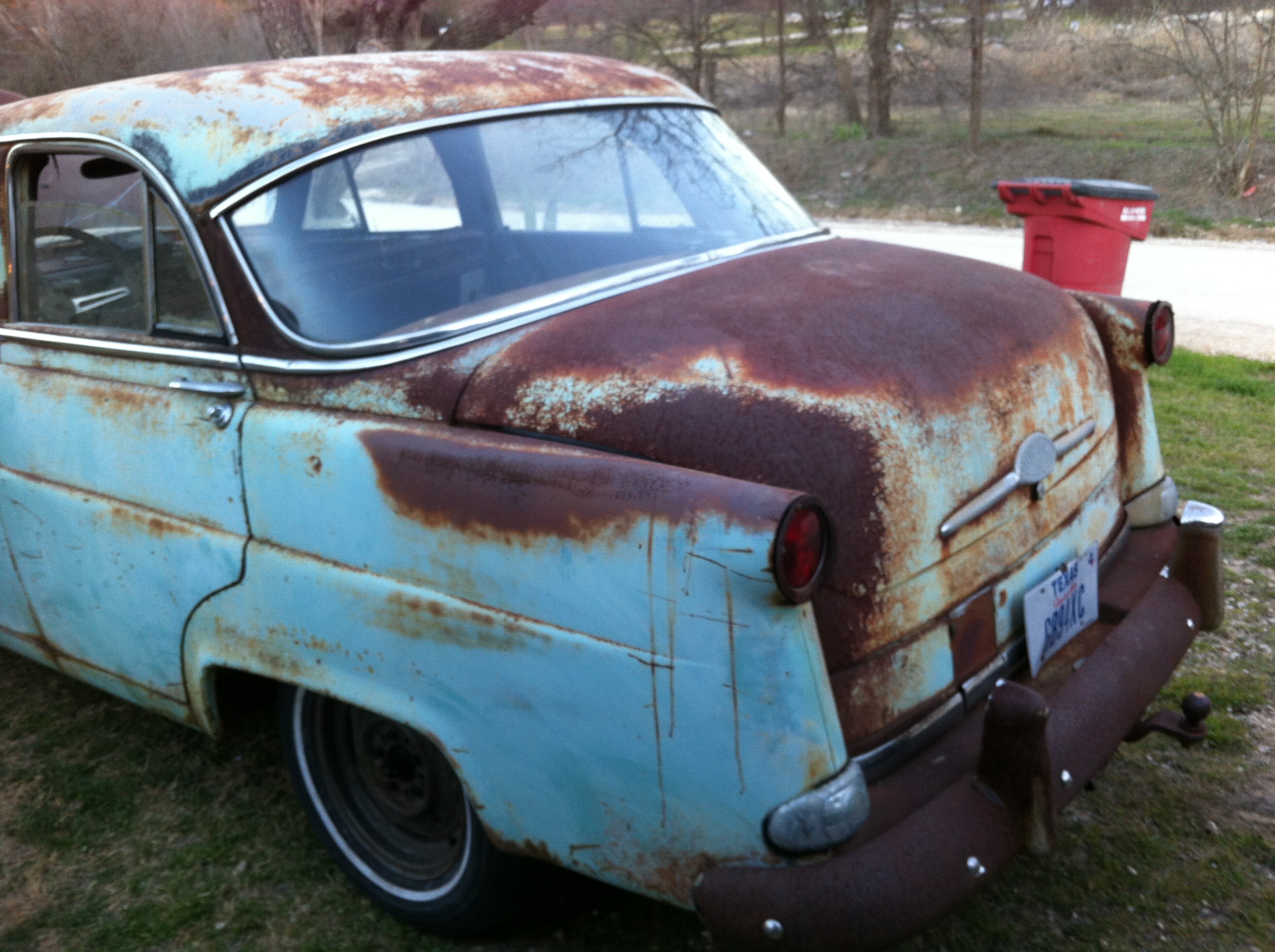

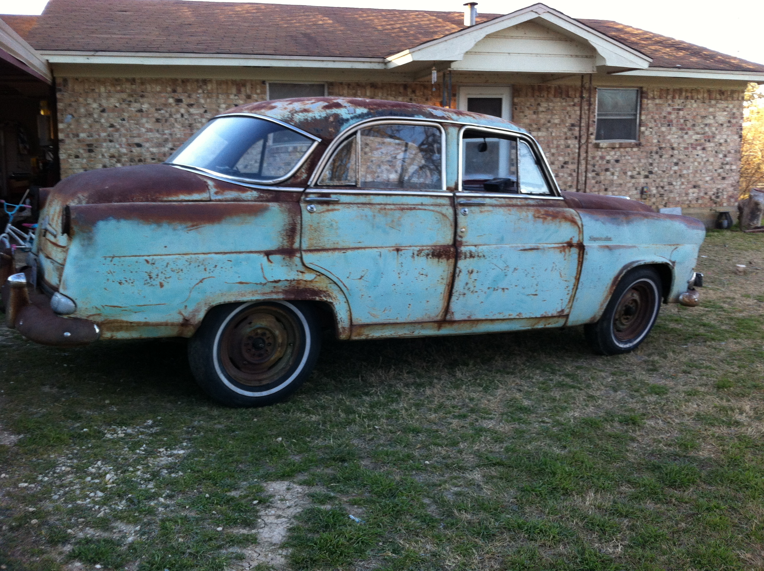

I had a friend call me this past Sunday and ask me if I was going to buy the $100 Hudson 4 door Super Jet on Craigslist. Since I just bought a '54 Super Jet 2 door last month I haven't been following Craigslist much lately. I e-mailed the owner and luckily it was still for sale, so I told her I would take it and off to Austin I went. She said the car had been running in 2011 but her brother attempted to re-wire the car and got frustrated and parked it. I am going to try and figure out the wiring mess and see if I can get it to start, the engine turns over by hand. David
Wow, at a price like that you can't lose. Probably worth it in salvageable parts, alone, and then you can sell the rest to a junkyard. However, if that's just surface rust, it could be a keeper. The fact that it ran just five years ago, is a hopeful sign. Looking at the taillights, I'm guessing that the previous owner may not have tapped into the vast resources of the Hudson World, else he / she would have at least found some "serviceable" used Jet lenses!

It has several parts that are missing on my '54 2 door, like the air cleaner and throttle linkage pieces. Plus my engine is stuck, so I may end up having to use this 202. Mines a standard, so maybe the Hydramatic transmission can help another Jet owner out. It looks rough on the outside but the underneath is just about rust free. David

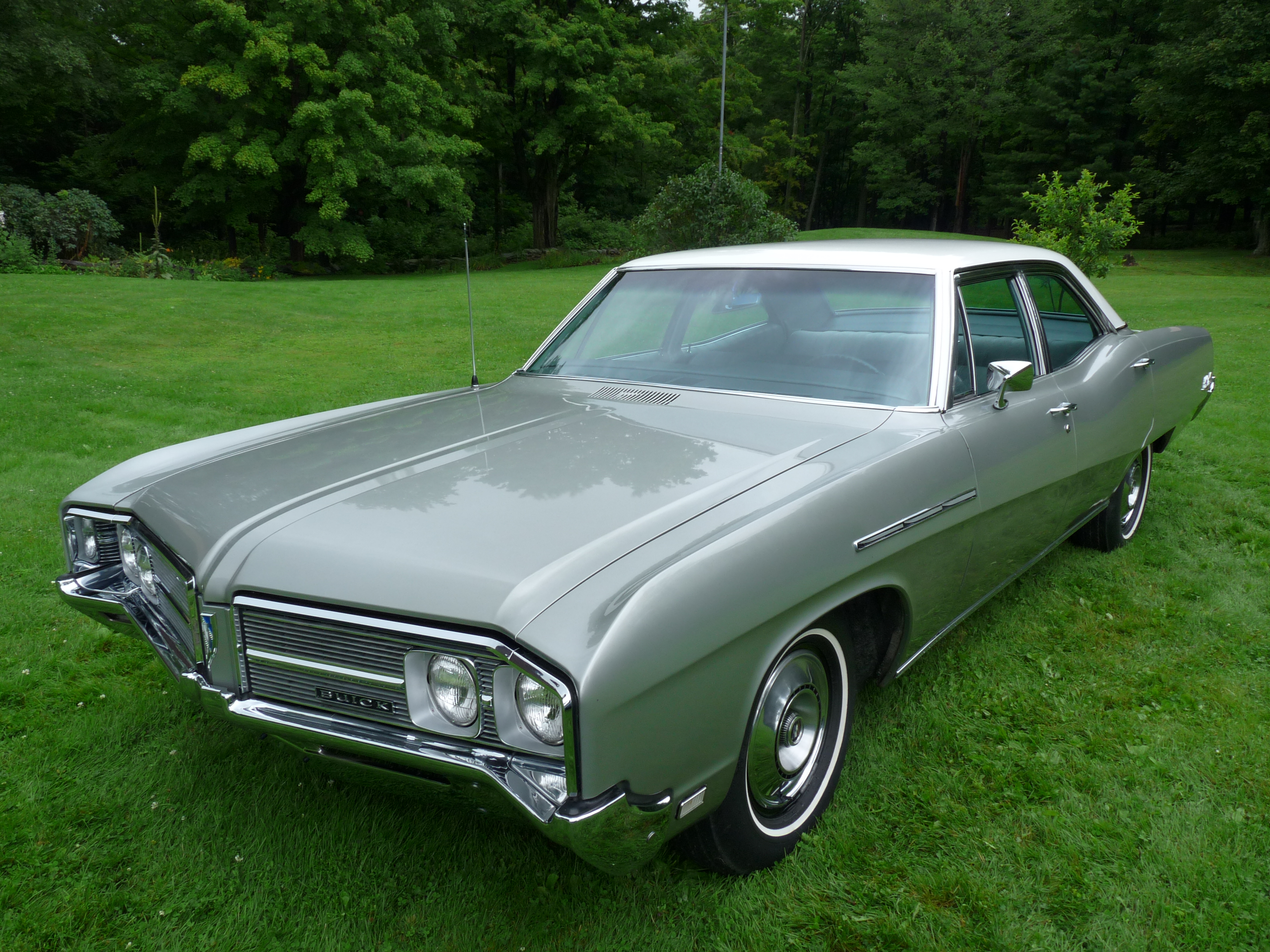

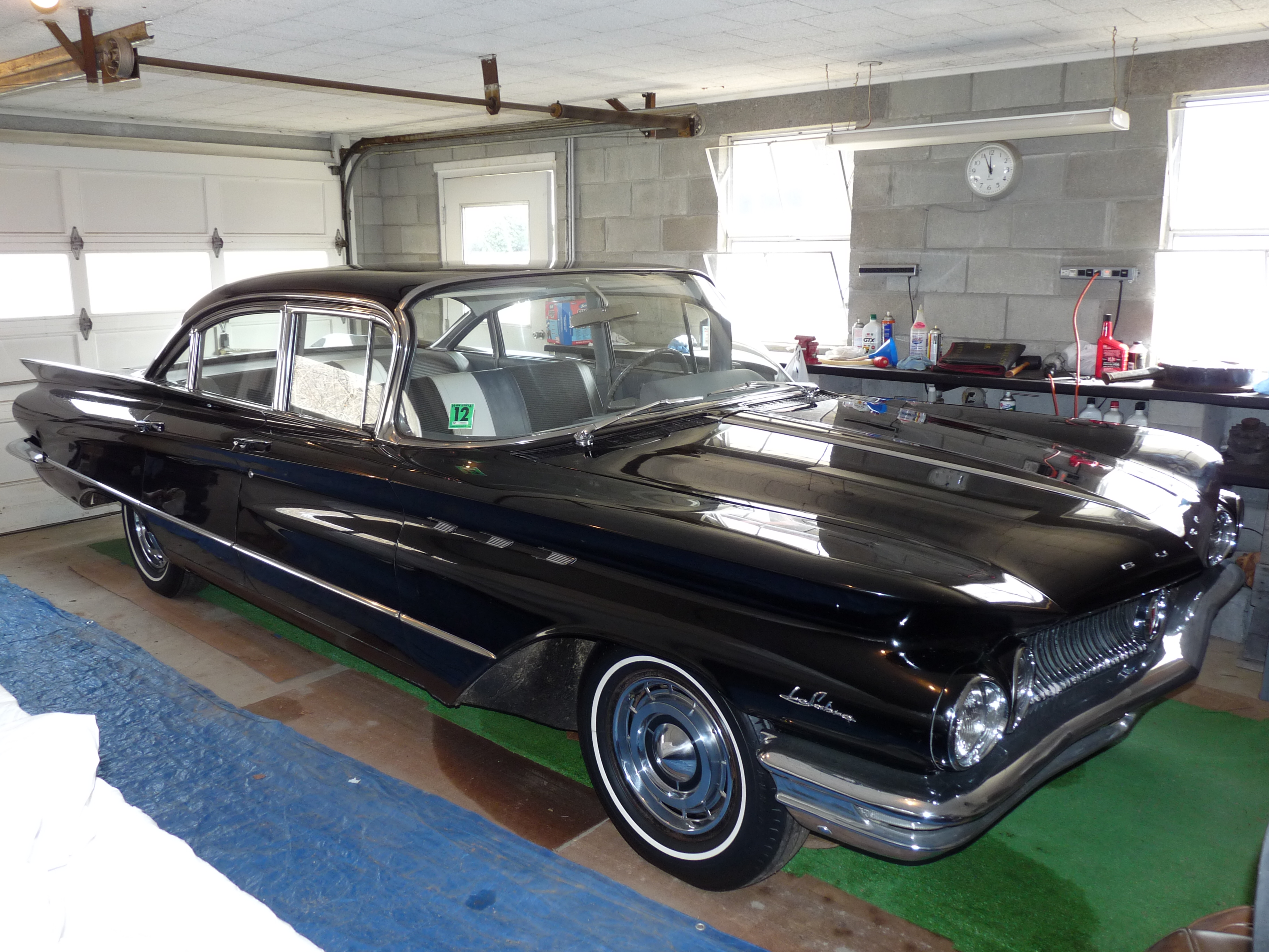

I thought I'd share my last two saves,the '68 LeSabre was parked 20 years with 17,000 miles and two mechanics gave up trying to free.I used Marvel Mystery Oil,poured in each cylinder and put plugs back,then poured in to oil fill until it wouldn't take any more,it took almost 7 qts.Then checked every couple weeks adding a little as it seeped through.I let it set for 6 months,then let drain for one week.I changed the plugs and cleaned all the original ignition parts,got in and the starter broke it free and she started.The neighbors came running because they thought the garage was on fire from all the smoke.10 minutes later drove it around the block on the original tires.The '60 LeSabre was parked for 35 years with 49,000,this time I used Kroil doing the same thing,but sat for one year.Started and drove away.Kroil can be bought from www.Kanolabs.com.Use it all the time,wouldn't be without.0
