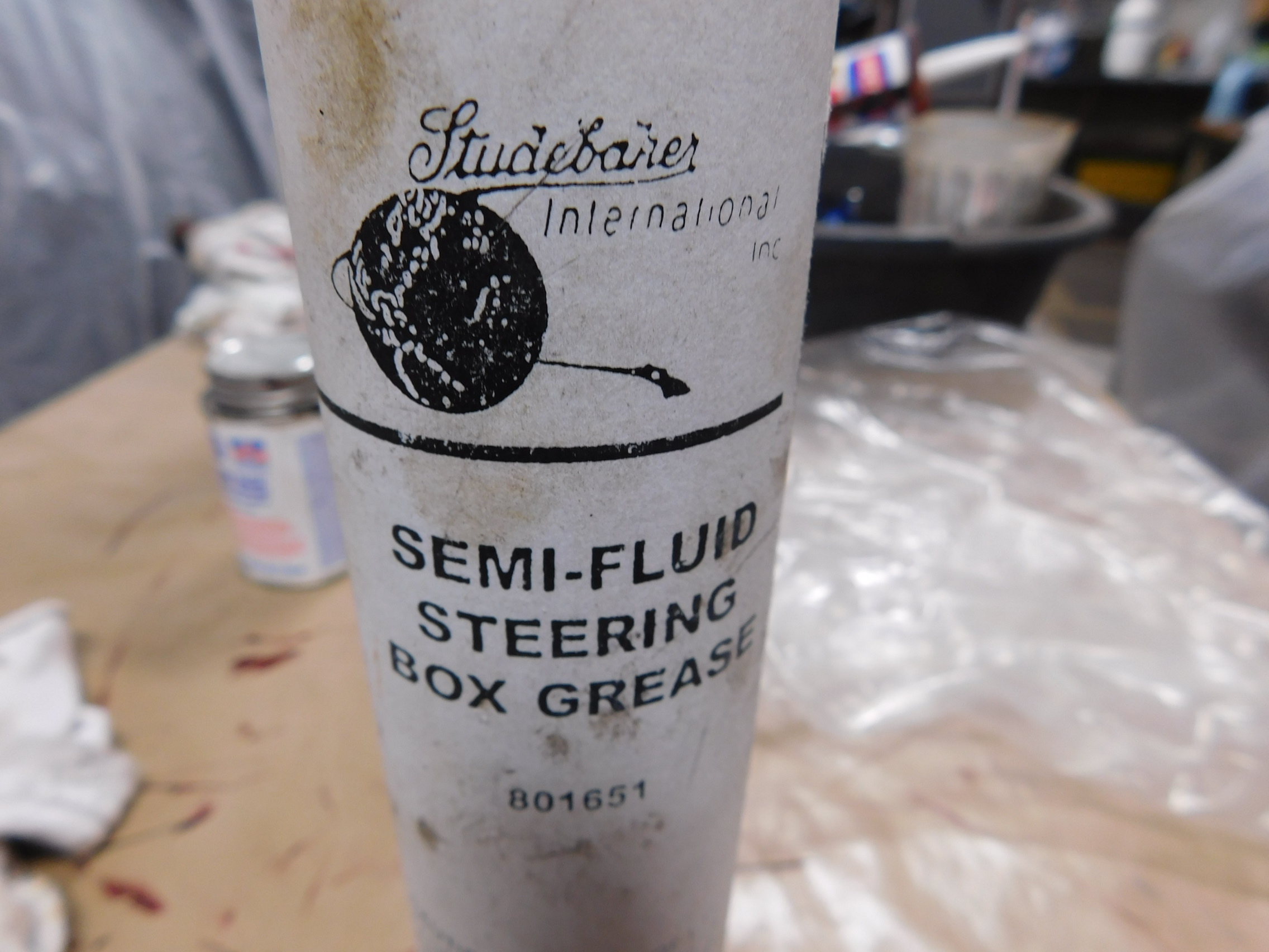

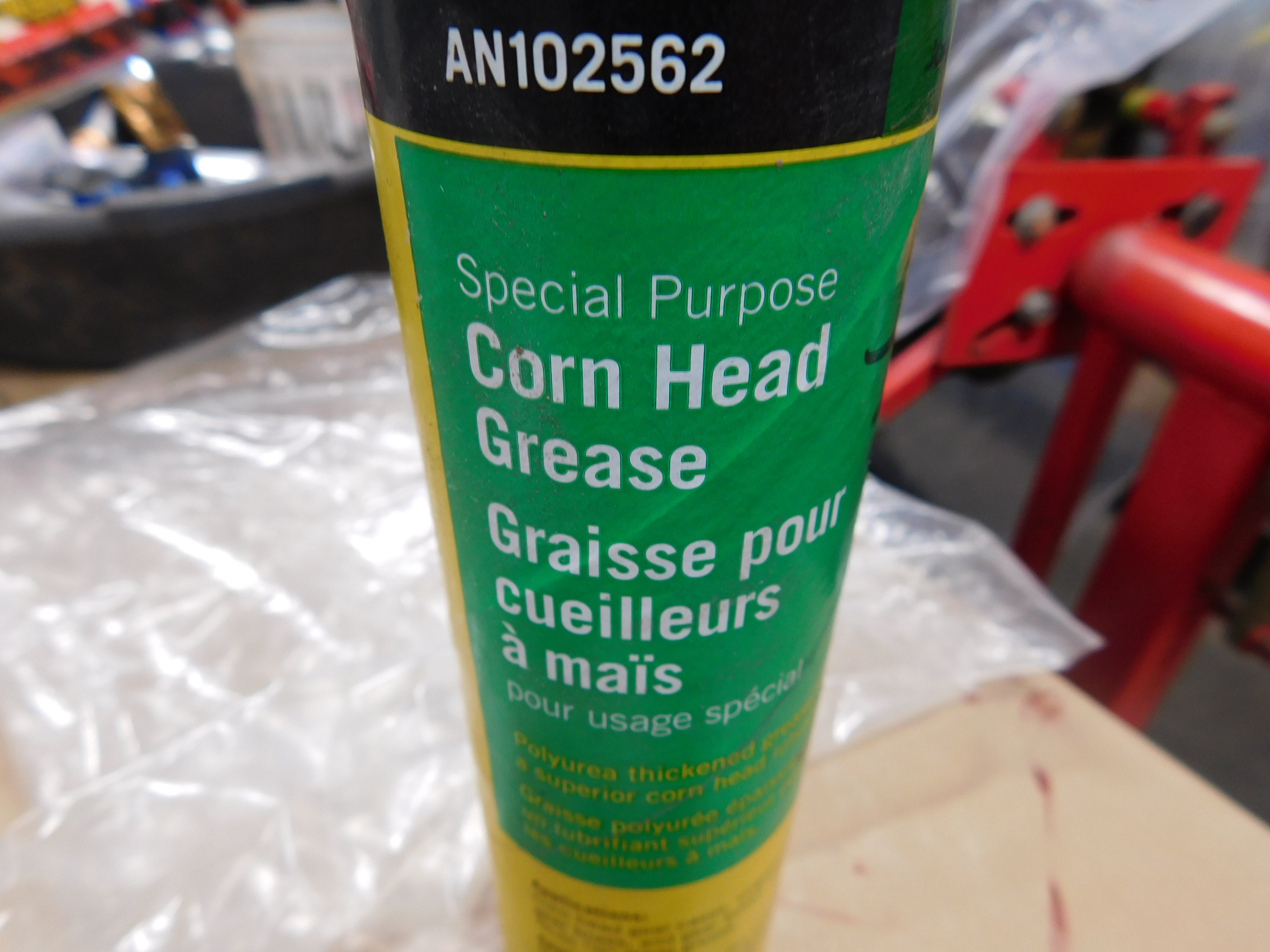

John Deere corn head grease is one and Studebaker International sells a steering box grease that is used in these boxes as well. Both are a "wet" type grease.

Jon, If you want to do yourself a favor use Corn Head grease. It works well .0

http://www.greenpartstore.com/John-Deere-Special-Purpose-Corn-Head-Gun-Grease-AN102562.html
Most all of the customer comments here are about antique cars !!!
Thanks! I just ordered a life time supply!0
