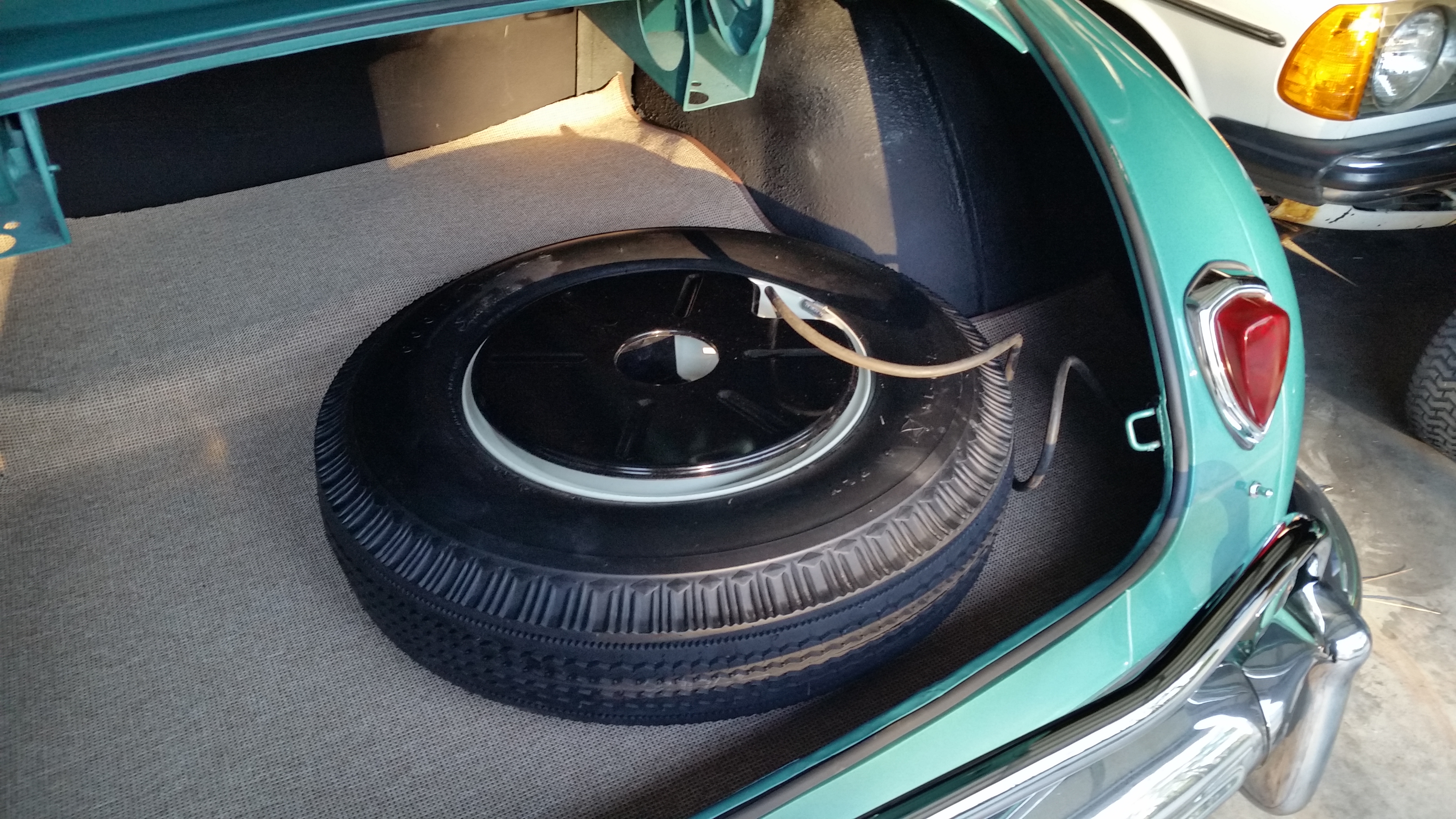

Does anyone have a picture?Is the tire upside-down or not?Thanks0
Here's how mine looks.
Since there's a cutout for the valve, I assume that the tire goes outside up.
I don't think I'd be able to hook up the inflator otherwise.
