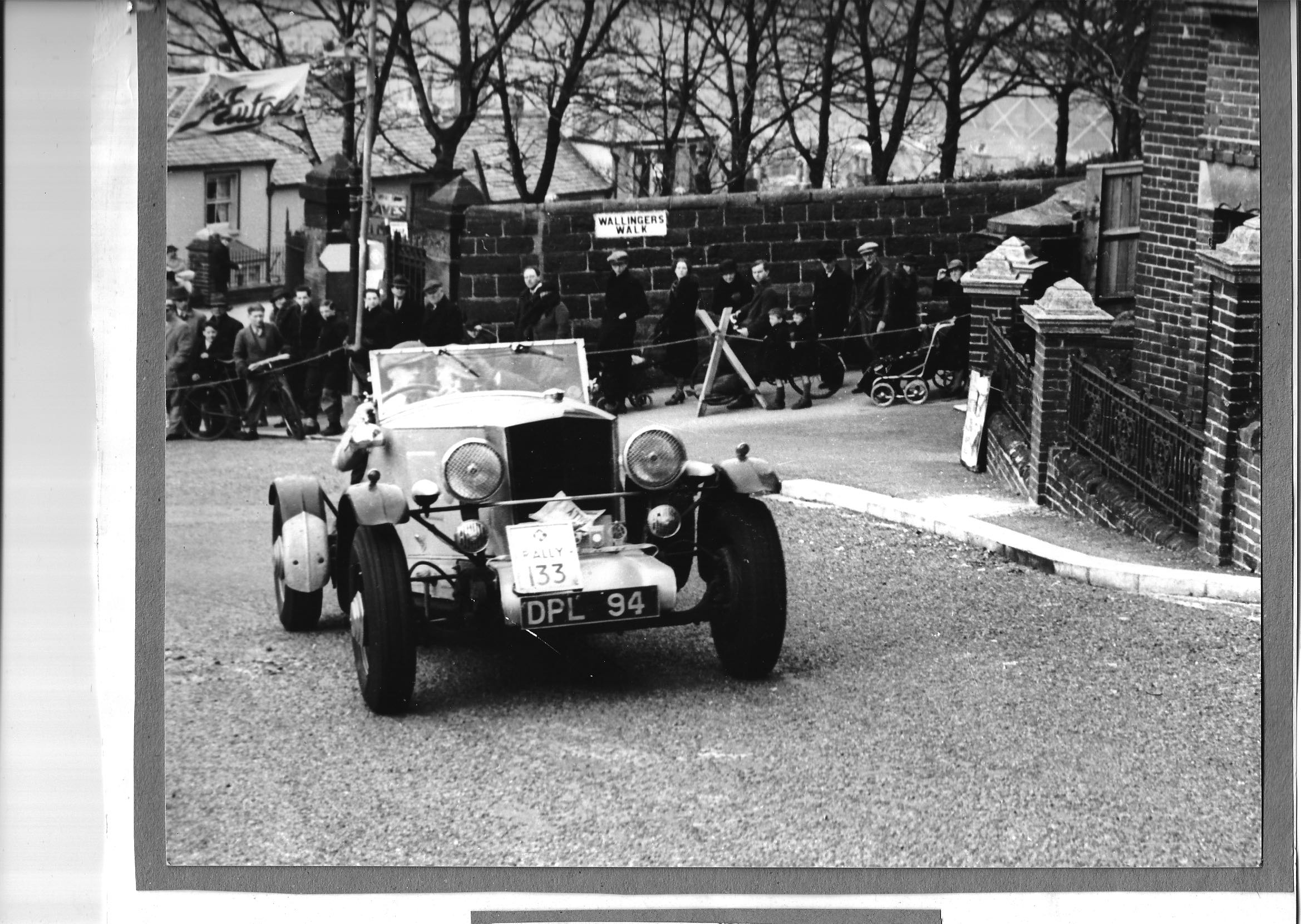

Looking for 2 front and 2 back 11x2" brake drums, ideally new old stock or if not NOS then they must be in good condition since the car is used for racing here in the UK. Does anyone know of any or any suppliers over there in the USA?I have attached a photo of my car competing in 1937 on the RAC Rally
