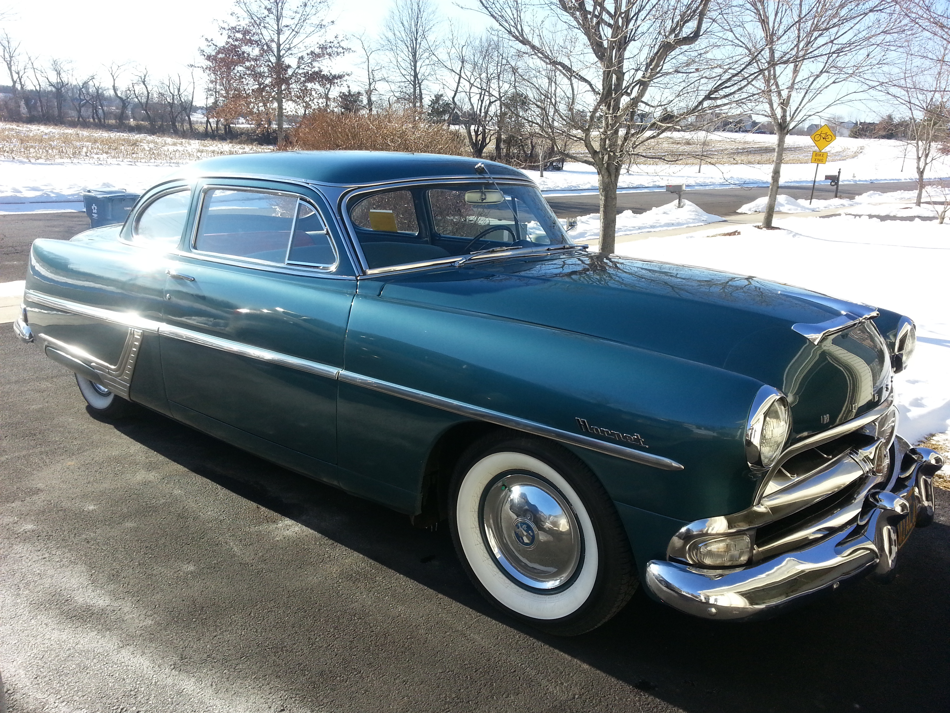

Thanks for the welcome! I've attached a picture of Henrietta, for those interested :-)Gus Souza sounds like exactly the kind of guy I'd want to work on the transmission, but Chicago is a looong ways away. I guess some people will pull the transmissions out and ship them to and from, but that seems like it would be pretty pricey, no?To answer Kdancy's question, I am sure that it's a GM Hydramatic II transmission. I'm pretty sure the transmission is 100% original, and has NEVER been serviced (at 60+ years and 73K miles). It's only ever had the fluid replaced, I believe. It's definitely time for some TLC!0
Super nice car!!!0
I like it too, very handsome body style!
