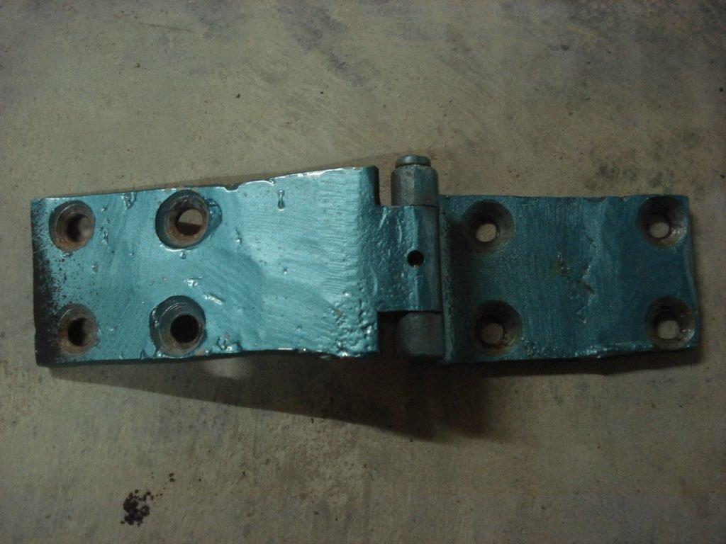

Wow, thanks for the infos...checked the hinge mounts...seems all o.k. The lower hinge (passengers side) seems to be repaired (welded) in the past. So perhaps it would be the easiest way for me to do an exchange. Has anybody a pair of good, usable door hinges out there? And hey Michel...yes it´s Lester´s former car. So probably you know that it was sitting more than 35 years in his garage without seeing the streets...i´m not from Ontario. I´m living in Germany.I bought the car from Lester and shipped it to Germany.

take a look at the lower door hinge (passengers side). No Hudson driver wants it on his car. Am i right? Maybe an option for a "ratrodder".Perhaps for a Chevy or a Ford.....;)0
Actually that hinge looks like most do. If the hinge is not rusted so integrity is compromised, it should be ok0
