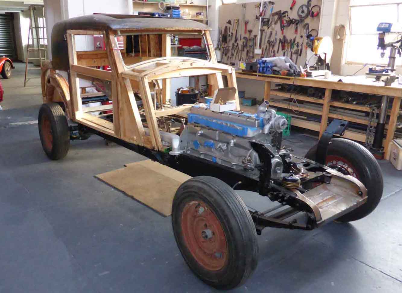

As I have posted previously, I have an 8 cyl 1937 engine with an Edmunds head.
Does anyone have advice on the correct spark plugs for this head ?

Your plugs are 14 mm, and a Champion J8 will work fine.Geoff0

You could always park the Railton on the lawn!0
