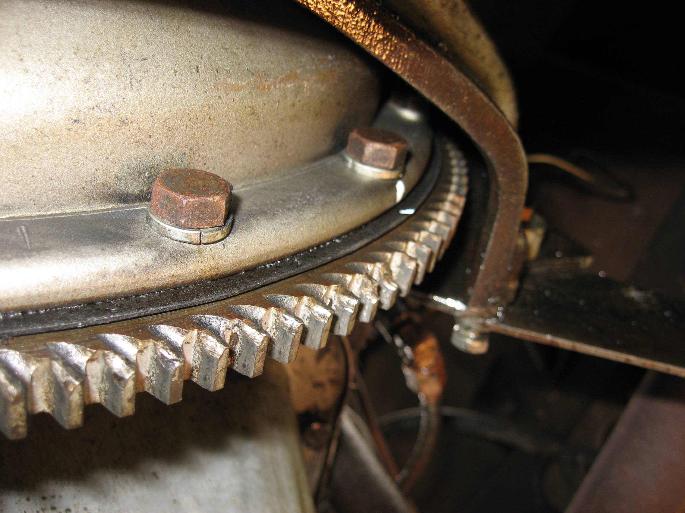

Jon,
Though this photo of a flywheel is not the same model as yours, the general wear and damage is evident.

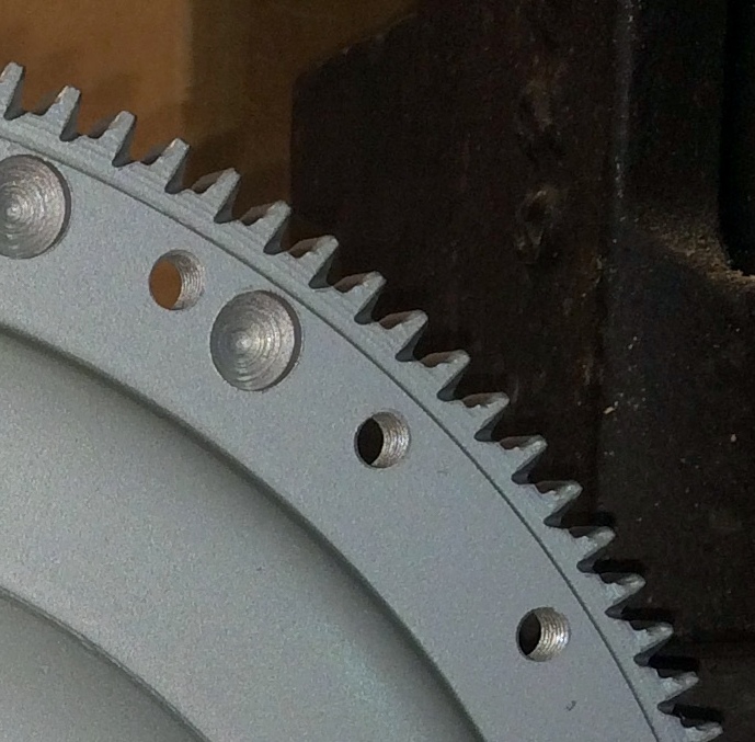

The second photo shows an unused flywheel.
Rob
Jon,
Correction; the second photo shows a nearly new flywheel, it does appear to have very light use.
Rob
Thanks, Rob. Having looked at the first photo I would have thought it was in good shape! Now I know what to look for. (Can these things be welded on the car, then machined with a file, if it's just a couple of teeth that are bad? Replacement would be a major operation.)

If that the case, it's not just a few teeth. It will be a stretch of about 4 + inches long in each of three spots, 120 degrees apart. One as bad as the one in Rob's photo can't be "fixed" by the ring gear rotation method.....it's just too gone (note the teeth visible in the uppermost area of the starter mounting hole).
If yours is sometimes failing to engage, it's probably that bad. Bite the bullet. It's gotta go.
I hope I'm wrong.
In the first photo, the second tooth is cracked on both sides down into the bolt hole and you can see the that the starter has already loosened that tooth. It would probably fall off if the bo

Adhering to my usual opinion that almost anything is possible, I must say that the notion of welding/repairing a ring gear in-situ is probably possible but not at all practical.
Lee, I believe you are seeing a stamping or other mark on the gear and not a crack. Possibly just whacked with a slag hammer or such.
Frank, I believe you are correct. When I click on the picture now it's twice the size than before, and more detail is visible.

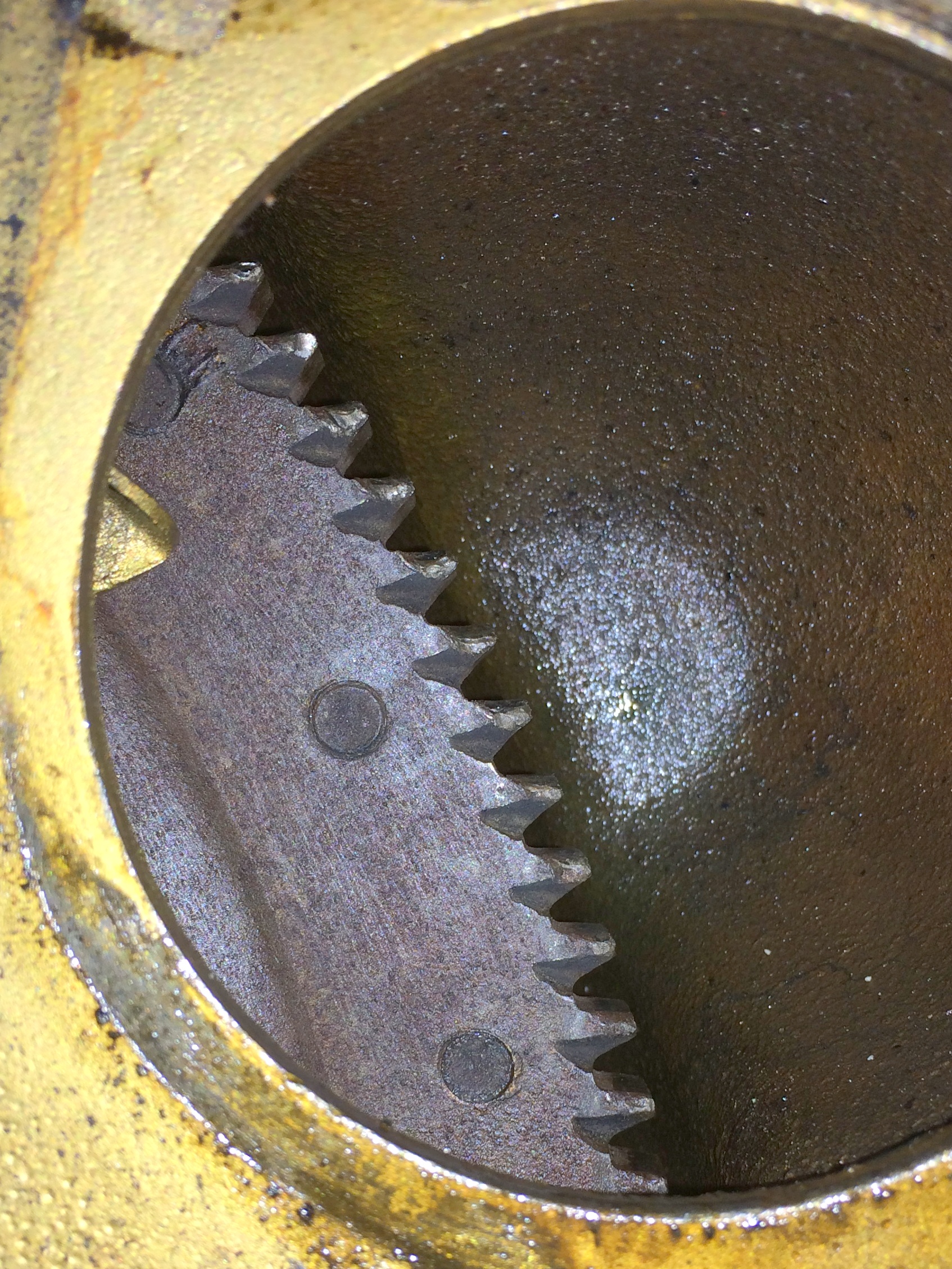

Okay, I removed the flywheel cover and checked the ring gear teeth today. Everything seemed okay except for two or three teeth that are partly eaten away:
The chipped teeth are toward the right (we're under the flywheel looking up). I'd say almost half the outer surface (furthest from the center of the flywheel) was removed. I did notice some rough edges and burrs, and using a small, fine file I got into the teeth and smoothed things up. I'm hopeful (though not convinced) that the teeth on the Bendix had become enmeshed in the burrs and that removing them might help not to jam up the starter drive next time.

Is this the only area of the ring gear you have looked at? There are two other places, 120 degrees either way from what is in the photo that may be worse than what you are seeing at this point. Moot point, really, since the visible area is bad enough to be suspect and ring gear replacement is a good idea. I find it odd that the damaged area is pretty much limited to those the two teeth. It usually spans about 4 inches, gradually worse from either end toward the middle of that area. I have a difficult time believing that those are the only bad teeth......but I've been wrong before.
Rotate the crank 120 degrees and have another look, then another 120, if you haven't done that already. If they are, in fact, the only bad ones, I'd consider your suggestion that they could be welded up and hand dressed to the original profile......or close to it. I'd do it. What's to lose?
The engine doesn't need to come out in either case, as Geoff pointed out earlier.

Thanks for the thoughts, but I carefully rotated it in 6 inch increments, marking the flywheel with White-Out as I did to make sure I didn't skip anything. Those 2 or 3 teeth were the only bad ones I found.
