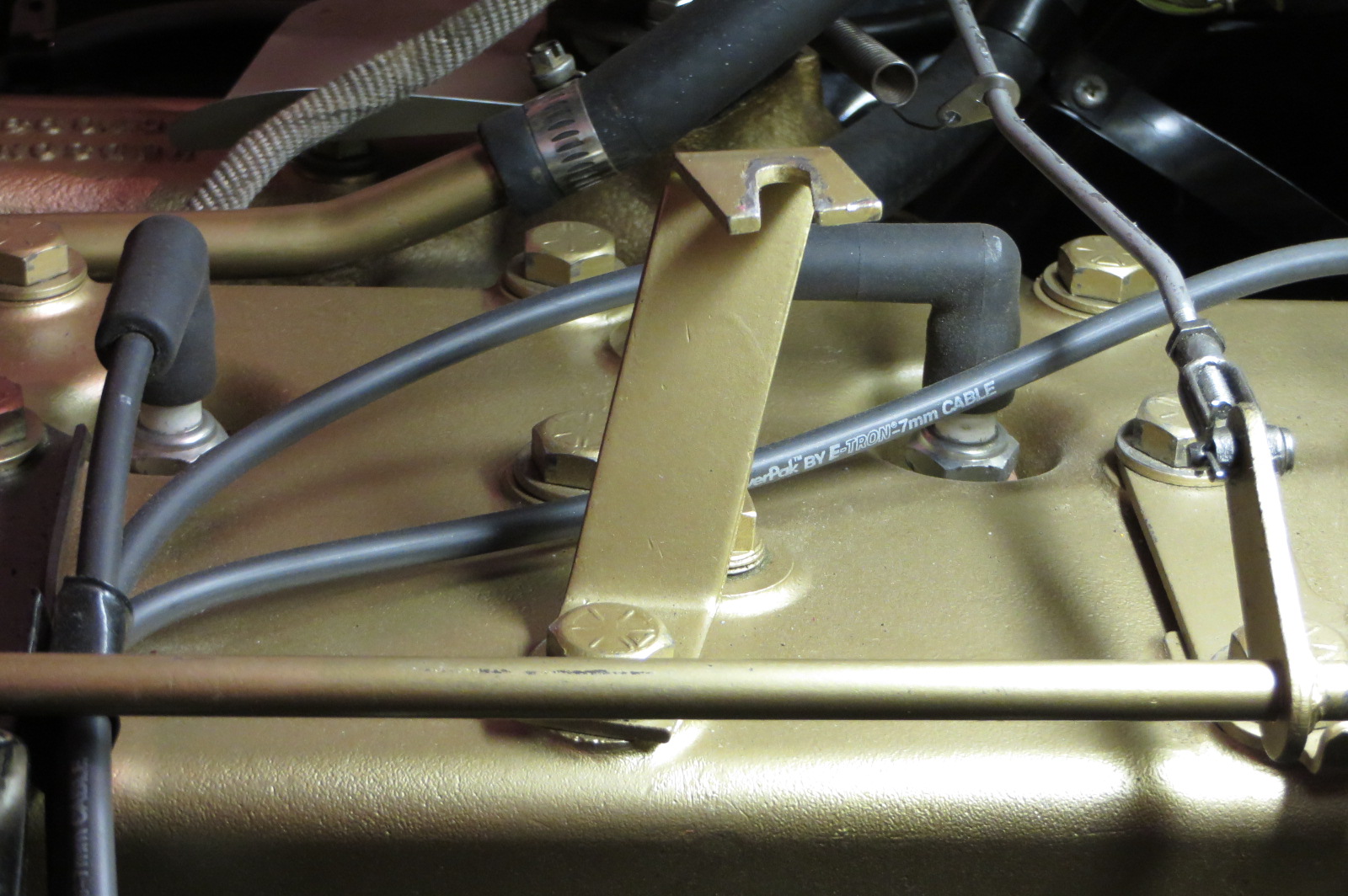

Our 54 Hornet Hollywood is just about finished and we are looking for the rear bracket that holds the air cleaner on the engine. These air cleaners are the dry type. If anybody has a spare to sell or a picture of this bracket please post. Thanks Hudsonly Ray Or could send me a drawing on email please do so.

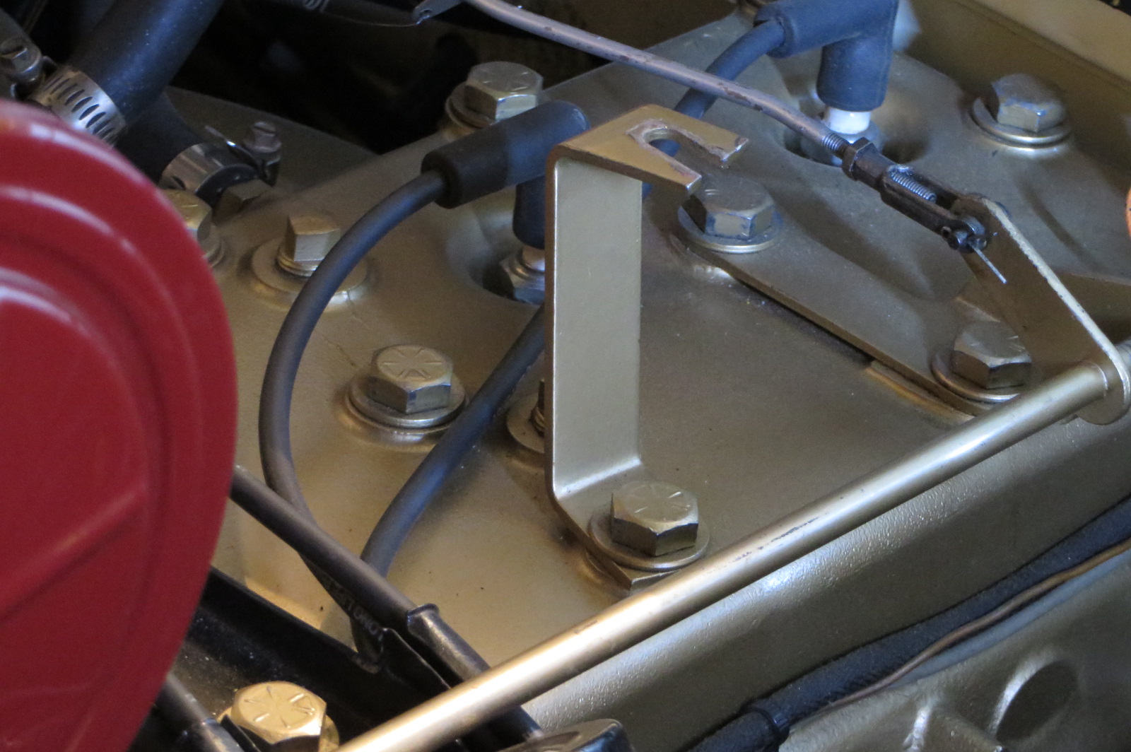

Here's one. Note that the upper "tab" isn't exactly parallel with the lower one. The upper one is rotated about 15 -20 degrees counter-clockwise from the lower one. And the slot isn't parallel with the tab.
Here's another shot, which shows how the vertical part is canted back a bit. Sorry I couldn't figure out how to add a photo!0
Hardware store. Strap steel or aluminum. Bend and cut to photos and to fit. Done it multiple times for Hudsons "and other fine cars".
Thanks so much just what I am looking for.Could you please give me rough measurements where to bend and lengths.. Hudsonly Ray0
