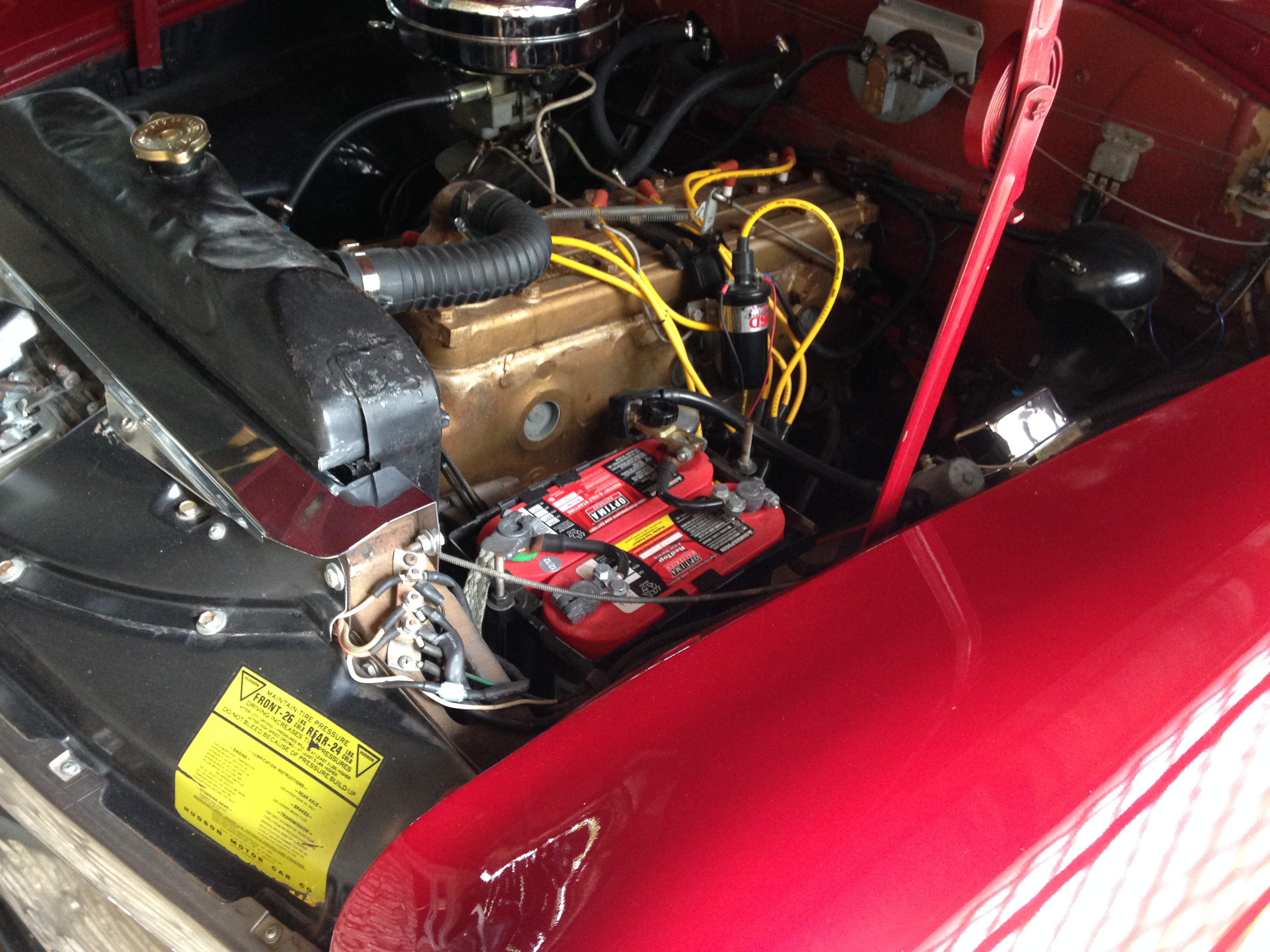

The one on the right is now 6 yrs old. One on the left is probably 3. 800 Cranking Amps per battery, but hooked up in series still only 800CCA. Right Frank?0
Welllll. Unless my eyes are playing tricks on me (again) that appears to be a parallel connection of two six volt Optimas. Please verify. In that configuration, the quick math would put it still at 6V but double the current producing capability @ 1600. Logic would dictate that a series connection would produce 12V at the same current rating (800) as a single 6V.
F
