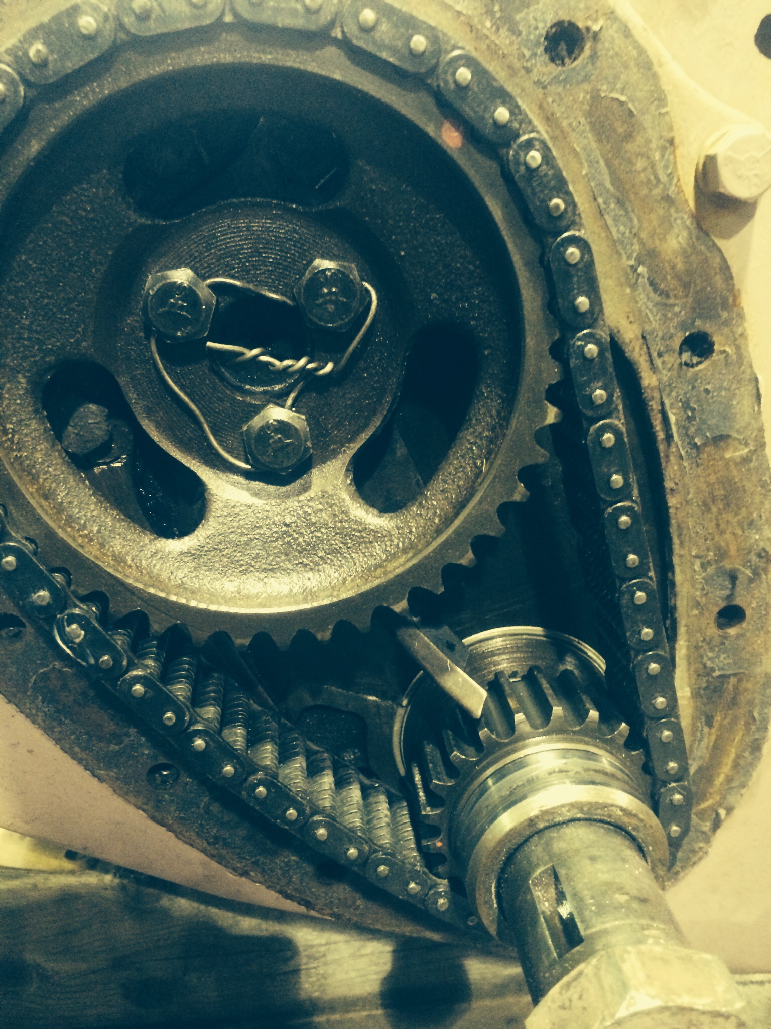

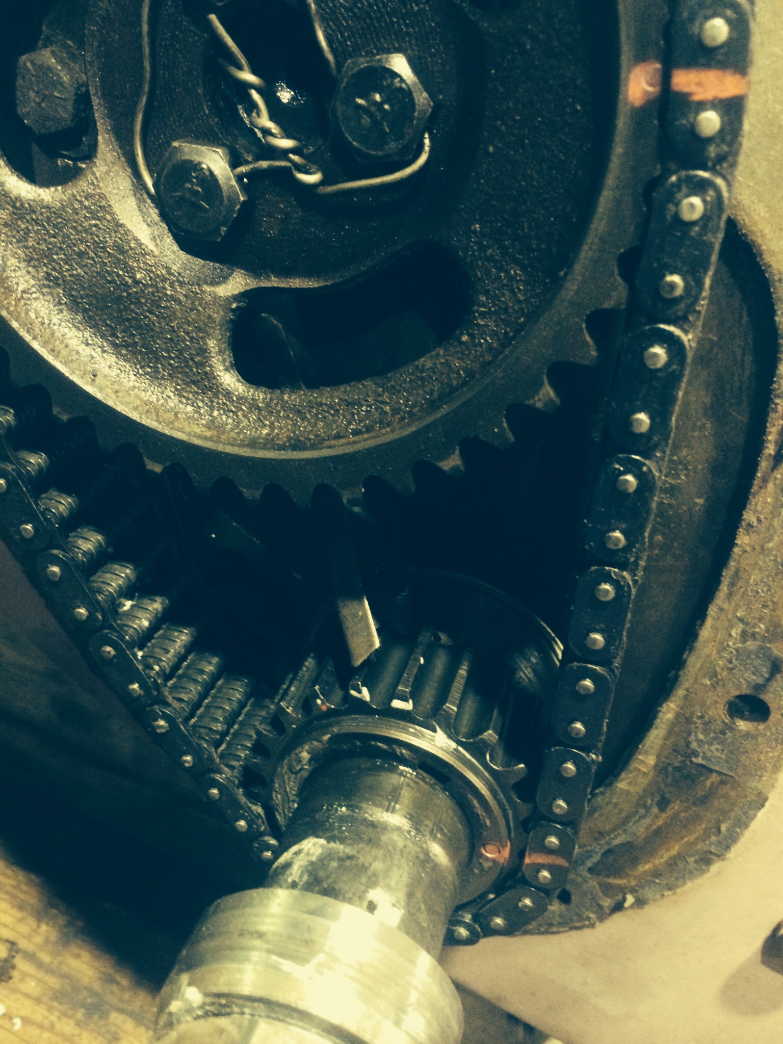

ok removed timming gear cover found mark on cam gear but cant find mark on crank gear. I tried counting off 7 links and still cant find it . I am going to replace chain with one from 21 st century Hudson . has anyone else ever ran into this ? thanks Andrew ill send a picture also
the reason you can't see the mark is that it's hidden by the seal wiper ring. Take it off.

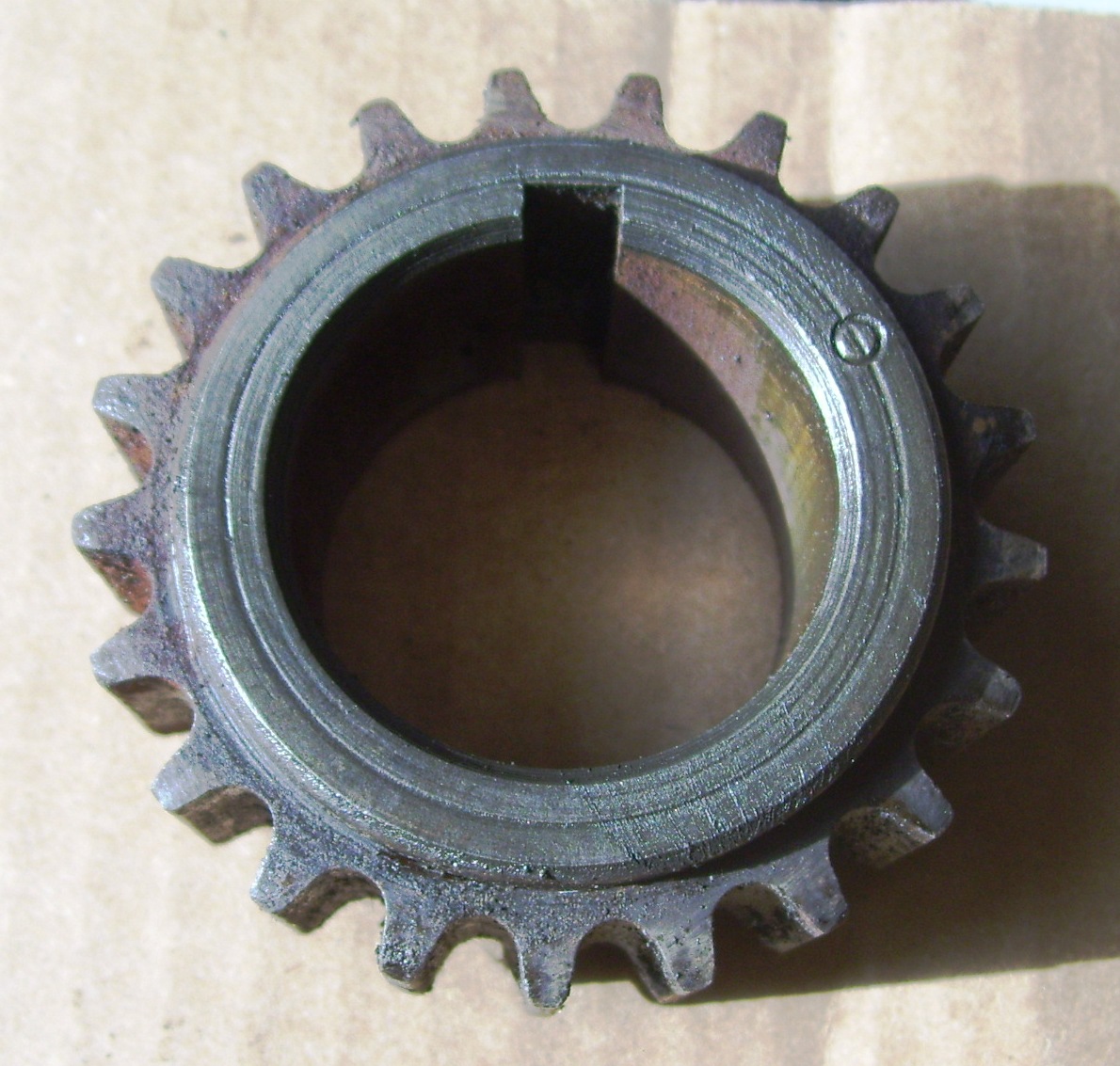

It's a circle about 4 teeth to the right of the keyway.
Looks like this thing is out of time by a couple of teeth.
Ok got it thanks I thought I was losing my vision starring at it trying to make it appear didn't. Even think to remove seal. Duh!!0
