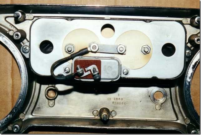

Assuming the sending units are properly connected, the loss of both gauges is most likely the lack of input voltage from the IVR... Instrument Voltage Regulator. The IVR operates as a voltage chopper. It creates a steady 5.7 volts by chopping the input voltage. Make sure it is operating and is connected to the shorting bar from both gauges. There is ONE IVR that supplies voltage to the gauge set. If the electrical system was changed to 12 volts then you need an IVR that will drop 12 volts to 5.7 volts. The 57-58 Ford instruments used such an IVR. I use the later in a 1953 Wasp using OEM gauges Last point, the IVR requires input voltage. .0

I am most embarrassed to answer your question but I guess I owe it to anyone following this thread to 'fes up to the problem. So here, reluctantly, is the answer. Some months ago I purchases a replacement glass front cover for the fuel/temp gauge. I replaced the old glass cover with the new one & put the gauges back into the chrome instrument cluster. When I saw Park Waldrop's picture of the instrument voltage regulator I noticed mine was upside down from his. So I took the instrument gauges out, turned the glass cover over, replaced the gauges back into the chrome instrument cluster & now the needles sit to the left of the gauges as they should with the ignition switched off. I'm sorry for the trouble anyone went to to solve this problem that really wasn't a problem.

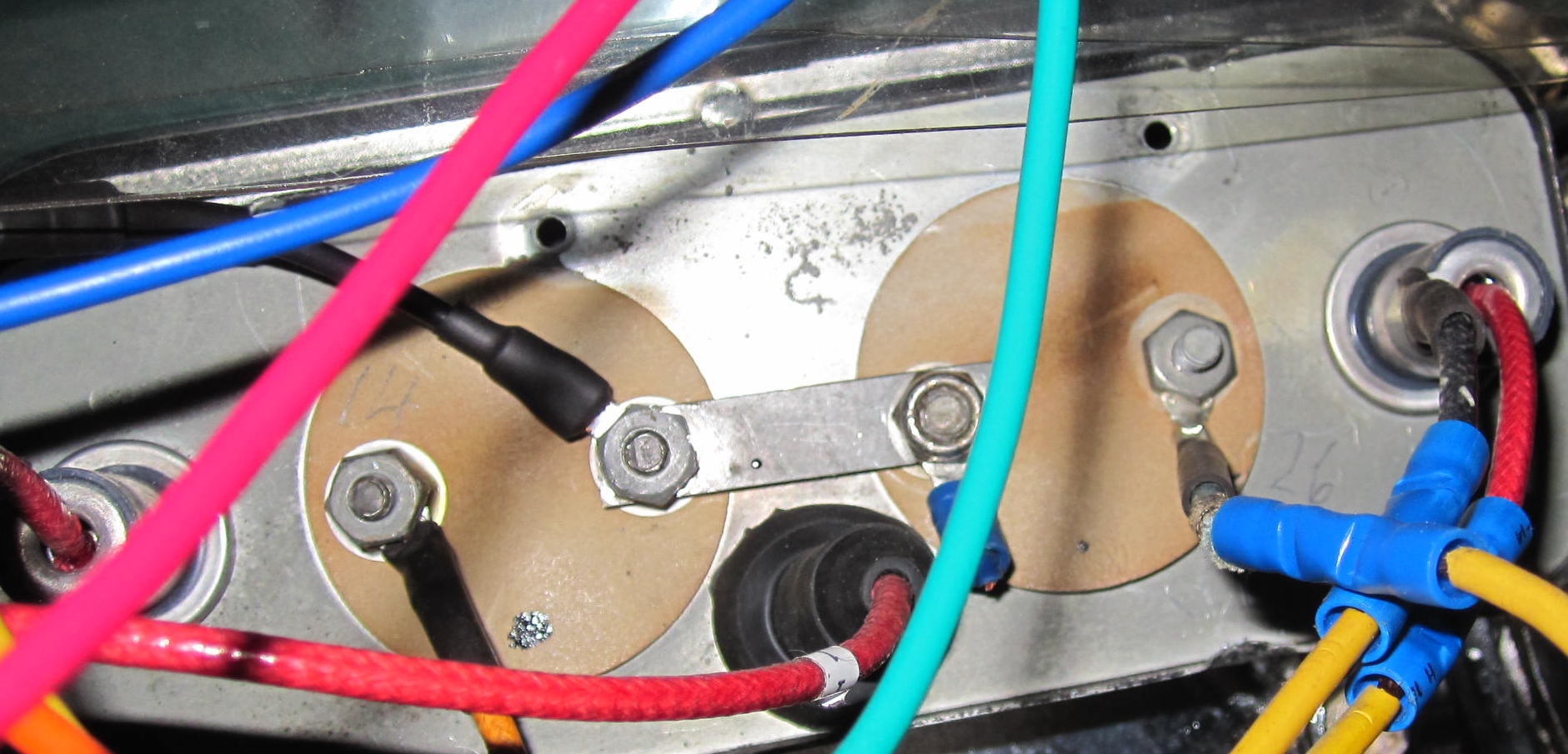

I haven't got under my dash to turn my gages the correct way yet; thinking of taking the seat out first. The people who put the dash back together also got the gages upside down. The temp gage is wired to be the fuel level and fuel gage wired to be the temp. I put my camera up there and took a photo of the back and it was obvious to the 'ole Hudson timers' that it weren't right. The correct back orientation is as per Park's photo. SO: I need to remove the two phillip head screws and flip it; easier said than accomplished.
BUT, an still confused on this. If I flip the gage part{containing both gages} around and install so gages won't be upside down, won't the gages be connected at the top and the end of the needles be at the bottom ??????? That doesn't seem right ?????
photos of gages
1st: with key turned off
2nd: Park's orientation
3rd: My gages from the back {I did NOT do the plastic terminals-so refrain.}
If the gauges are upside down then the bar will be connecting the incorrect terminals.0
