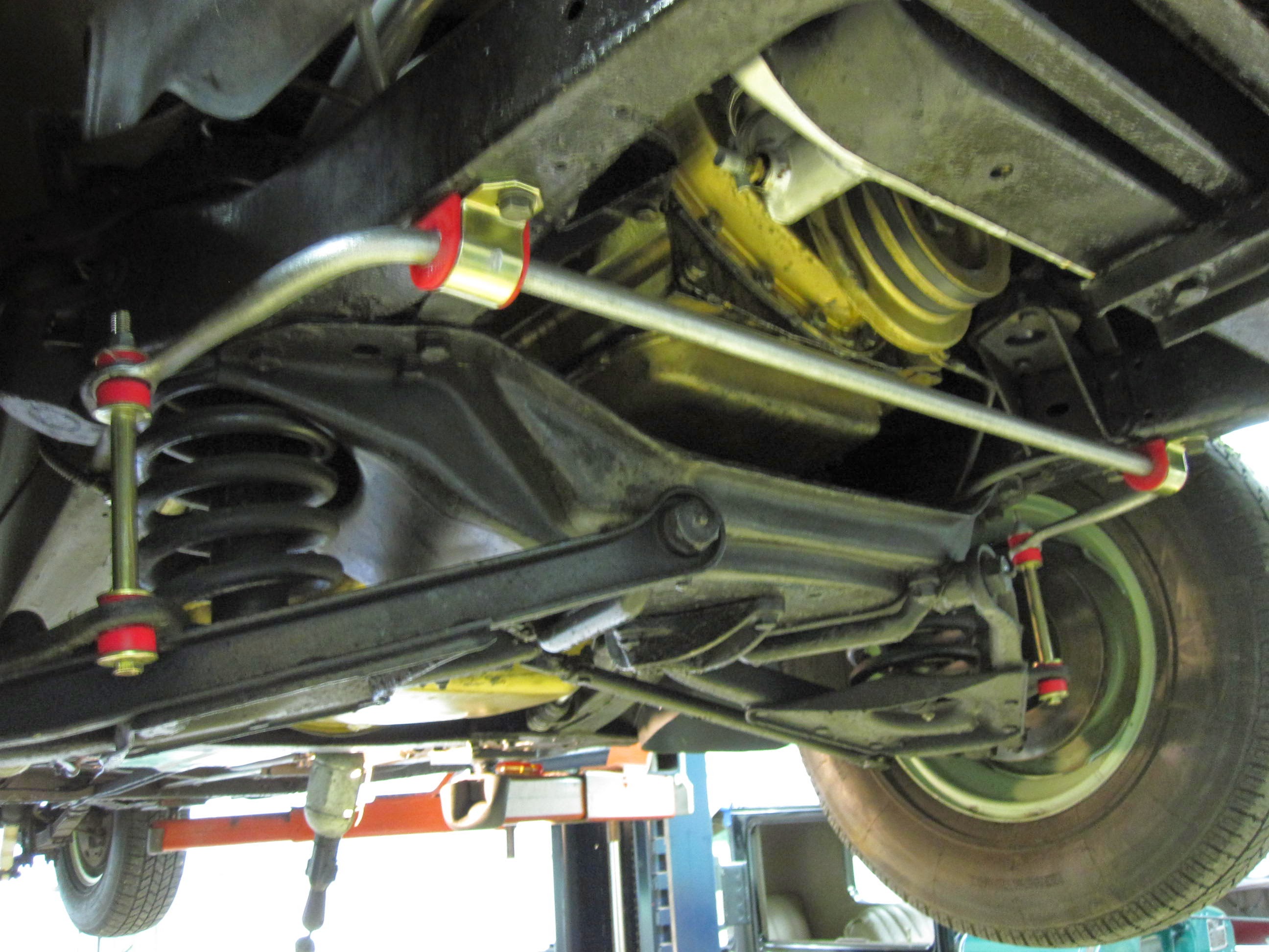

I am trying to replace the front Stabilizer/Sway Bar bushings on my 1949 Hudson. Unlike modern cars, which have split bushings, the Hudson bushings are solid. This makes installing them difficult. I press off the old bushings, but this caused them to crack. So I don’t think this method would work to install them. Does anyone have any good ways or ideas on how to install the solid front Stabilizer/Sway Bar bushings?

Just buy the aftermarket bushings. Easier to install and poly bushings will be a improvement over original bushings.

OK I have found the method to install the non split Stabilizer/Sway Bar bushings. The trick is to put them in boiling water to get them really warm and then remove them from water. Put some rubber lube like dish soap in the bore and they will press on by hand with a little muscle. I got this from an auto shop teacher.0
Exactly how I installed the rubber replacement i purchased in the past.0
