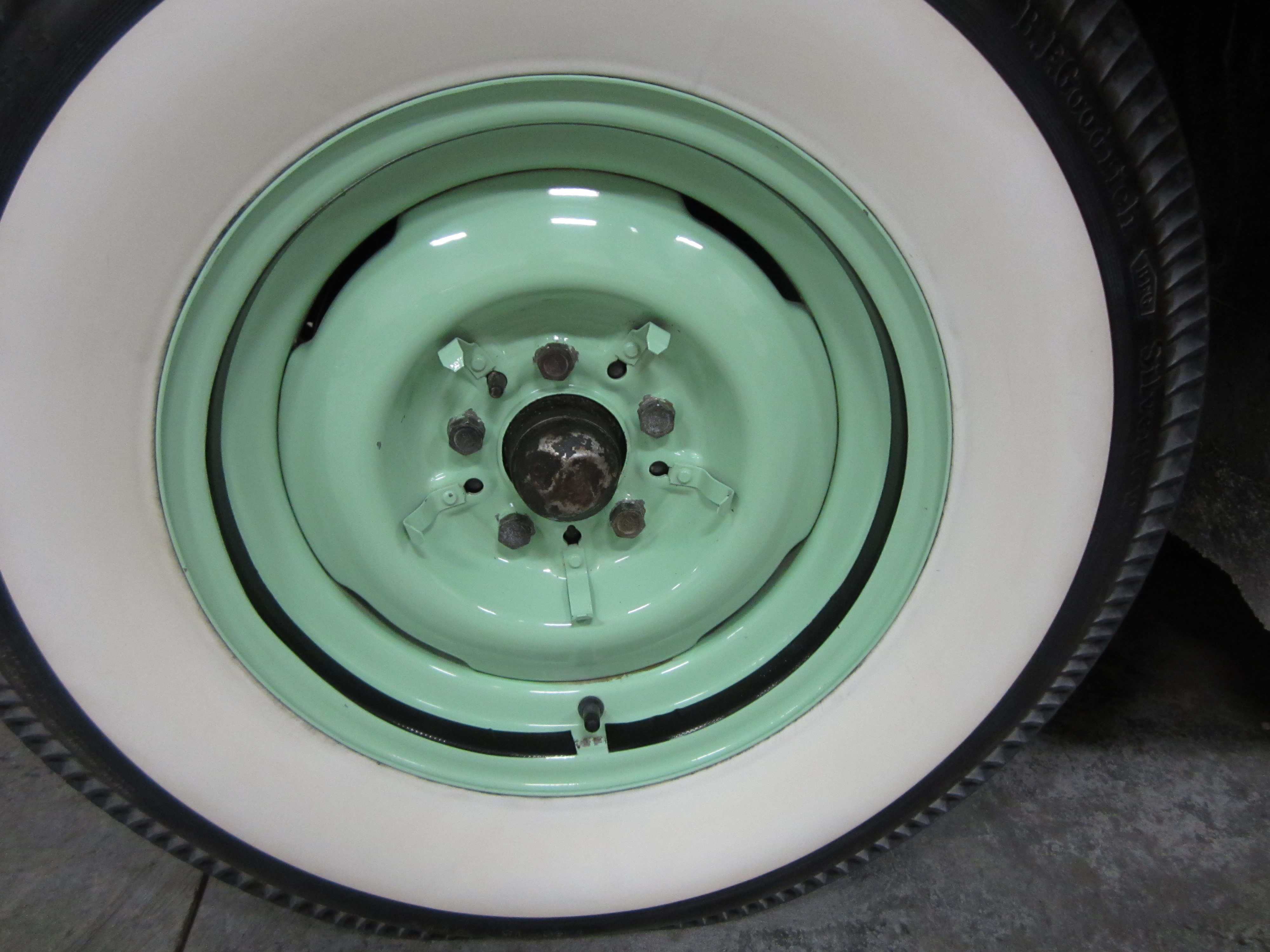

Lee, thanks for your reply.Tell me more about using the tape. What kind, duct or? Do you cut it into strips and then kind of wrap the inside of the wheel? I think the article I'm referring to had that detailed information so that's what I'm hoping to find. Slightly bending the tangs makes sense too.Our '54 only has two original wheels with the raised metal bumps by the valve stem holes. Not sure what the others are from but probably older Chrysler wheels. I am using brass valve stems to help hold the covers and to insure that if they do creep they won't slice the valve stem. Any further advice is most appreciated.Tim0

Just another thought came to mind. Wheels need to be true. If bent slightly or flex they tend to flip the wheel covers of the wheel. Also, Sometimes when wheels are balanced they put thick wheel weights on the rim. They will not allow the wheel cover to mount all the way flush with the wheel where the thick wheel weight is. The wheel will only go on as far as the wheel weight allows. Thin wheel weights are better and usually allow the wheel cover to mount all the way. If a wheel weight prevents the cover from going on all the way you need to replace it with a weight that will. The lip of the wheel cover should set flush against the wheel. If it doesn't you need to find the reason why and make correction. A powder coated and newly painted wheels leaves a slick surface making it easier for wheel covers to slide off. If using full wheel covers the wheel color won't be seen anyway, save some money and not paint wheel except of the outer lip. Wheel weights will mess that up too every time they are changed.
Clean the wheels real good so tape will stick. I run a strip of tape all the way around wheel surface where the wheel cover tangs make contact. Don't use cheep tape whatever type you use. It will not stick. I've used a good grade masking tape. Masking tape has a ruff texture for the wheel cover to grab on. I have used different types of good tape that helped. You do not want the tangs to contact slippery surface. Use "good old common since". Your choice.

PS - Maybe even a rusty surface would work better than tape. Just a thought.
Someone may even have better solutions. A solid welded wheel would be better than a riveted wheel, less likely to flex. A wider wheel than 4 1/2" wheel would be stronger with less flexing.
