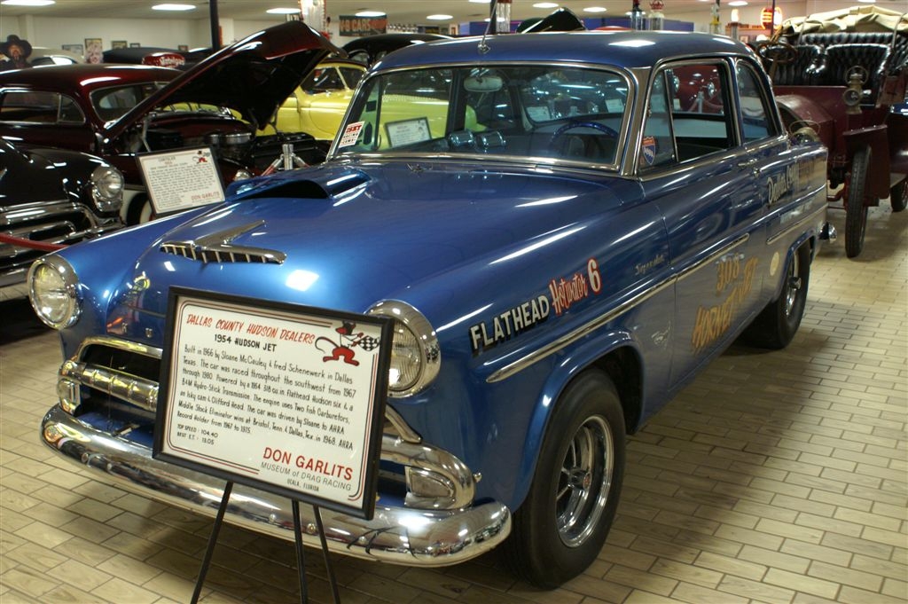

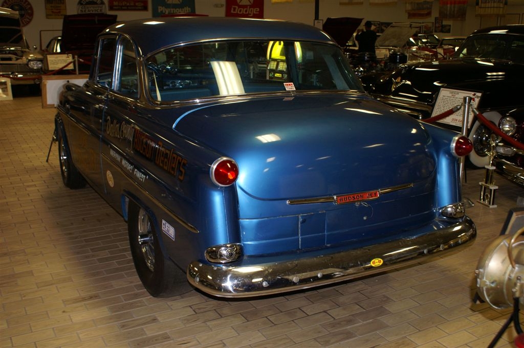

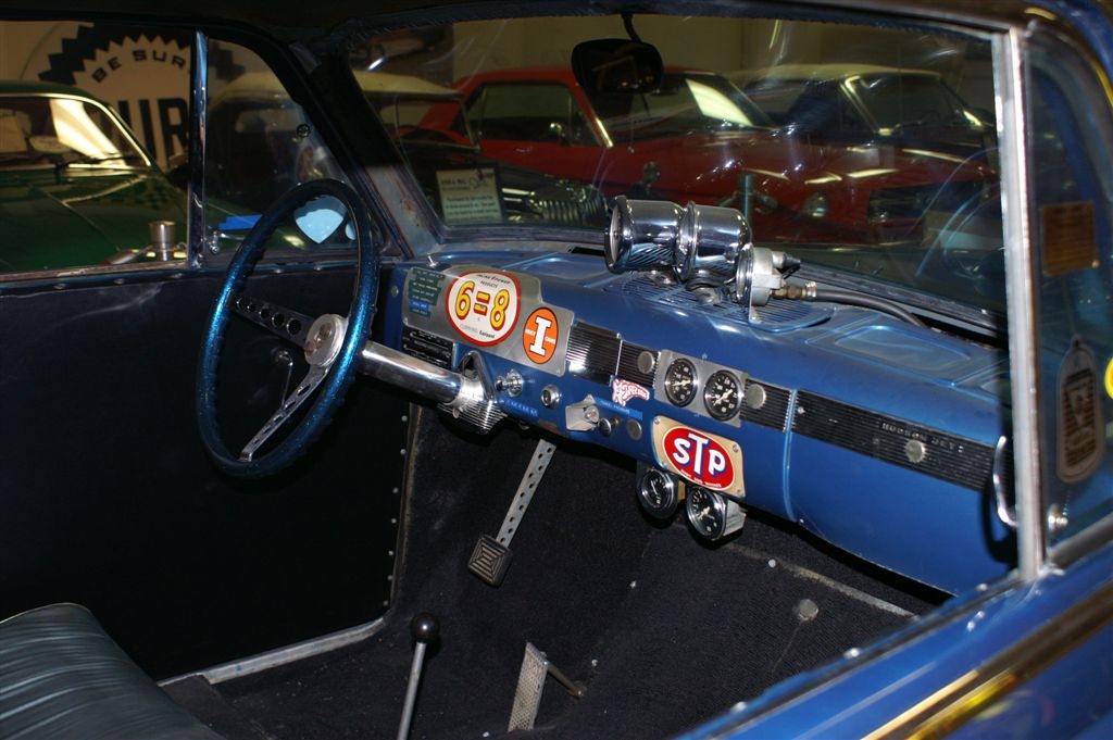

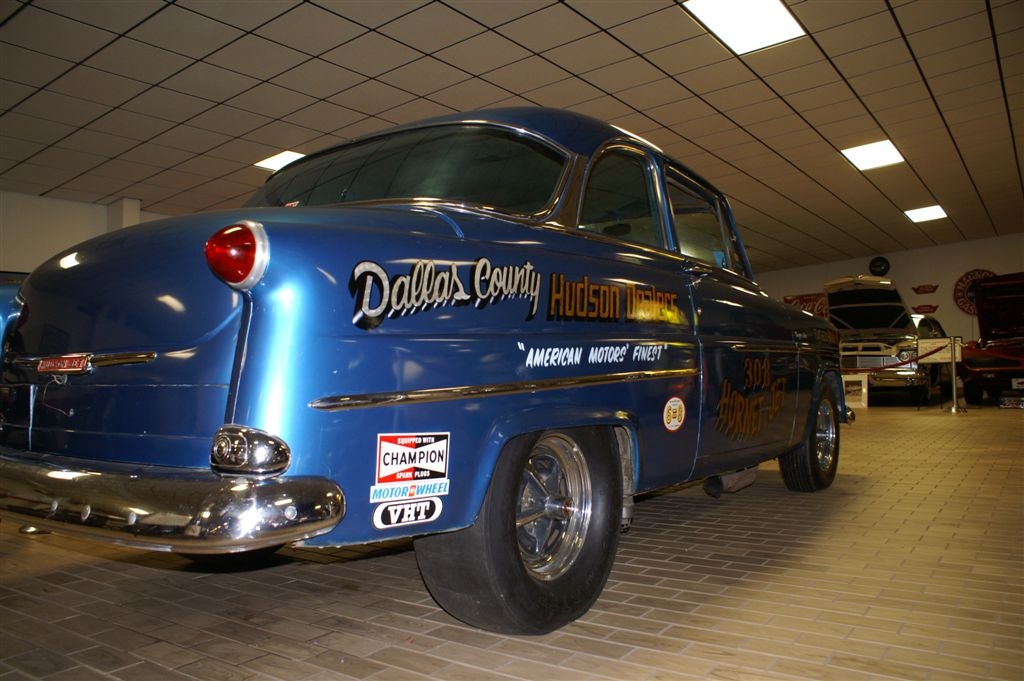

Here are some pictures of Sloan McCauley's 308 engined Jet

Sloans Jet was bought by John Williams of Tenn. engine drive line sold on eBay. V6 installed.0
