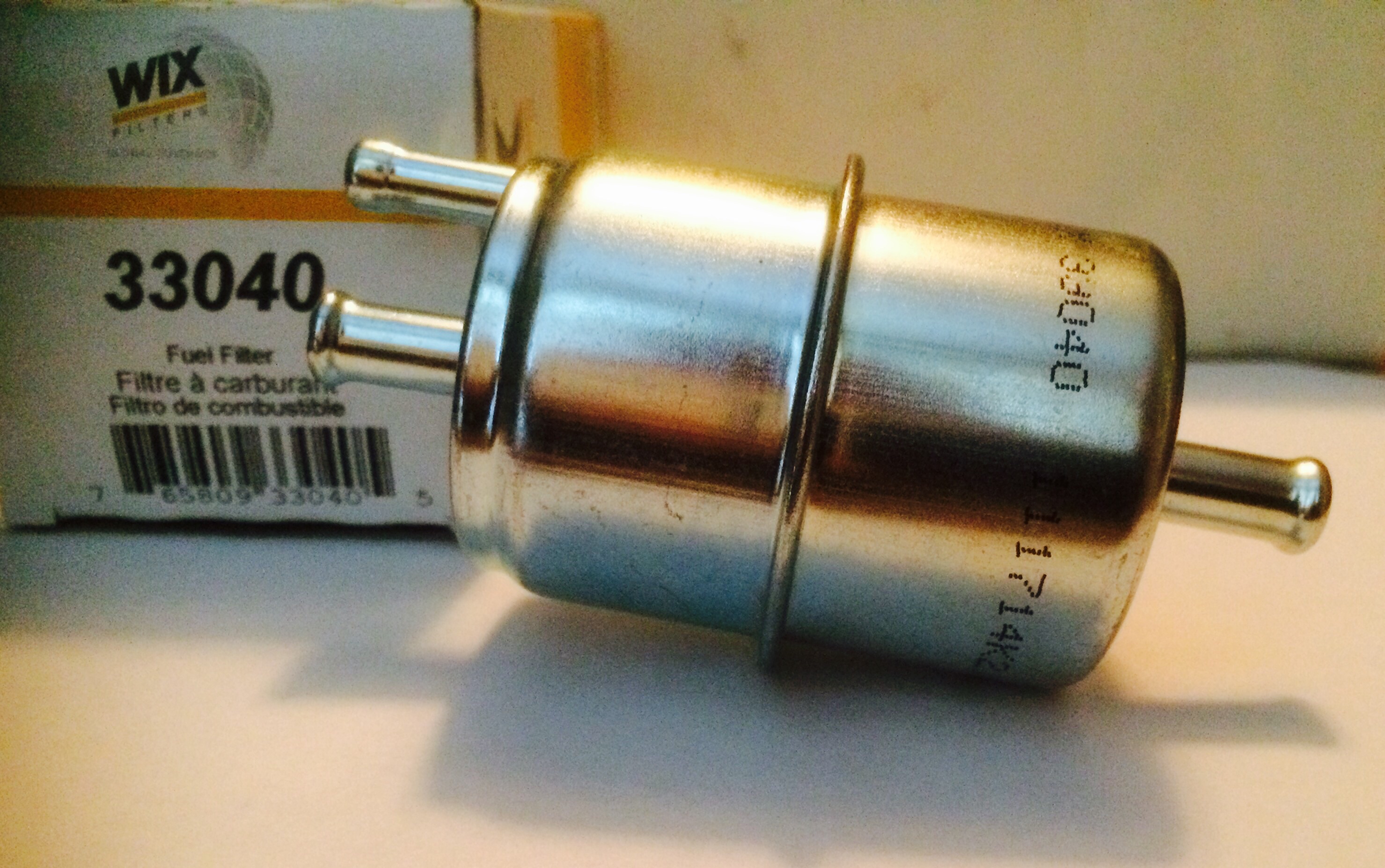

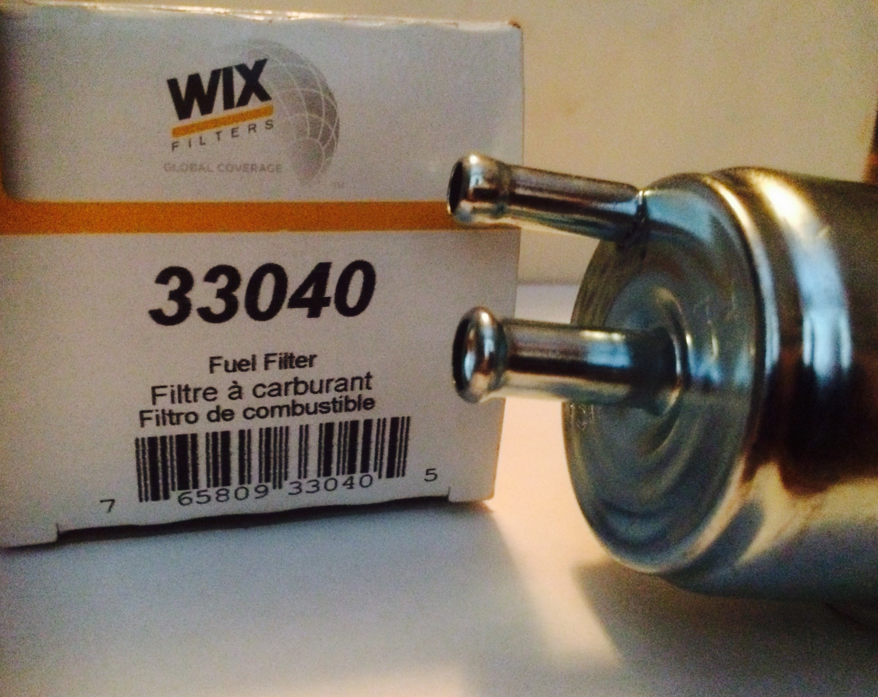

I went to Reilly's to day an bought one WIX 33040. First time I bought a fuel filter that does not include hoses and clamps. I checked the depths of in, out and vapor pipes against what was posted in MOPAR THREAD discussion I posted. ( CHECK OUT REPLY #2 ), pictures show differences in filters. GOOD AND BAD.
The WIX 33040
CAN length 2.375
TUBE - all three lengths 3/4 inch
IN pipe depth 1 inch
Out pipe 3 inches
VAPOR pipe 3 inches
VAPOR hole size approx. .060. A .045 diameter paper clip is loose in hole.
Top marked IN
Bottom marked FL USA
I am curious about why the IN tube is shorter than measurements in following REPLY #30 and what difference it makes.

I pulled one today to do a comparison on them -- good versus bad
Overall can size is the same @ 2.25" can height x 3" can diam
on both the hose fittings protrude the same @ 5/8" on all 3 fittings and is figured into the overall length of the fittings
Now comes the differences
Pipe lengths are measured with a paper clip going all the way up inside the fitting to determine overall pipe length
Inlet fitting length
Good one - 2.5"
Bad one - 1.25"
Outlet to carb fitting
Good one - 3"
Bad one - 1.25"
Smaller return line fitting
Good one - 3"
Bad one - 1.25"
Good one has the markings TOP stamped on the top of the can and IN stamped in the bottom of the can
OUT
Bad one has no markings of any kind on the can

CORRECTION TO MY PREVIOUS POST
WIX 33040
BOTTOM marked IN
TOP marked FL USA
Lee O'Dell
