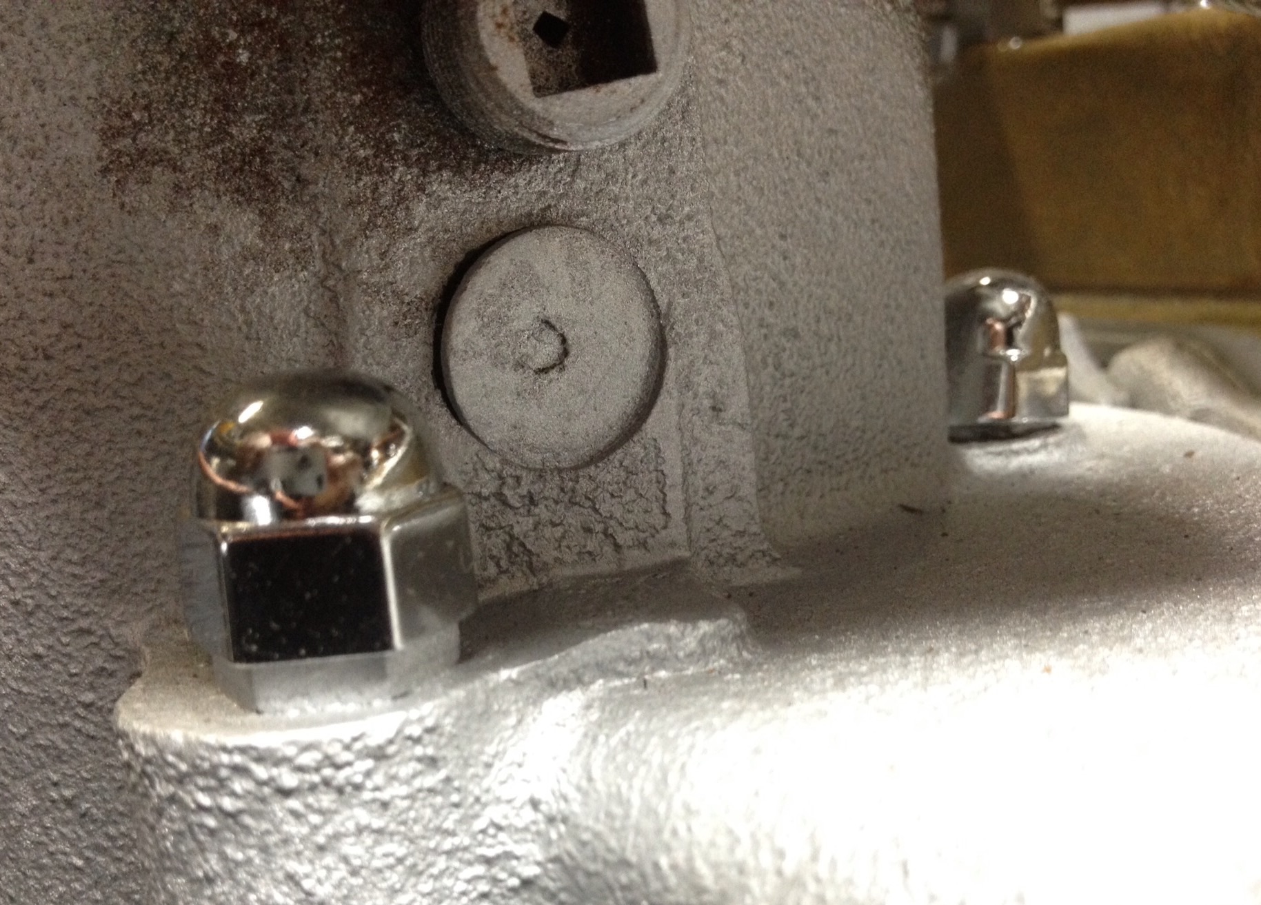

While trying to get my '49 262 super six running, I found this plug in the manifold that appears to be bent and needing to be replaced because of the gap it has.
What is this for and would it be a cause of the engine not running and sounding weak when it runs for a short while at best?

That appears to be where the vacuum line for the wipers starts from. Normally there is a brass fitting and a steel line running over to the top input side of a double action fuel pump. If it's loose it well may be the cause of a vacuum leak causing engine problems.0

That is an expansion plug,, which is used to fill the hole left by the casting process.0
So I can just high heat epoxy it?
yep0

You should be able to get a new plug to fit the hole.0

Is there an epoxy strong enough to use on this plug?

Surprisingly had no trouble getting the plug, ordered the gaskets from R Maas
