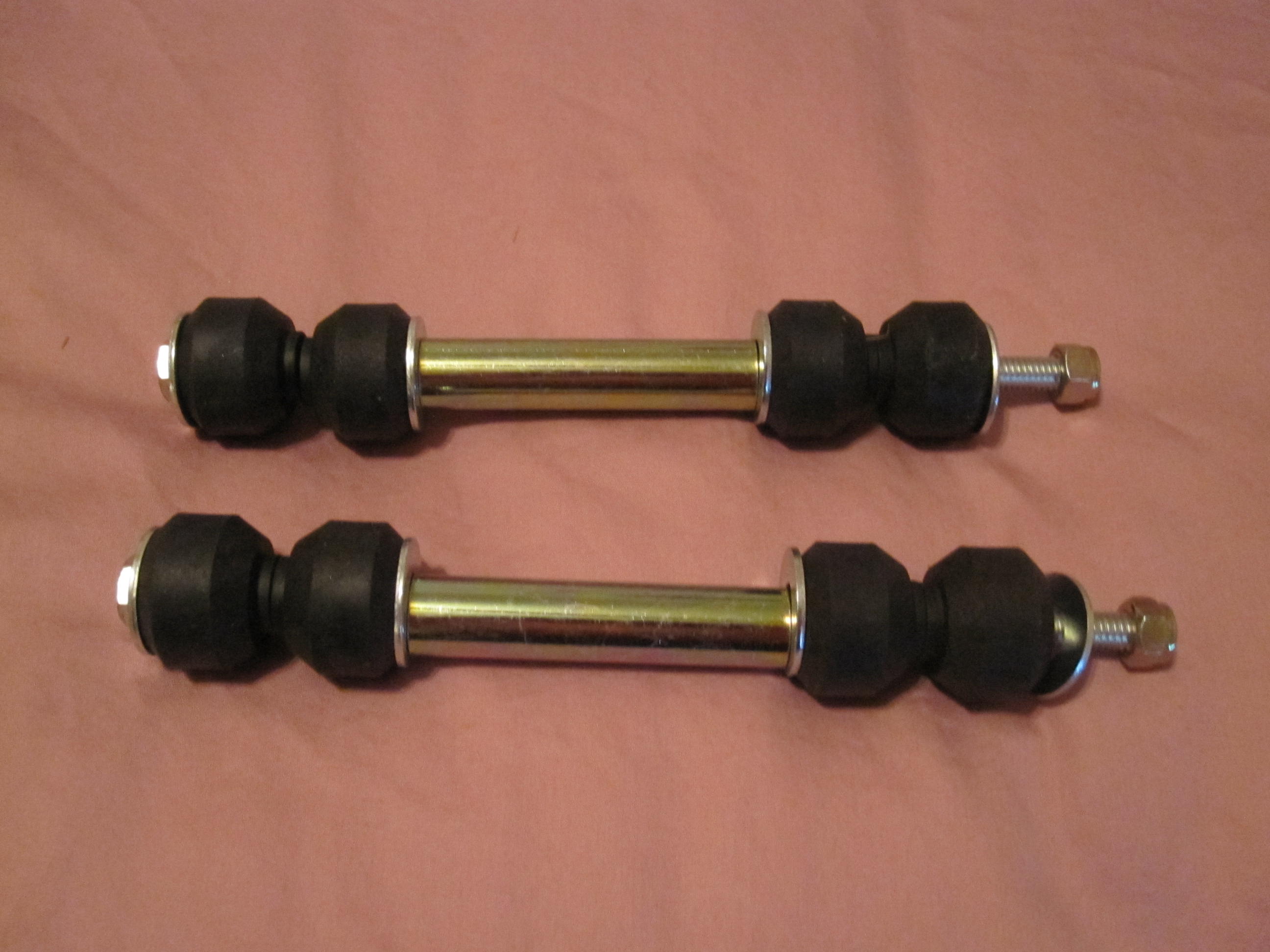

I used all the ADDCO items, links too; comes as a total kit. Everything was great.
Orig. links will not work with the poly bushings; would have to be cut in half.

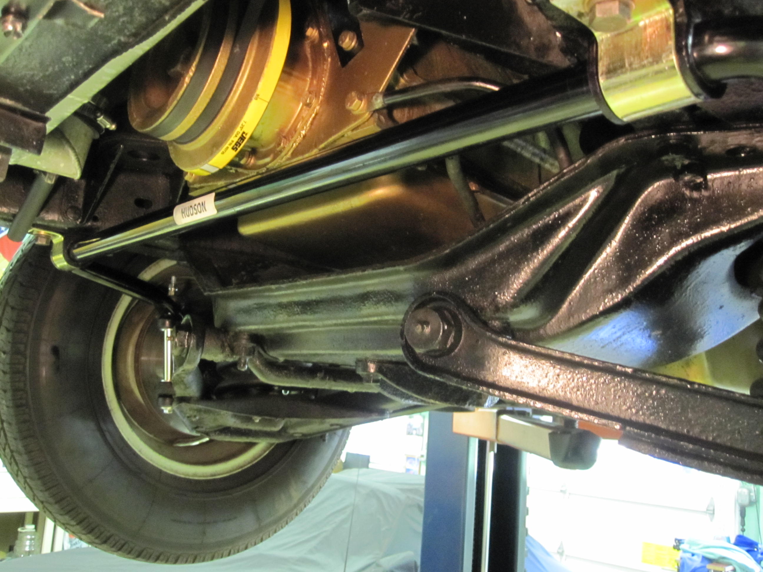

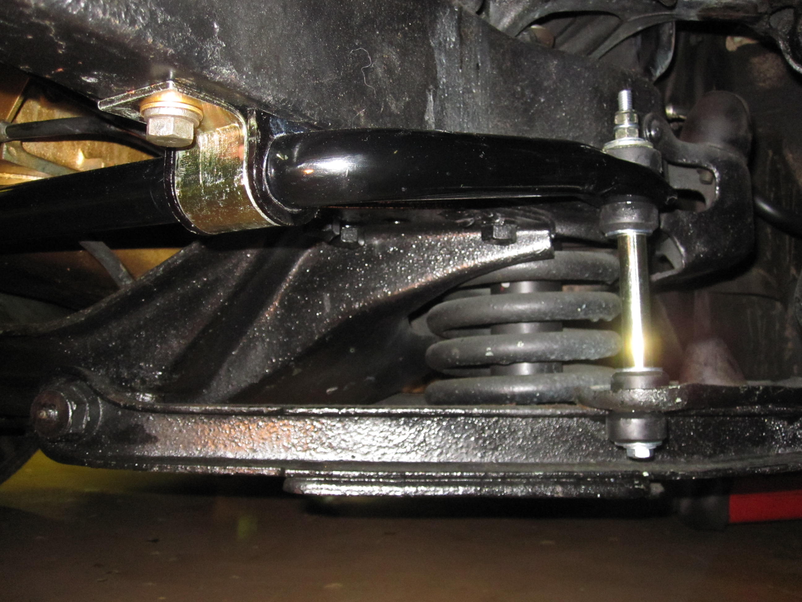

ADDCO 1.125” bar & links installed. Replaces stock 3/4” bar & links. Cross section area of new bar is 2.25 times area of stock bar.
Second photo is with wheels totally down; bar basically parallel with surface the way it should be.
Fun to drive now !!!!!!0 -

Looking good. The HUDSON sticker is a nice touch. Makes it more personal.
I had a long telephone conversation last night with Dan Maupin. He is very impressed with how much better his Hudson handles now with the new 1 1/8" anti-sway bar. I hope to receive mine soon.

NOTE: Buy 3/8" grade 8 bolts and new metal locking nuts; use orig Hudson cupped washers, the ADDCO sleeve/spacer & bushings. The spacer & bushings are all you should be using from ADDCO. I just don't like the 5/16" bolts. Orig. were 3/8".
