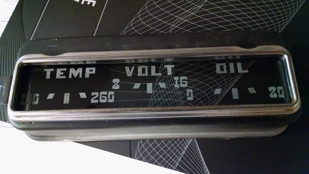

Just got my glass for my three gauge center assy I am working on -
Laser engraved with a little finish work with a sandblaster.

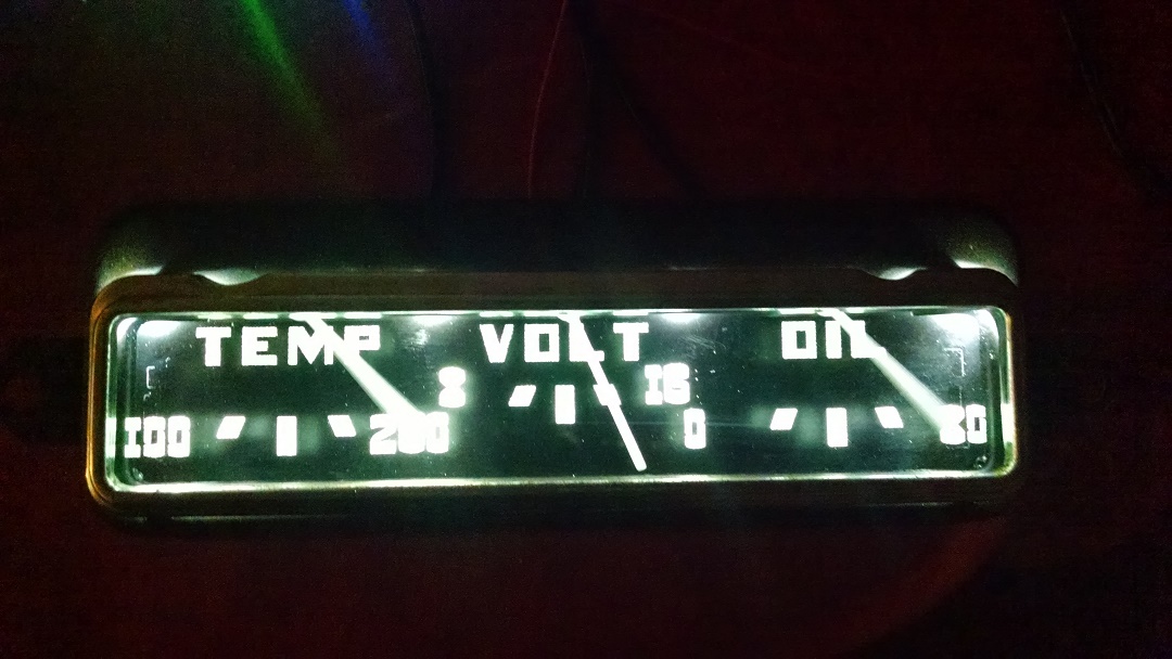

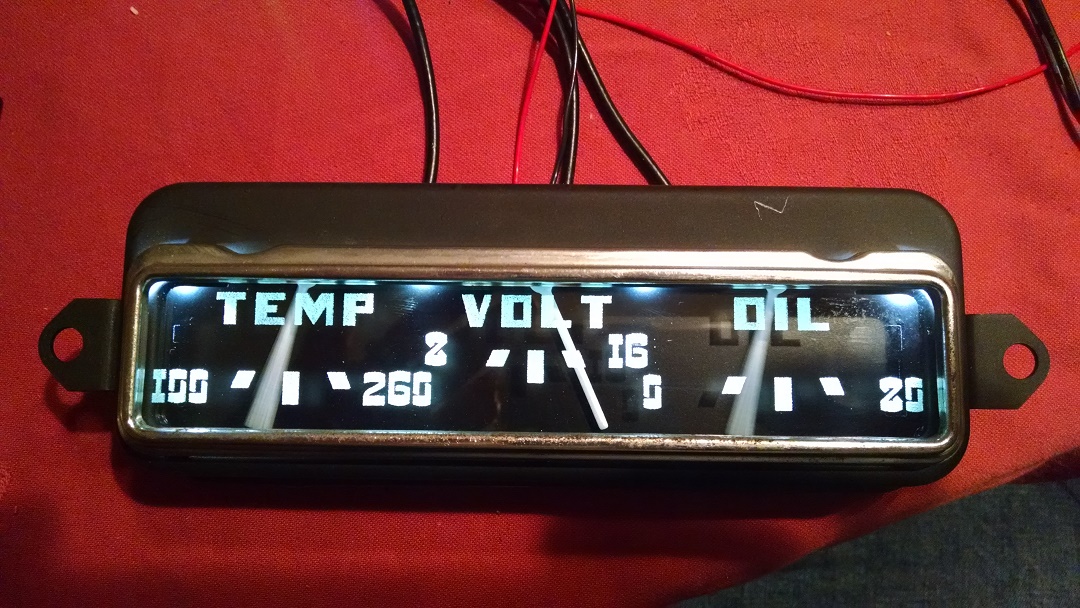

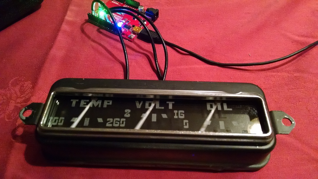

Needles and stepper motors installed. Connected to my control board running a simple sweep program.

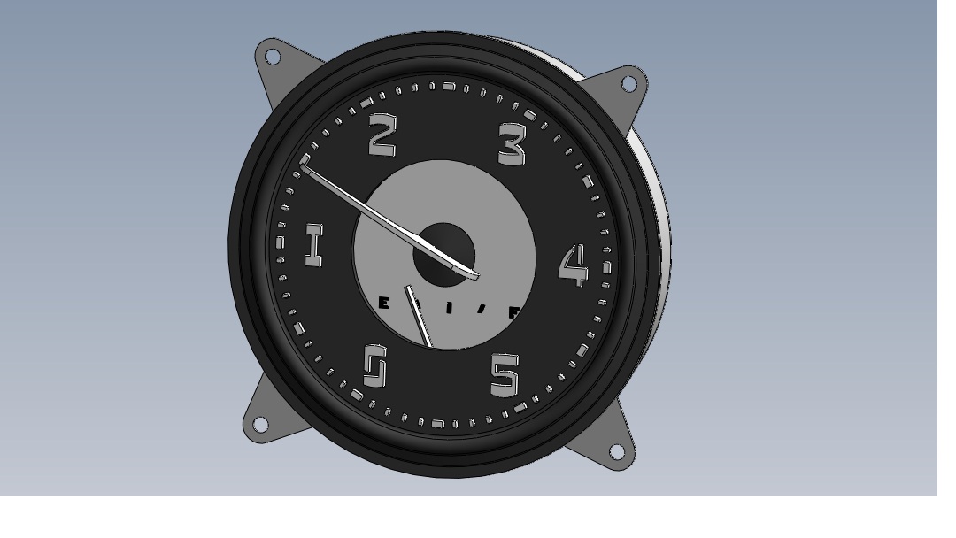

Ken, the fuel gauge will be combined with the tach that replaces the clock.Chris, the engraver did do some finish work by hand with a his media blaster. Evened out the texture.0 -

My plans for the Tach and Fuel gauge. If I could find a source for concentric-dual movement stepper motors I would have it laid out just like the clock, with the 'hour-hand' the pointer for the fuel.
