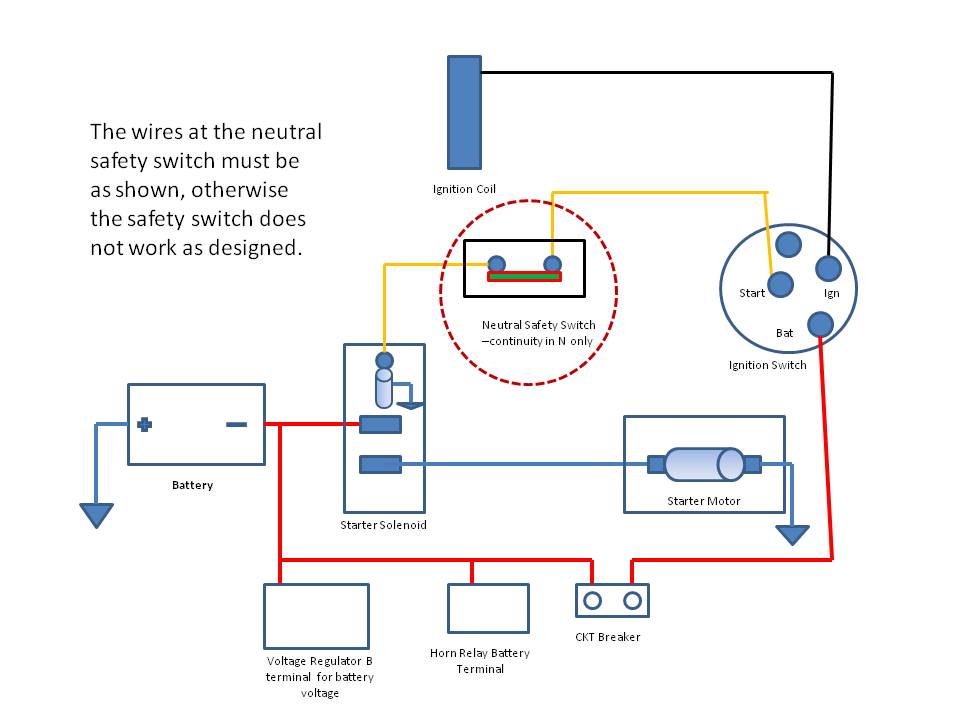

Oldfarmer:Thanks so much for your input. the following are the results of my tests.TEST:Mechanical adjustment of the neutral safety switch circuit #141.Neutral safety switch continuity testresult shifter in N = had continuityshifter in 4/3/lo/R = no continuity (open)2. Ign. Sw. "ON"/shifter in Nresults input term. of neutral switch = 6.45voutput term. of neutral switch = 6.45vST term of solenoid = 6.45v3. Ign. Sw. "OFF"/shifter in Nresults input term of neutral switch =6.45voutput term. of neutral switch = 6.45vST term. of solenoid = 6.45v4. Ign. Sw. "ON"/shifter in 4/3/lo/Rresults input term. of neutral switch = 0voutput term. of neutral switch = 6.46vST term. of solenoid = 6.46v5. Ign. Sw. "OFF"/shifter in 4/3/lo/Rresults input term. of neutral switch = 0voutput term. of neutral switch = 6.45vST term of solenoid = 6.46vbecause these were not the results you expected I did not continue to the testing of the starter solenoid.Your prognosis????regardsJ0
After reviewing your readings, I believe you have the wires at the Neutral Safety Switch reversed. Your readings indicate that the output 6 volts from the start terminal of the ignition switch is connected to the output terminal of the neutral safety switch. See the attached diagram0
Oldfarmer:I don't see any markings on the safety switch connections so I just switch the connection as you suggested & the results were exactly the same as before with regard to the voltage at each connection. I do notice a difference in your wiring diagram (real pretty by the way) & the diagram in the manual. You show the hot lead from the horn relay going to one side of the circuit breaker & the hot lead to the ignition switch connected to the opposite side of the circuit breaker. My manual shows both leads connected to the "B" side of the circuit breaker.regardsJ0
Jay I reviewed the other posts. If the solenoid is indeed an isolated base type it is incorrect and you need to find a grounded base type to fix the problem. As I said call if needed.
