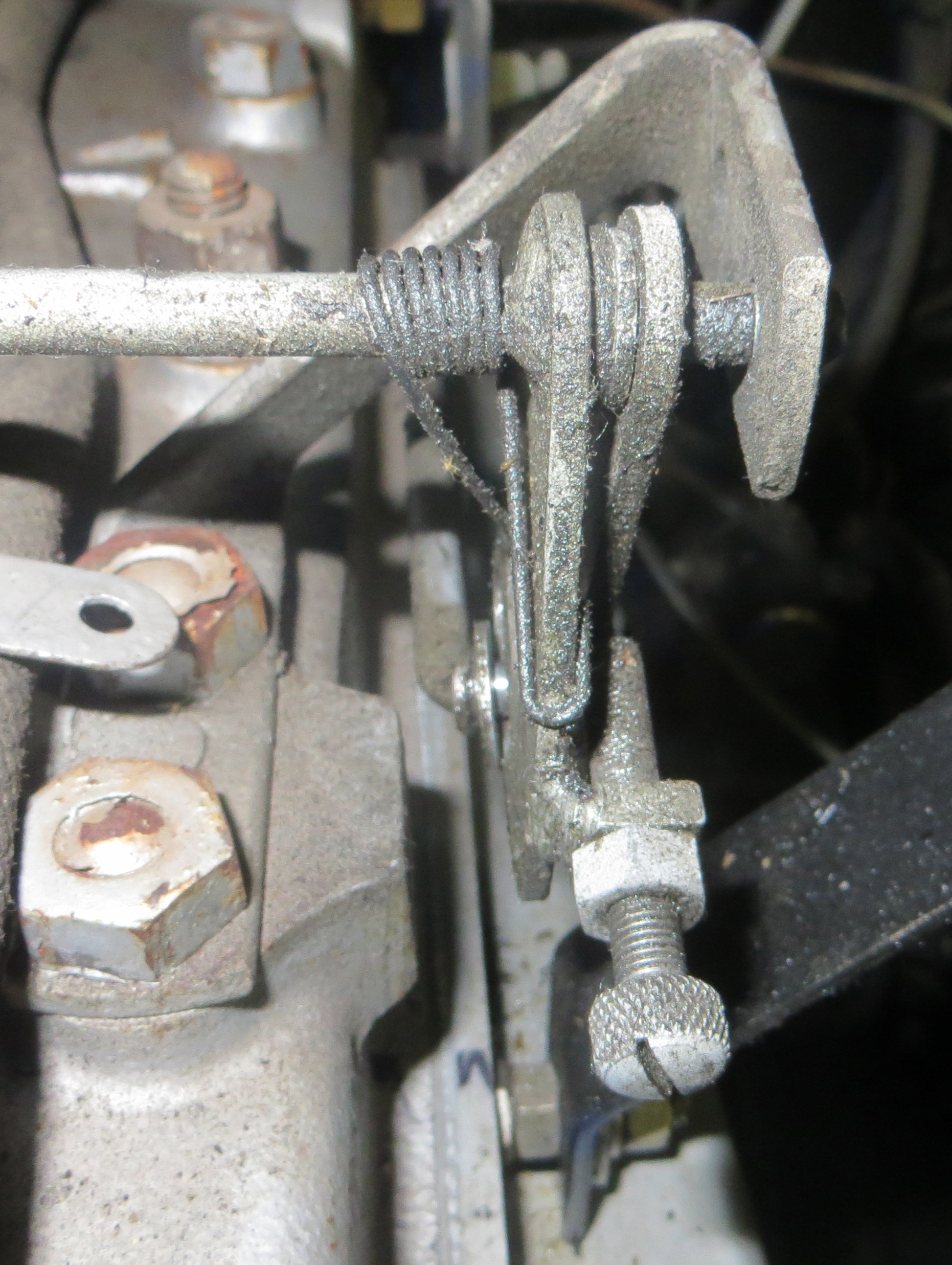

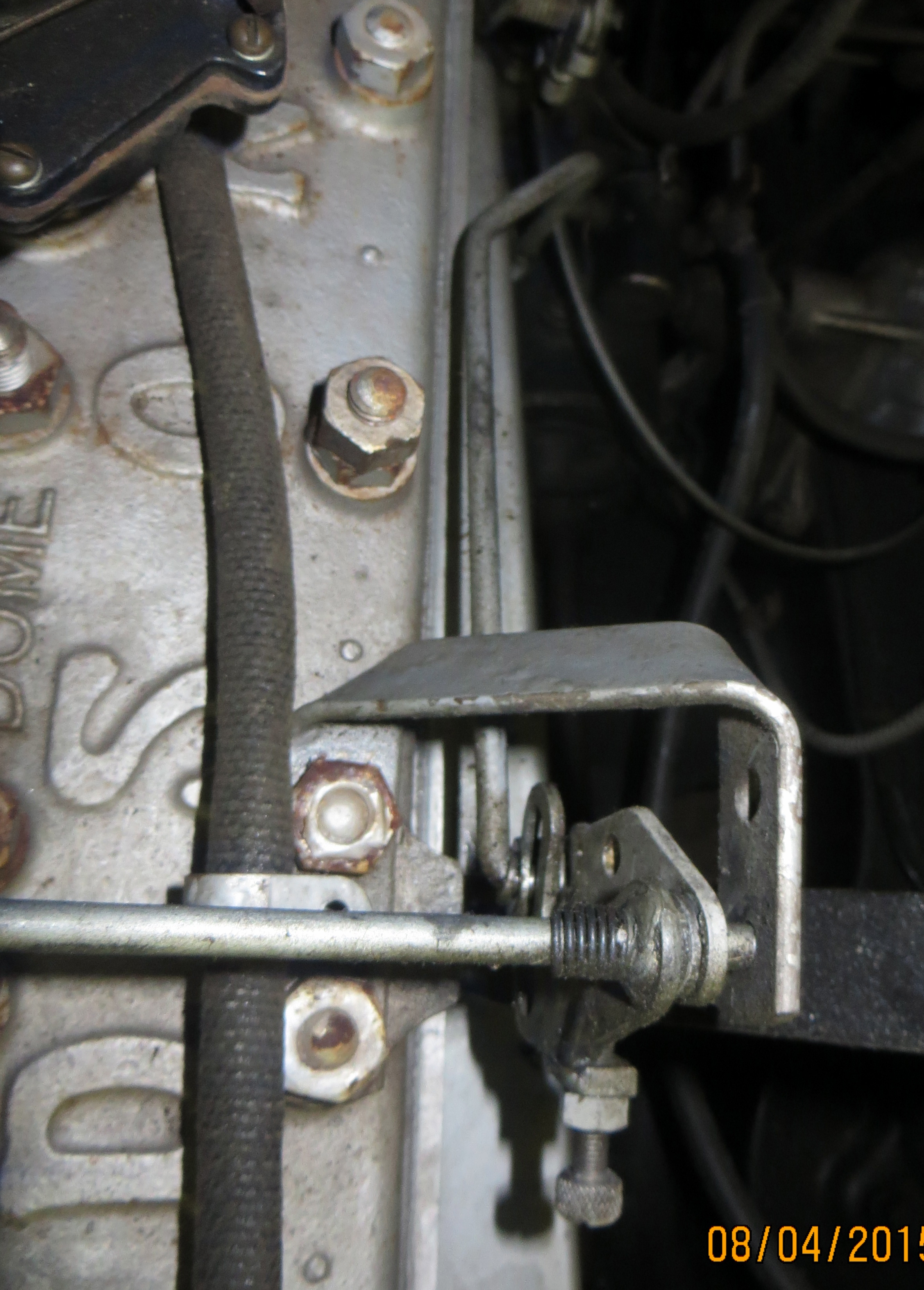

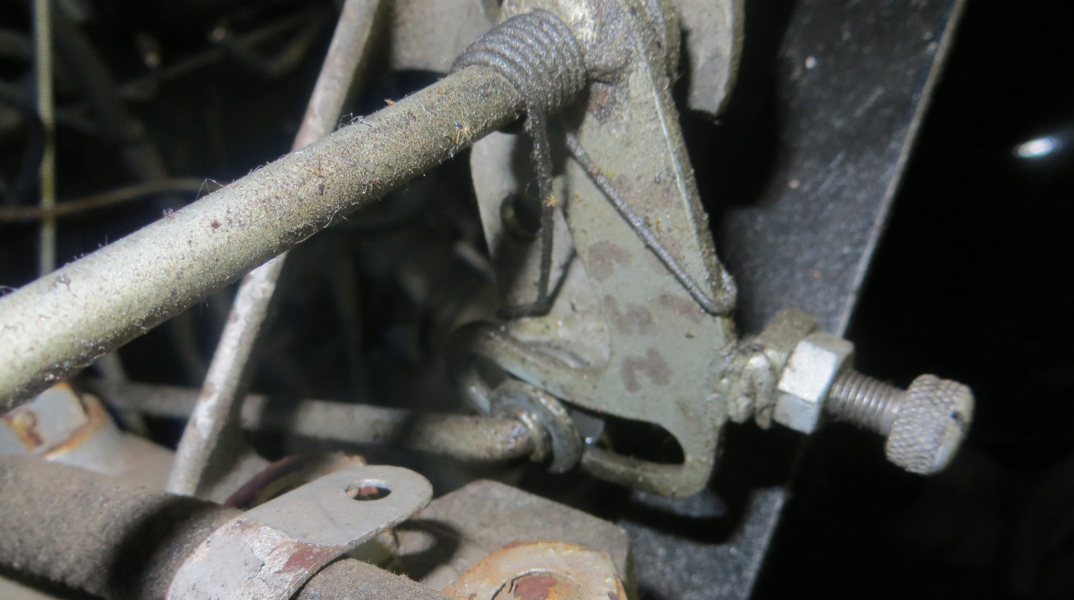

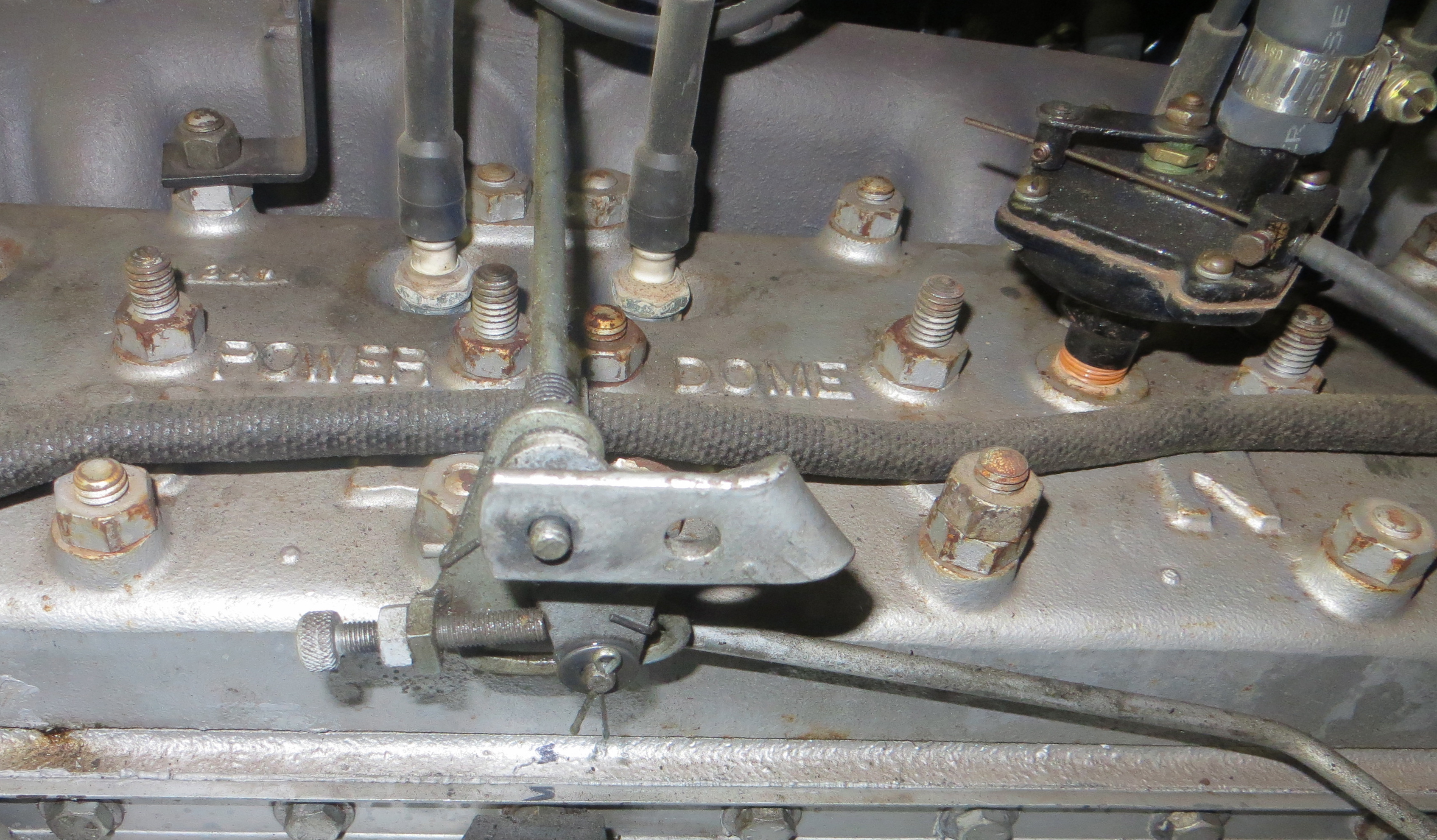

Could anyone post a picture of the throttle linkage for a stepdown 8. Mine has been welded and put back together a few times and I am trying to determine how it is supposed to look. I am looking for a picture of the linkage bolted to the head that pivots converting the fore/aft of the pedal to the rotation for the carb. Any help would be appreciated.
Will take pics 2day and post0
Thank you, that is exactly what I needed.0
Glad they were a help.0
My 52-8 has automatic and a different linkage. If you would like a pic of the later linkage,, let me know
